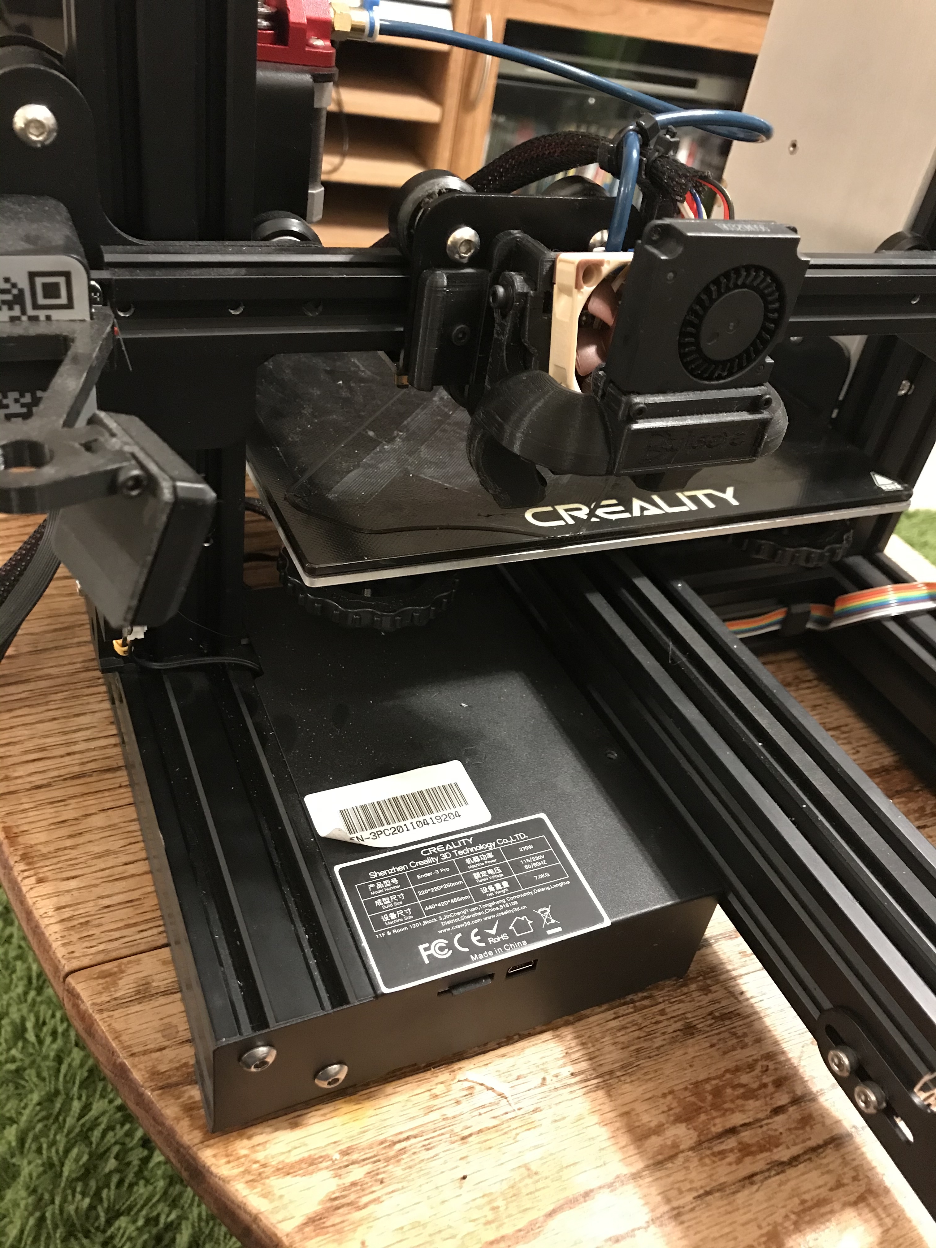

I’ve been playing with my new 3D printer for probably 48 straight hours now.
I can see myself becoming completely obsessed with this.
But first things first I need to work on the noise.
I’m already driving the wife crazy having this thing running 24 hours a day.
First thing I’m going to do is put some vibration dampeners on. Probably only on x and y so might have extras for someone :man_shrugging:

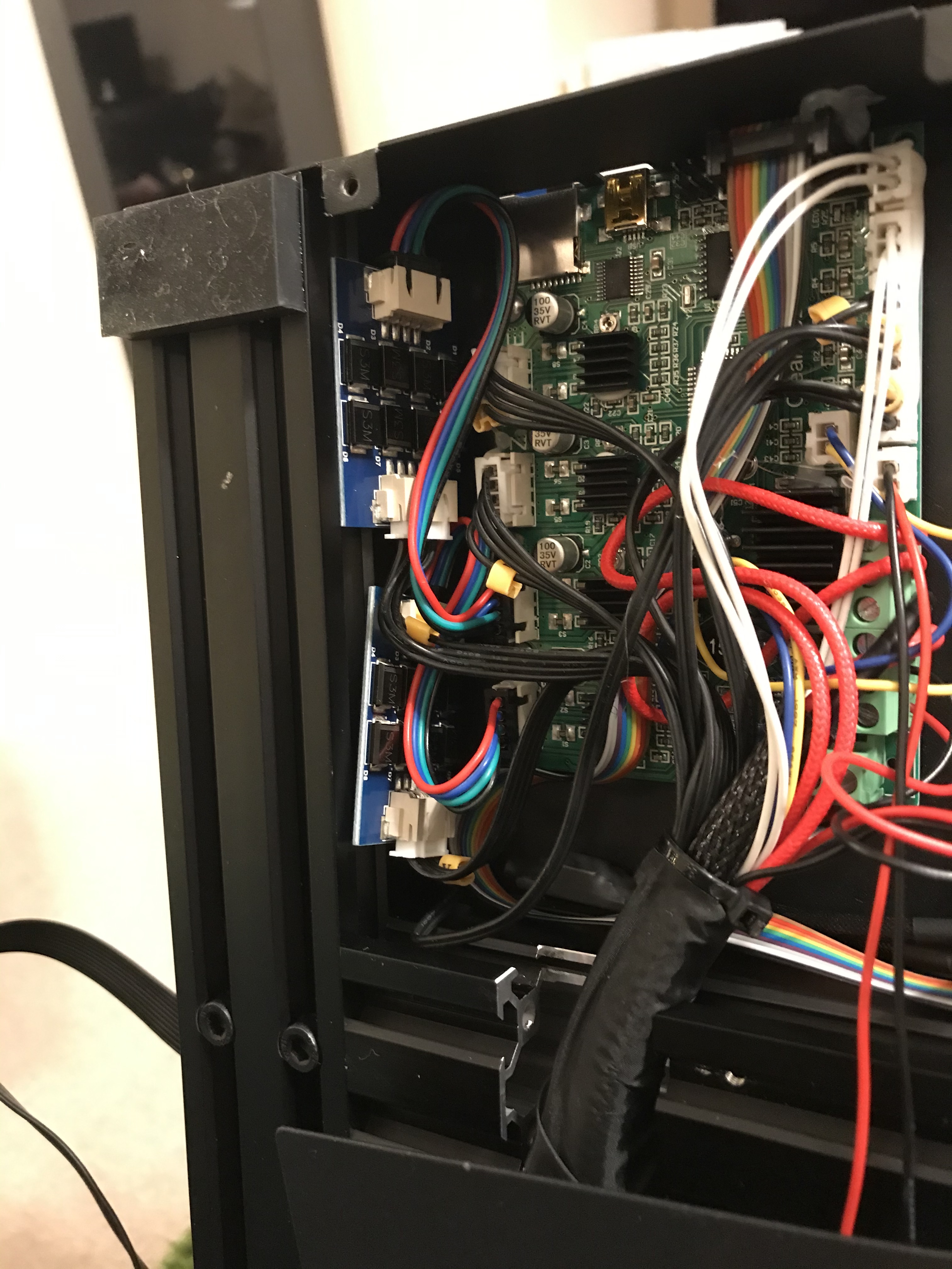

Literally just doing that now on a Ender 3
Steeper motor dampener makes a big difrance but you need new hardware as well.

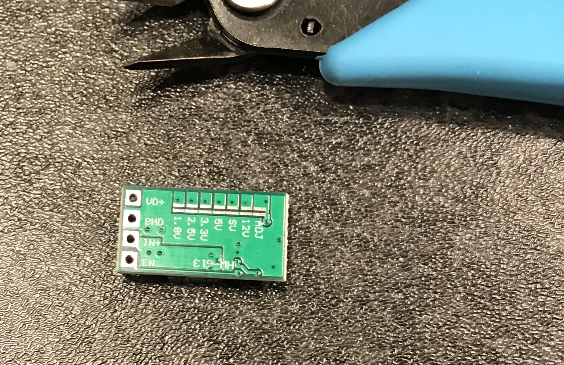

A Ender 3 is 24v the fans you linked only come in 5 or 12v so you will need a buck converter literally installing one now.
Witch come to my question
I think not a electronics persion so can some one confirm or correct me.
V0+ Is Load +
eND Is Load -
1N+ is Supply +
EN is Supply -
Wait. What is this?
@Skunk, resting the printer over soft foam didn’t help much? BTW, you should get a small $5 tent from Ikea to put the printer in. You have small kids in the house and it’s not good to have printer running in the same space all the time. PLA is fairly benign but still it produces small particles that goes into the lungs and into the body.
It’s not like it’s rattling or anyting.
You can just hear the fans and the motors to the entire apartment.

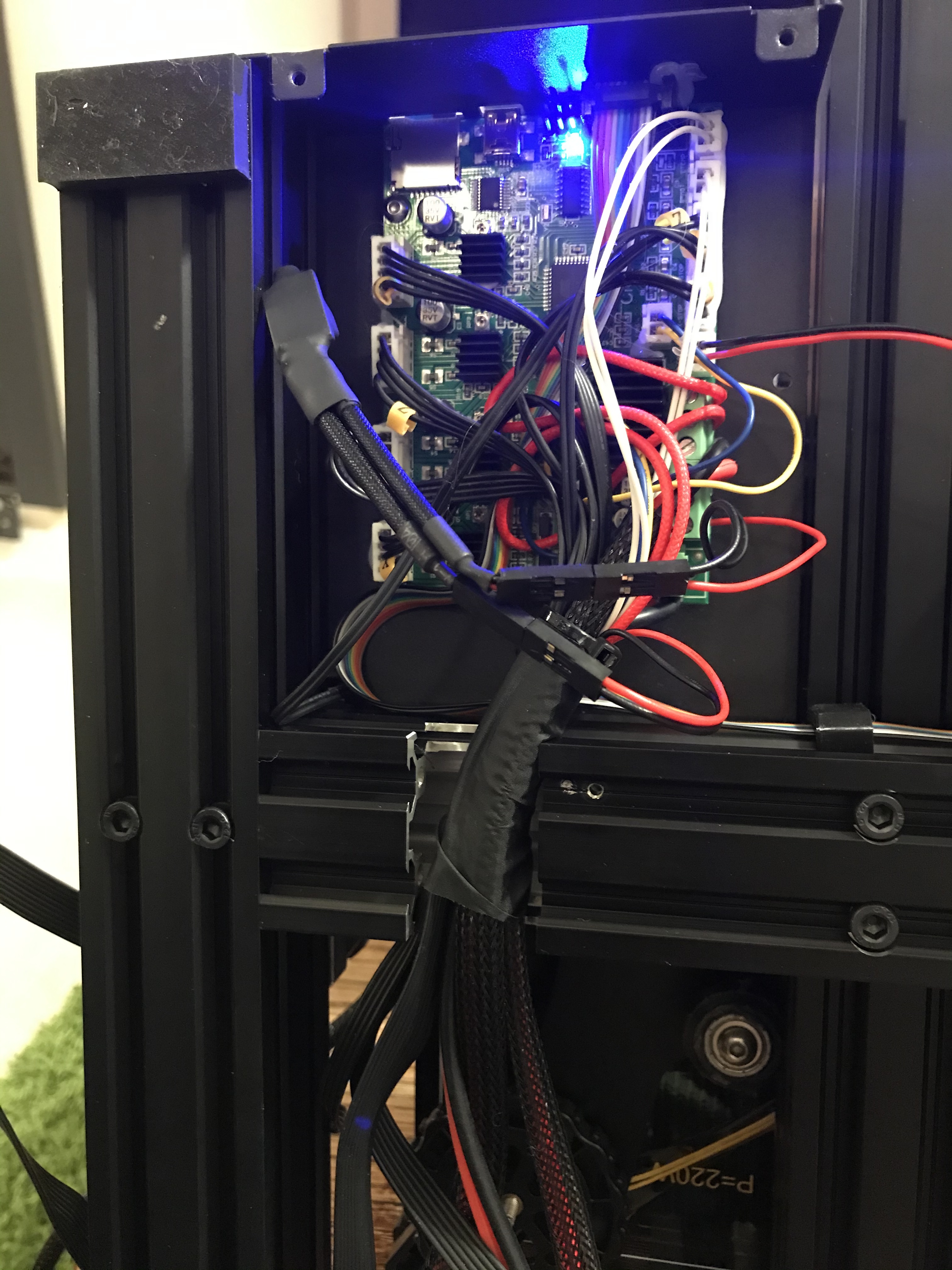

I have no idea what EN is but didn’t work As a supply neg. so commend out the eNG with I thing is suppose to say GND from a bad China translation. The 5v rail I gave up trying to solder short the solder pads on the back Of the buck converter and set the variable dial to 5V instead b4 heat shrinking over it all and conected it all with DuPon connectors in case I ever want to remove the 5Vfan and go back to the 24V

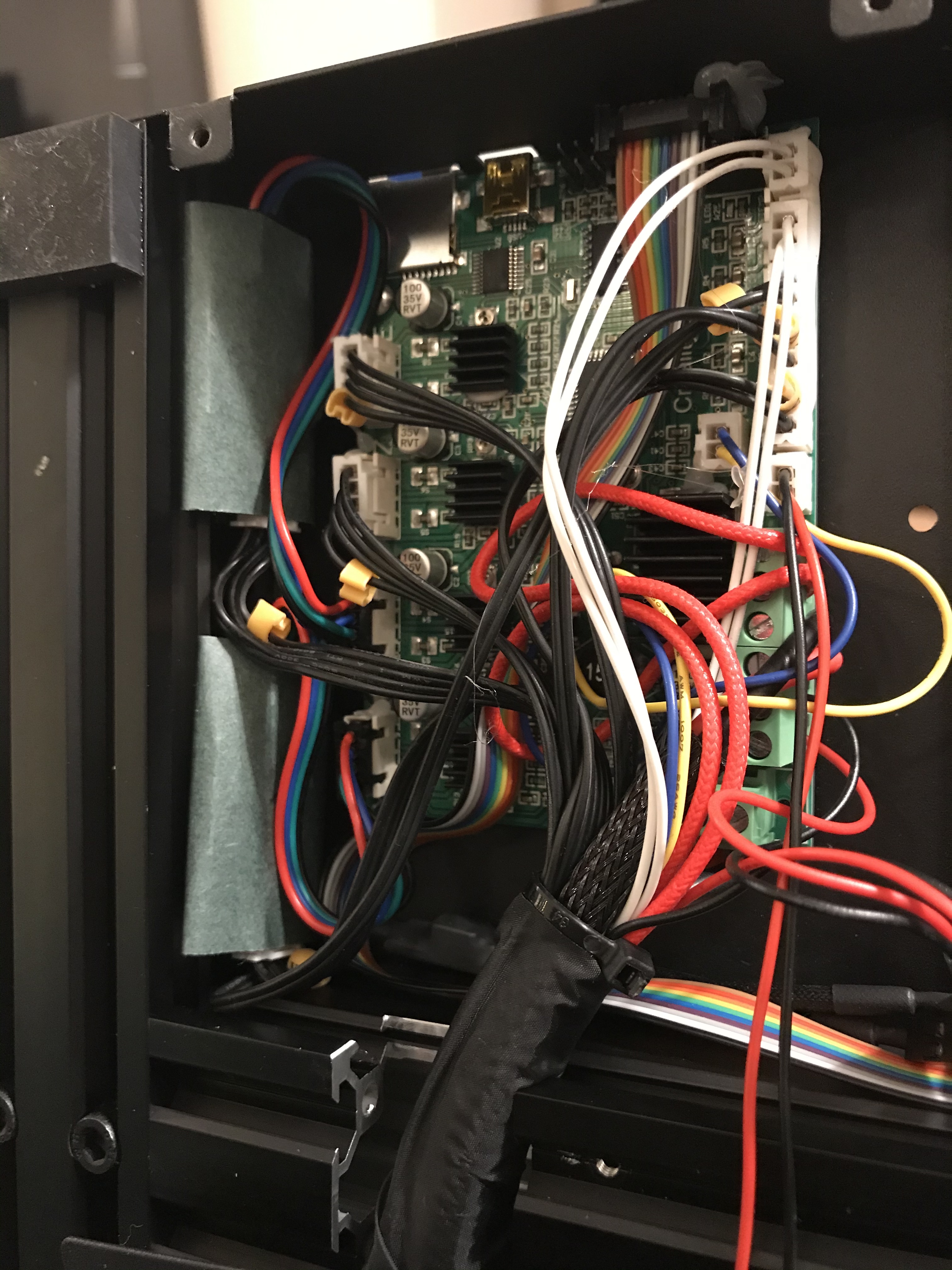

Put some smothers on the x and y axis with some fish paper as didn’t have any heat shrink big enough to go over them and don’t like the idea of them in there louse with out some thing over them.

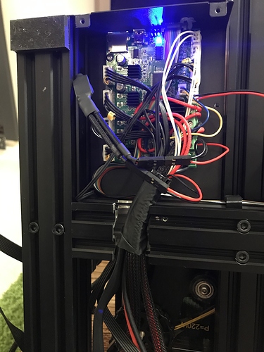

Upgraded the feeder to mettle as the plastics one was wearing through as well as a caption tube.

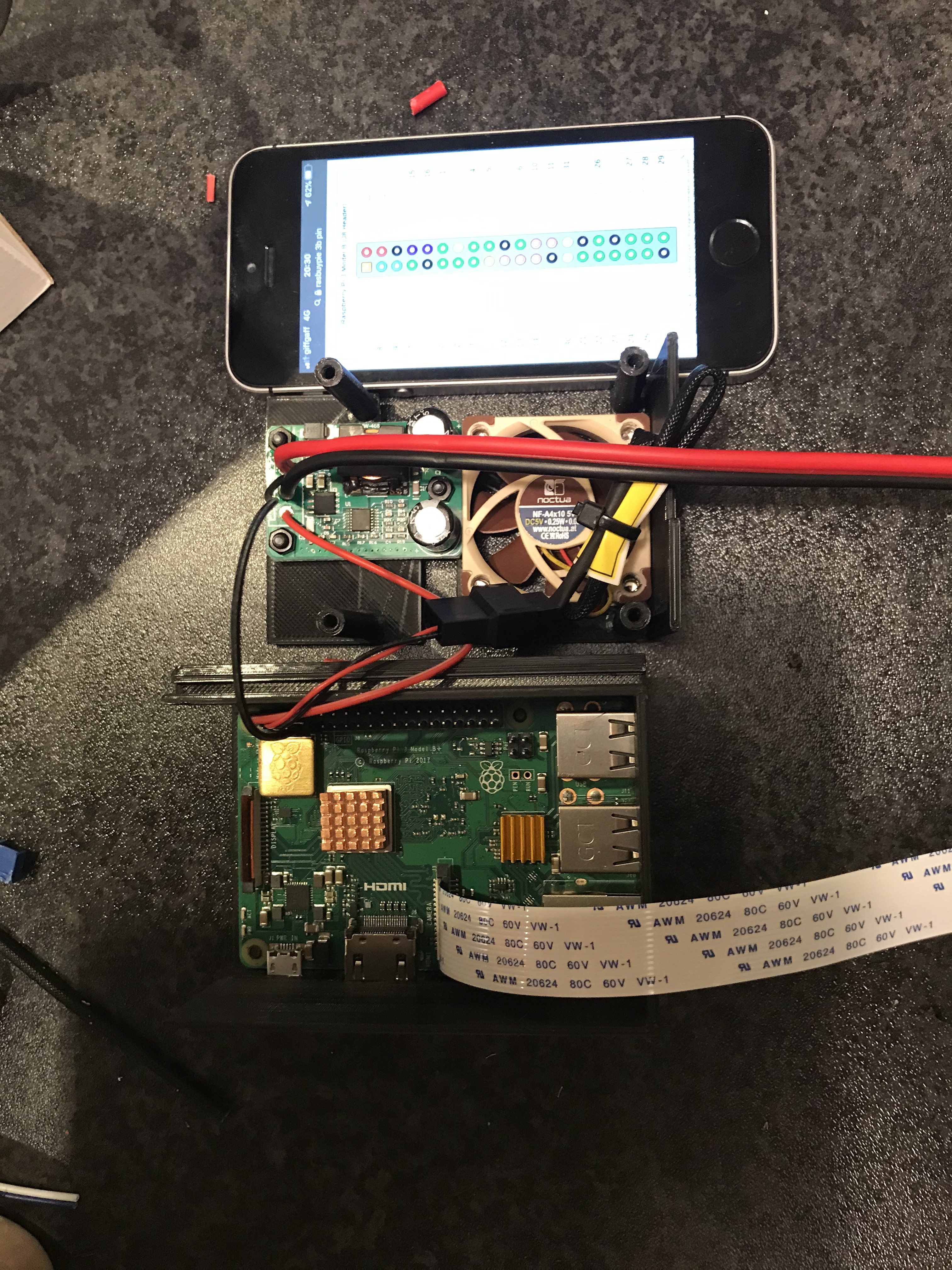

buck converter on the rasbury pie to power it off the printer power supply. heatsinks and fan to cool it down as it was hiting thermal and under clocking it’s self and mounted it in case to mount on the printer.
I’m confused how mount the steeper motor dampeners as both the x and y axles will be to short.
Need a longer pie camp ribbon cable measured it 6 times and it’s still the wrong length.
Forgot to swop the springs out for stiffer ones Then try to reload the filament

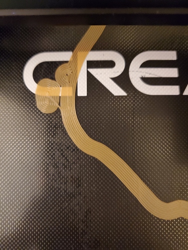

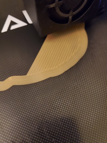

The estep calibration helped a lot with the line thickness issue. I had so many Christmas orders that I haven’t been able to sneak in an xyz cube to compare apples to apples. Left the day after christmas to go on a trip.
This is the only photo I have after estep calibration, im thinking that back left corner of the bed was a bit low.
Bottom layer looked alright otherwise.
I’ve been looking into that wipe setting after watching that exact video the other day. Coasting has been nice but I’ll still get a few artifacts on the outer wall. I will try that wipe setting out.

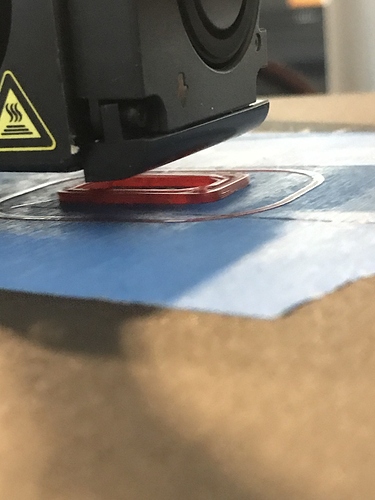

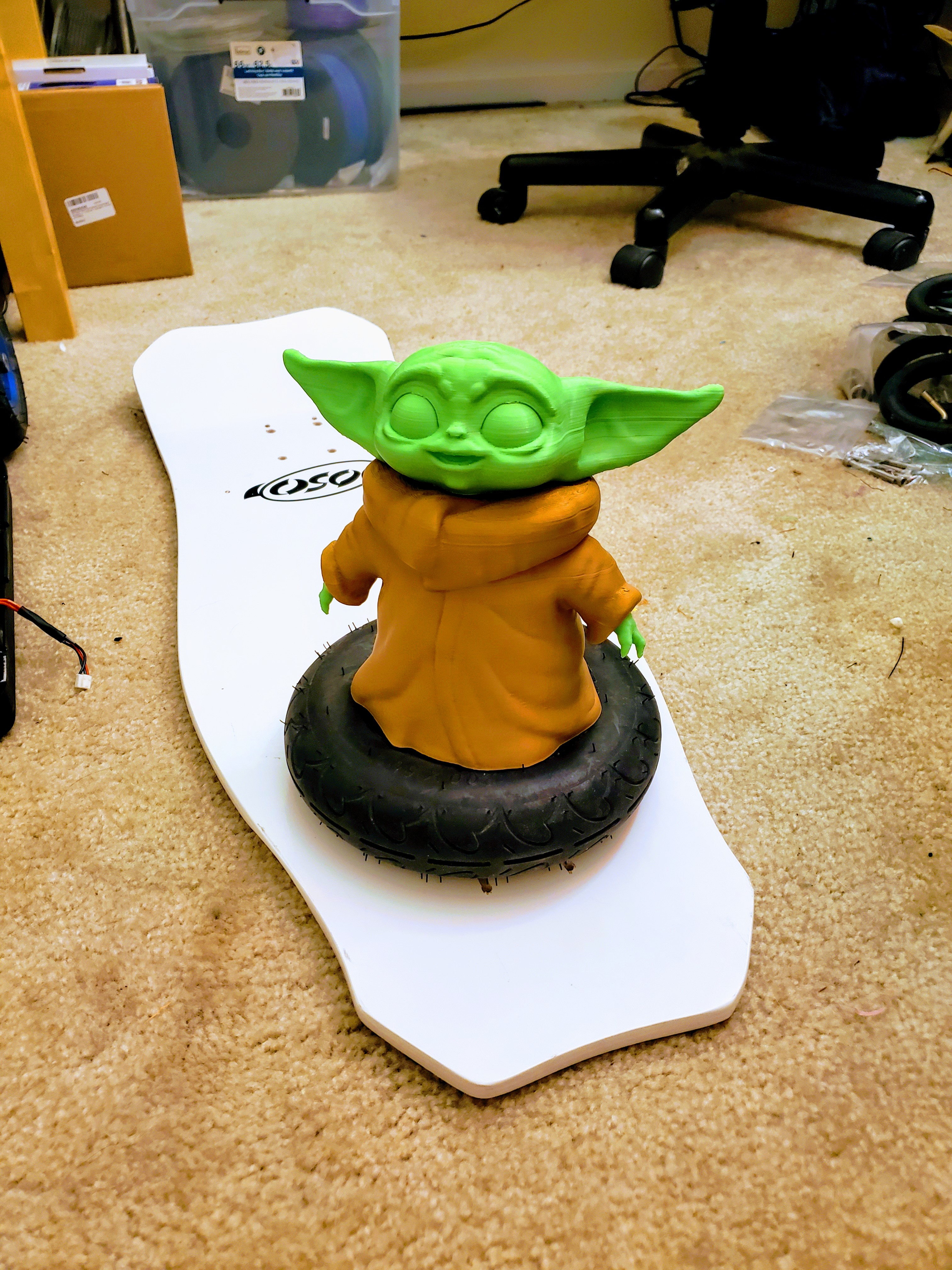

Last print was this guy
I was having issues with the test print of the dog on the ender 3 sd card it would retract a ton then I would have no filament for the first layer and it would take halfway through the second layer for the filament to catch up.
I used the chep leveling and square printing on thingiverse and decided f it and printing something usefull. Loop key handle
While this seems to be printing fine, I’m very curious about the retraction problem I had, anyone have that issue?
