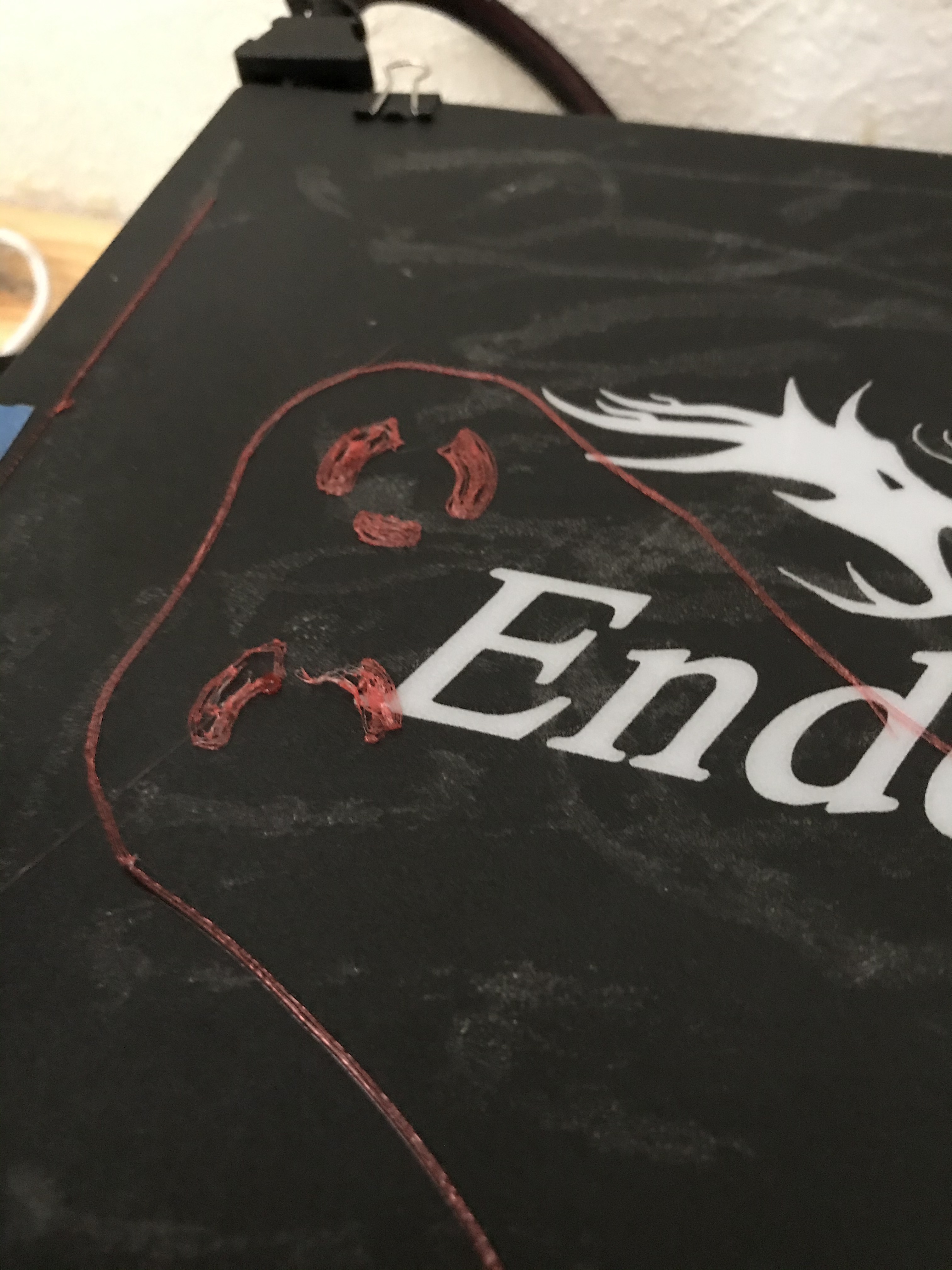

I tried to print the dog file from the SD card, when the machine started to print, if pulled back all of the filament halfway into the tube

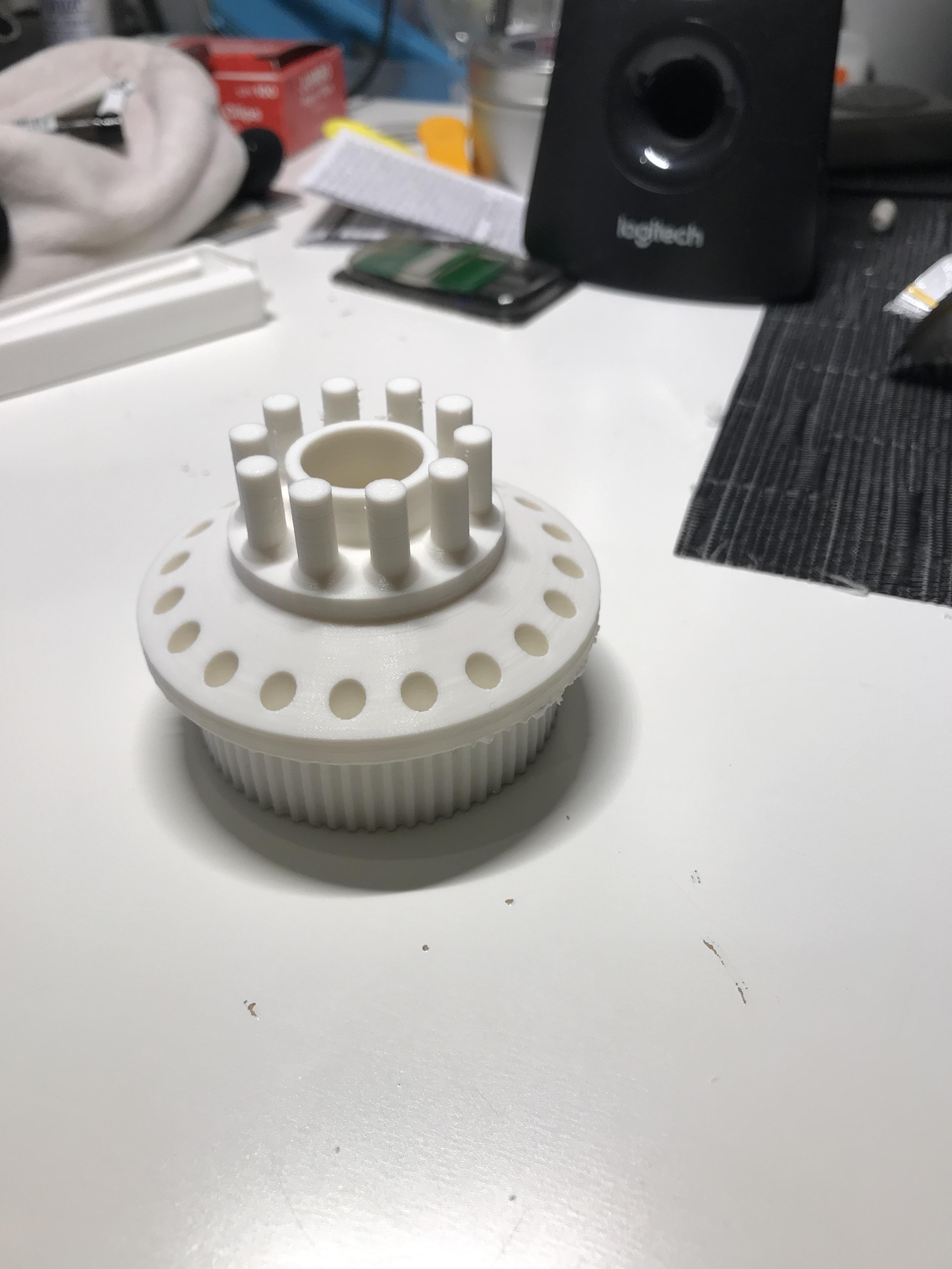

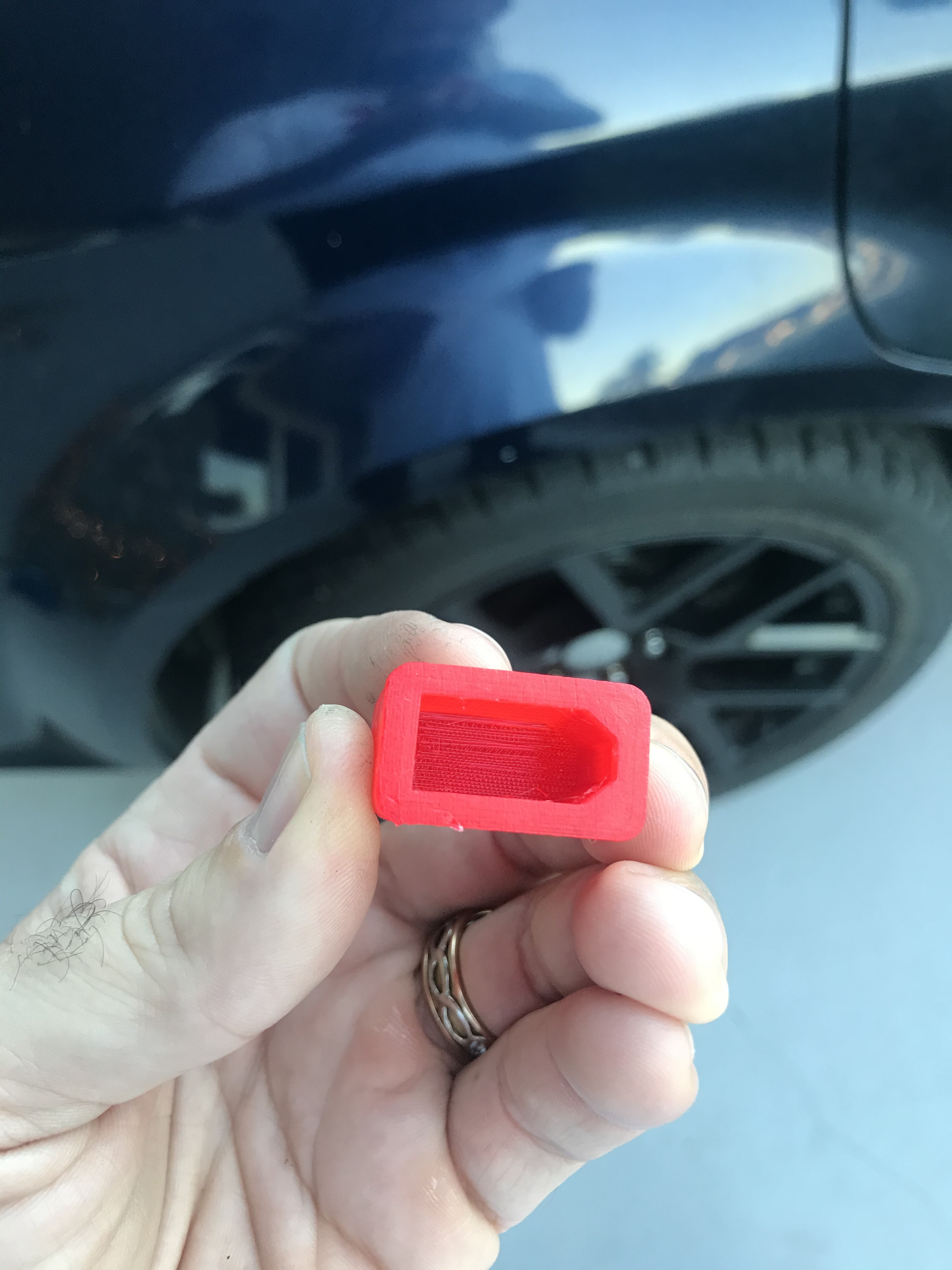

Made an extruder knob today,

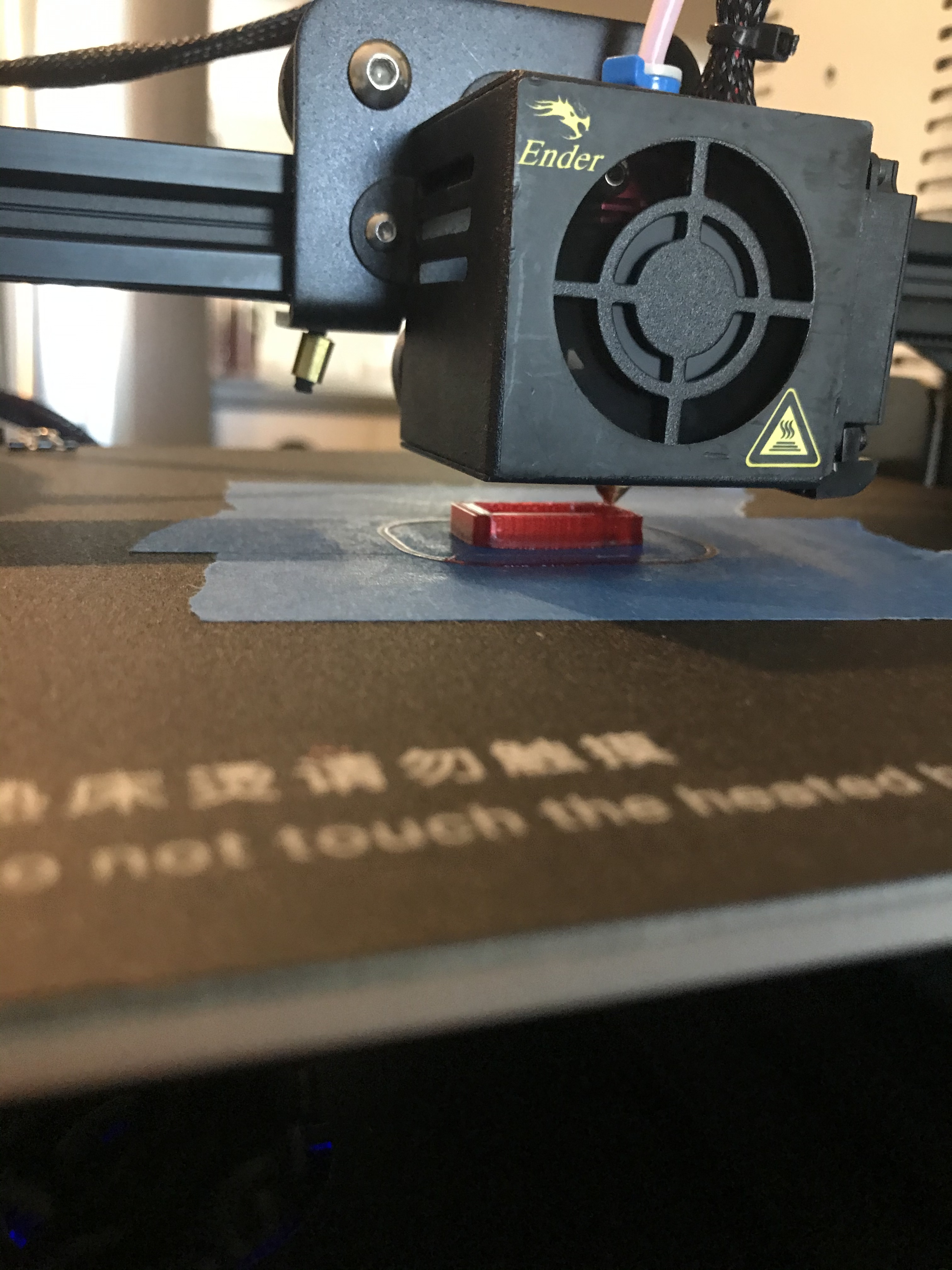

Looks like a layer shift and some stringing on the first couple layers. Suggestions?

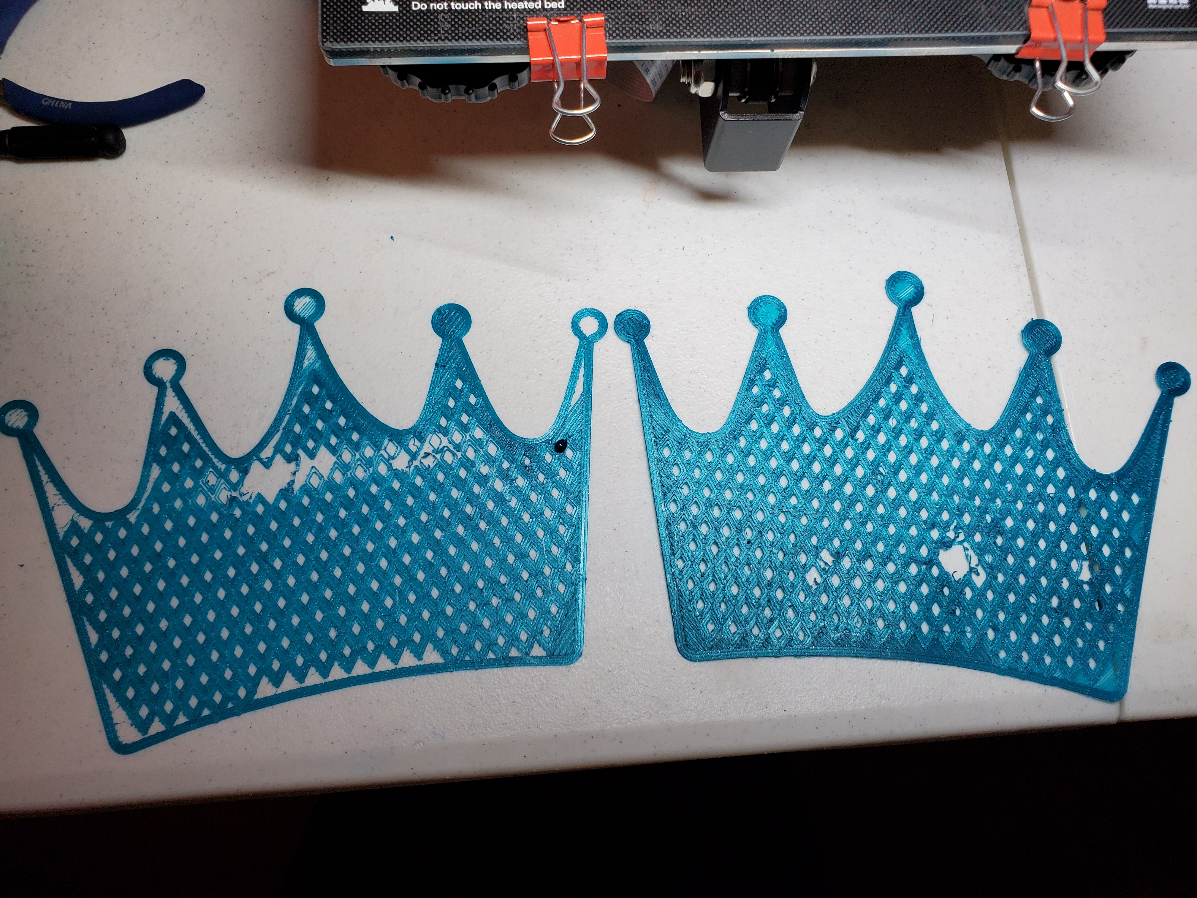

Tried to print this 5 times now. Never makes it through the first layer
Welcome to 3D printing. :slight_smile: I bought 3 spools of sunlu pla+ when it was on sale, and I cannot get it to stick to pei. Just before these, I was using whatever generic pla and had everything super dialed in. My slavemaster is demanding attention again…
I had issues with getting good prints because things didn’t stick to the bed and the fix that worked for me was getting a glass bed.
The knob and the loop key were very well stuck to the bed, I think on the knob the whole surface must have shifted. Now on the failed prints that I can not get stuck to the bed I’m going to try and slow it way way down, the petg seems to not do well under the small quick movement sections.

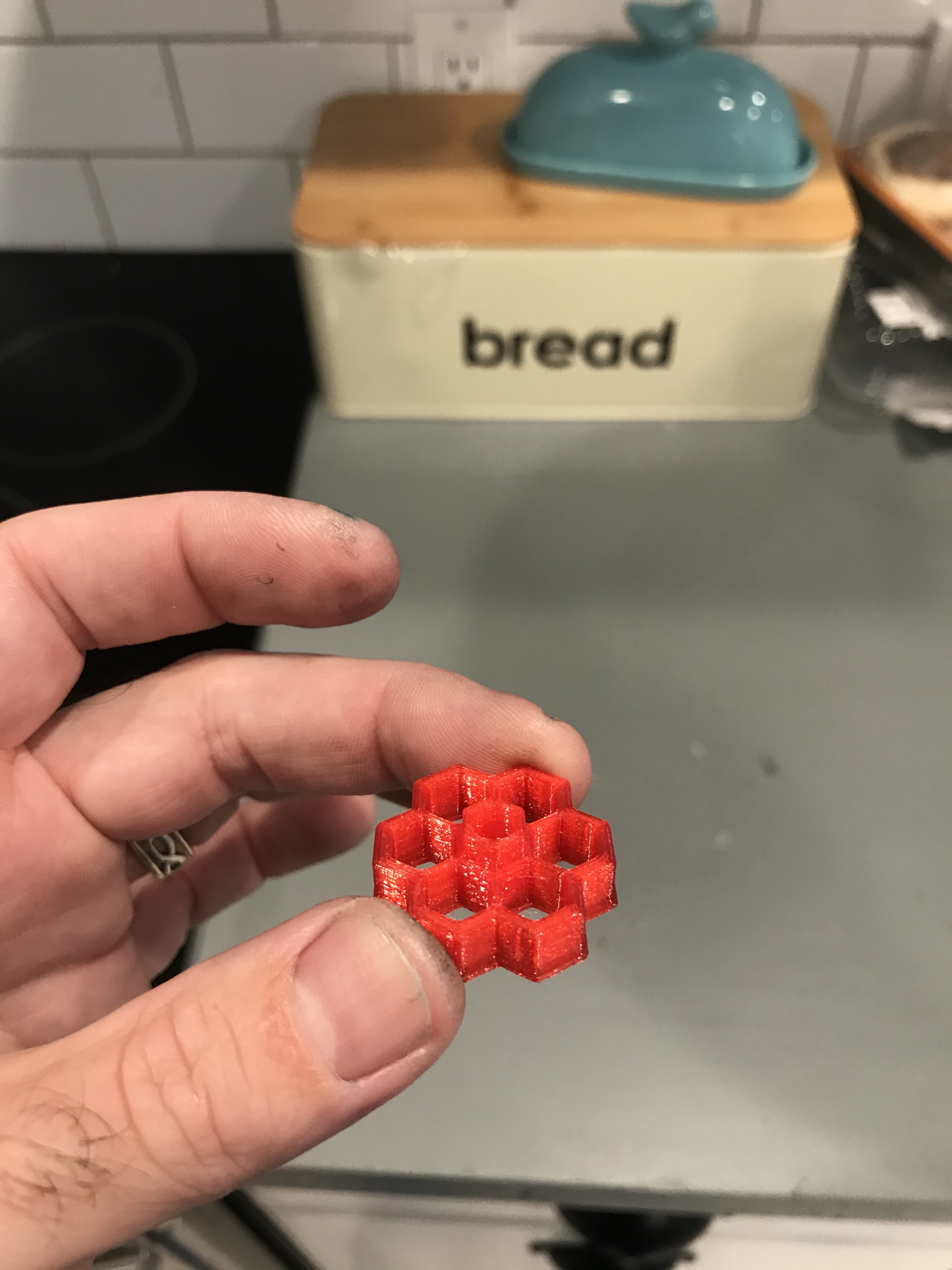

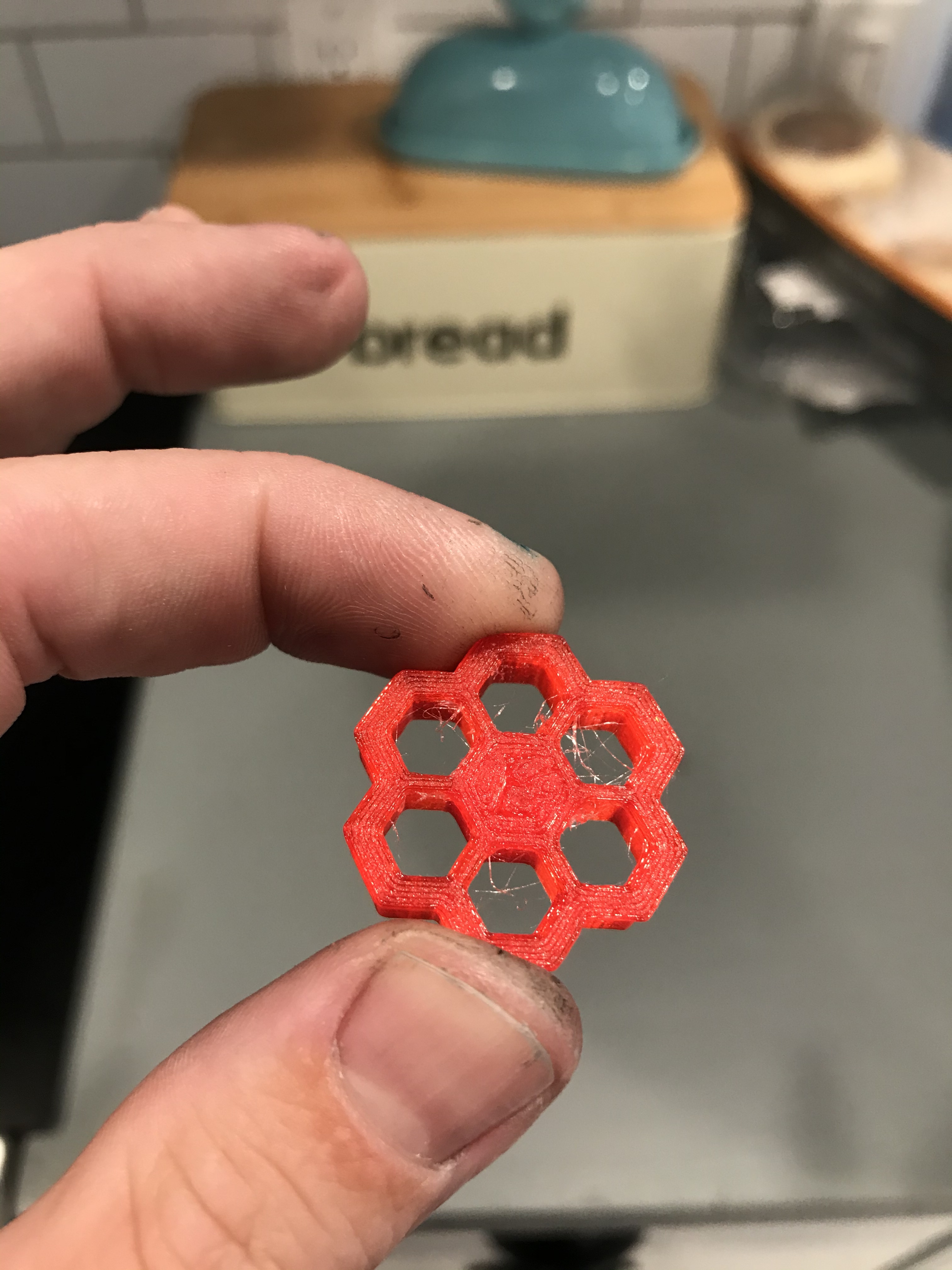

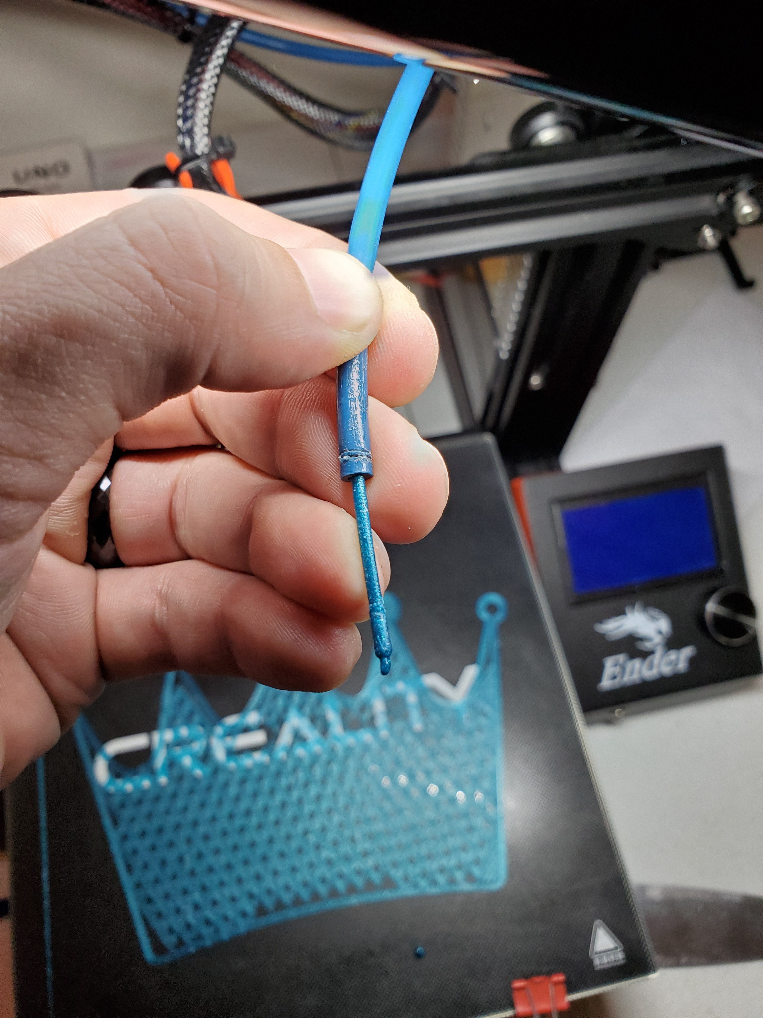

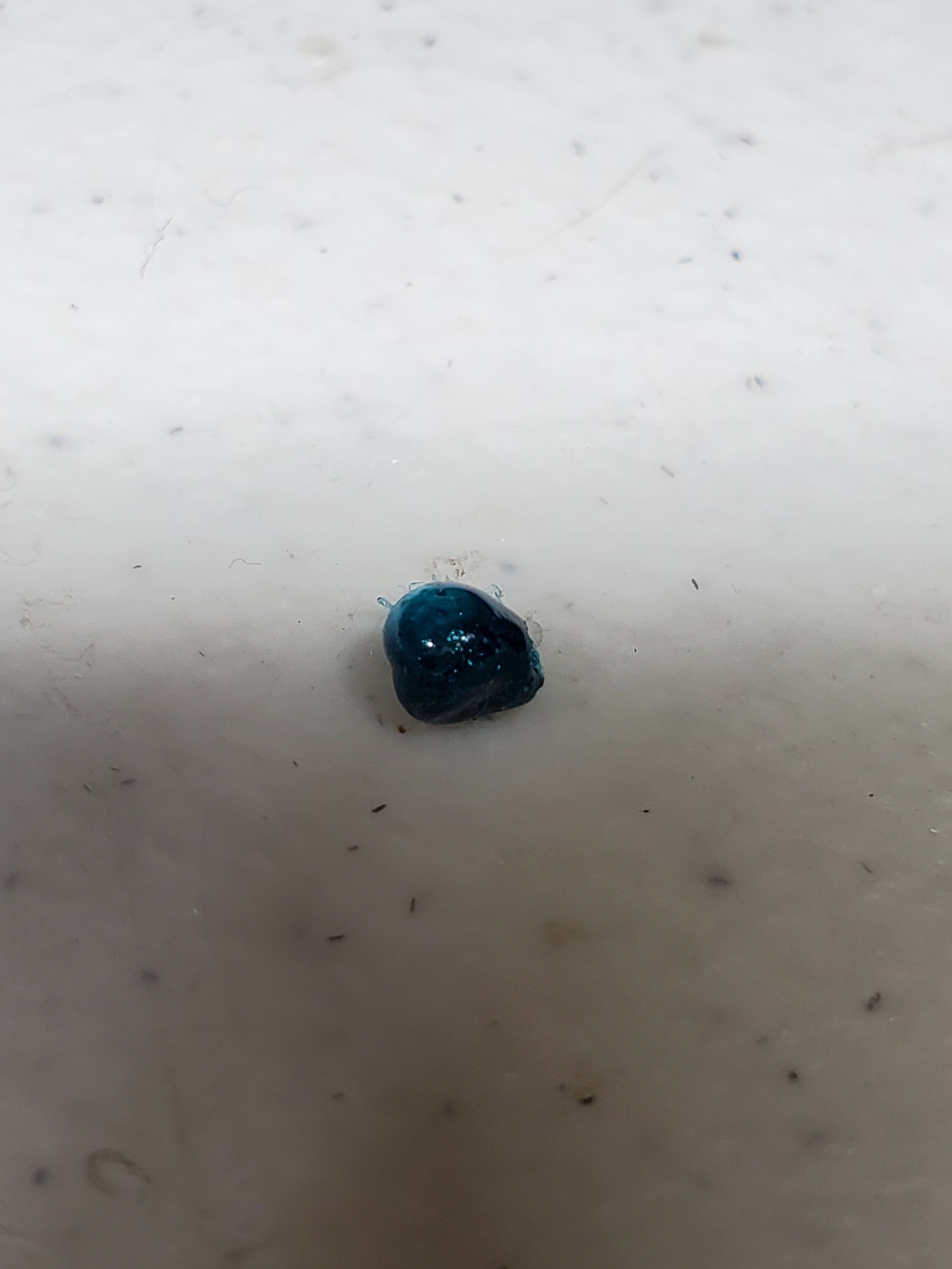

I’m having repeat failures with a specific color of glitter filament. It keeps clogging the hotend area to the point where I can’t heat up and force filament through.
Filament looks like it’s slowly underextruding the first layer:
Filament leaves a bubble after I disassemble ptfe tube going into hotend and force filament through (comes out fine when ptfe tube is out)
Rest of filament looks like there may be a gap on the hotend maybe?
Any help appreciated

All I can suggest is even bigger nozzle and making sure there is no gap between ptfe and hotend.
I haven’t worked with glitter filament yet, so don’t have much insight. I have a gold glitter PLA in vacuum seal just sitting there for a year.
Fair enough. I have a pink, gold, and silver glitter that print better from the same brand.
Any advice on printing faster or slower with troublesome filaments? Also do you prefer printing on the lower or higher end of the temp range?
