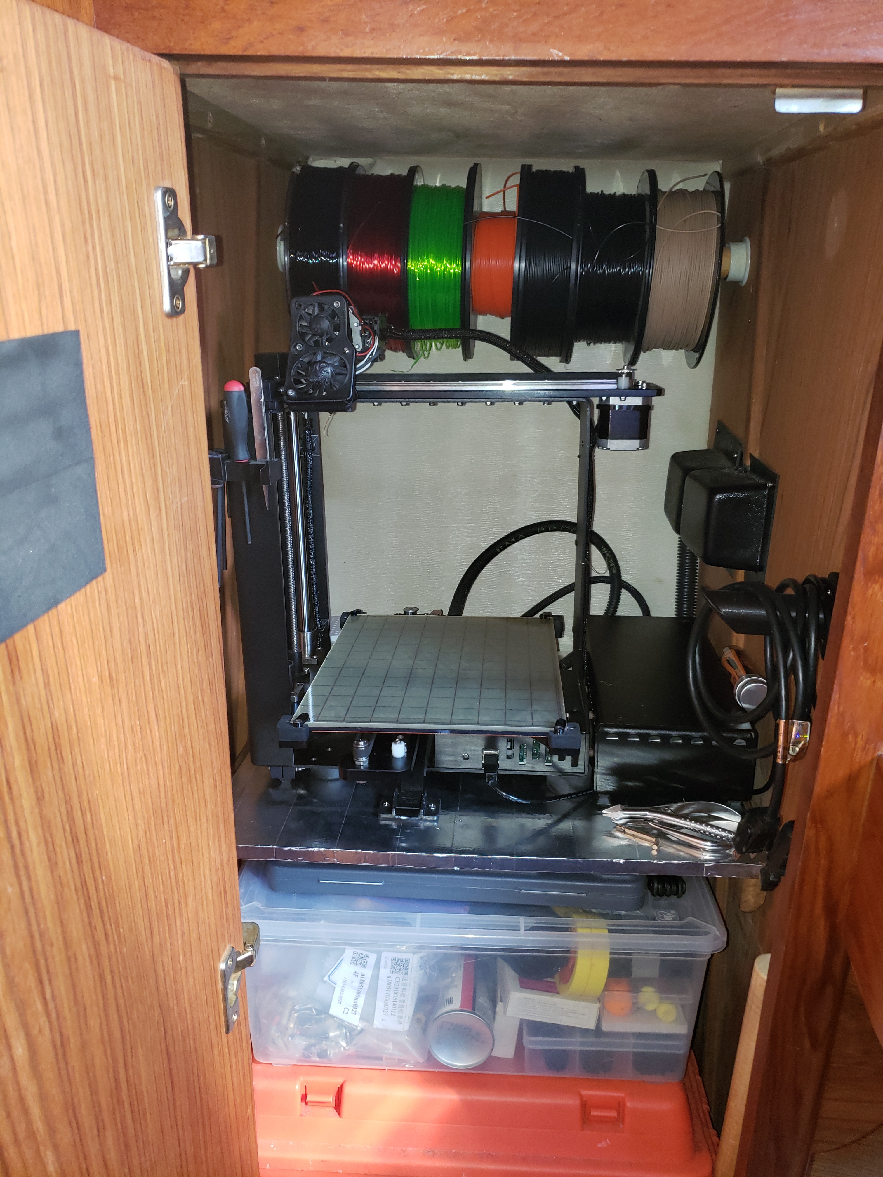

Using a Makergear M2E with a .5mm steel nozzle. It’s been pretty awesome so far. Prints everything I put in it. It was pricey considering some small issues that made me remake the way the bed is secured to the heat plate. I also purchased a printbite+ bed that’s made warping a thing of the past. In retrospect I should have probably bought a Prussia but the M2E is all metal and it prints while my boat is rocking without skipping a step. So I’m still happy in the end. I’m also pretty sure it’s getting close to paying for itself soon.
