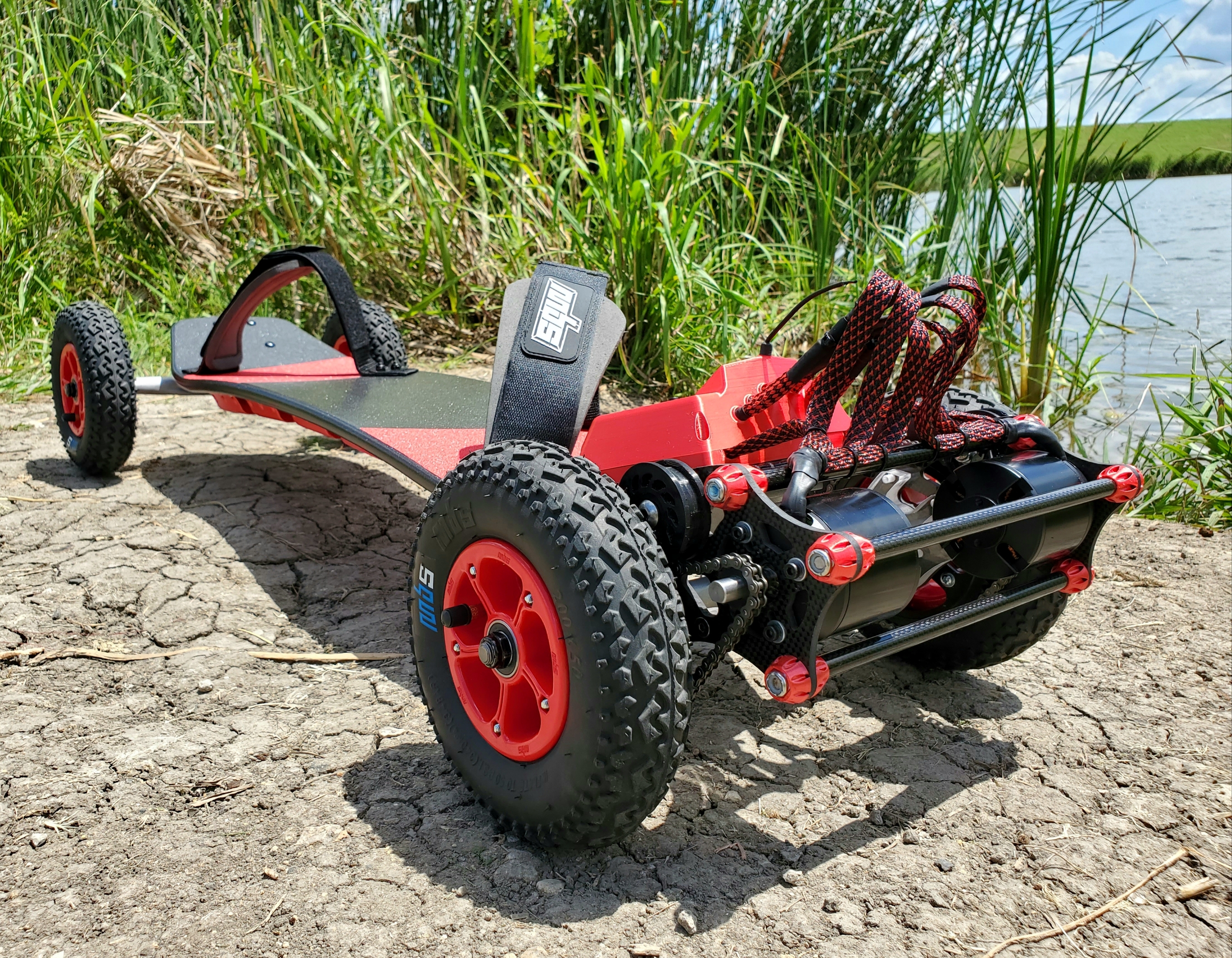

I can not urge you enough to not use ATS 12 trucks. They are beginner kite boarding trucks and not suitable for our application in my, unfortunately, experienced opinion. I wouldn’t use any cast iron trucks for that matter.
I would like to know more about this half inch bullet proof glass. Is it laminated polycarb, glass polycarb, acrylic? Why use this instead of metal? It will certainly be worse/weaker to tap and will add an additional issue of adhesion between dissimilar materials.
This is my current mountain board. Soon to be upgraded away from aforementioned trucks. It will be using a metal gear drive with metal truck clamps.
I like your bottom enclosures a lot. Are they 3d printed, fiberglass, abs, or other? The top rear one is 3d printed clearly, what material?
Nice Board man and thanks for the info on the trucks, yes your correct they are cast aluminum i only used them to keep cost down for consumers but now that ive seen its a safety issue i will update them to something better. all of the enclosures are Talman nylon alloy that is dyed and is a very durable material similar to abs but more abrasion resistant. I do plan on making the truck clamps out of billet aluminum but for now this is the strongest/easiest material for me to manufacture myself eventually i will upgrade the enclosures as well to injection molded pieces. Could you recommend a better truck choice @Venom121212 , Metal Matrix 2
