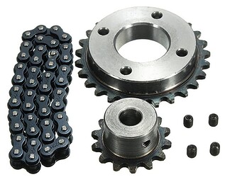

Chain drive adapter
for this kit
sprocket mount 2 holes.stl (448.0 KB)
sprocket lock 2 holes.stl (448.0 KB)
disclaimer: I haven’t run all these on actual board yet.

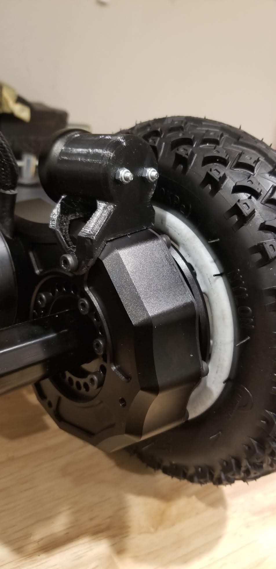

new XLite100 mount to moon drives (batch 6) -
super robust. zero flex at all in petg. very happy with this version.
Requires (ea):
  • qty 2 x M3x10
  • qty 2 x M3 nuts
  • qty 1 x M4 x 8? (uses the short M4s that come with the moon drives. had plenty of extra)
  • slightly drill out the mounting holes in the xlite cap to 3-3.5mm
XLite Bracket Contoured V2 - L.stl (504.7 KB)
XLite Bracket Contoured V2 - R.stl (504.7 KB)
