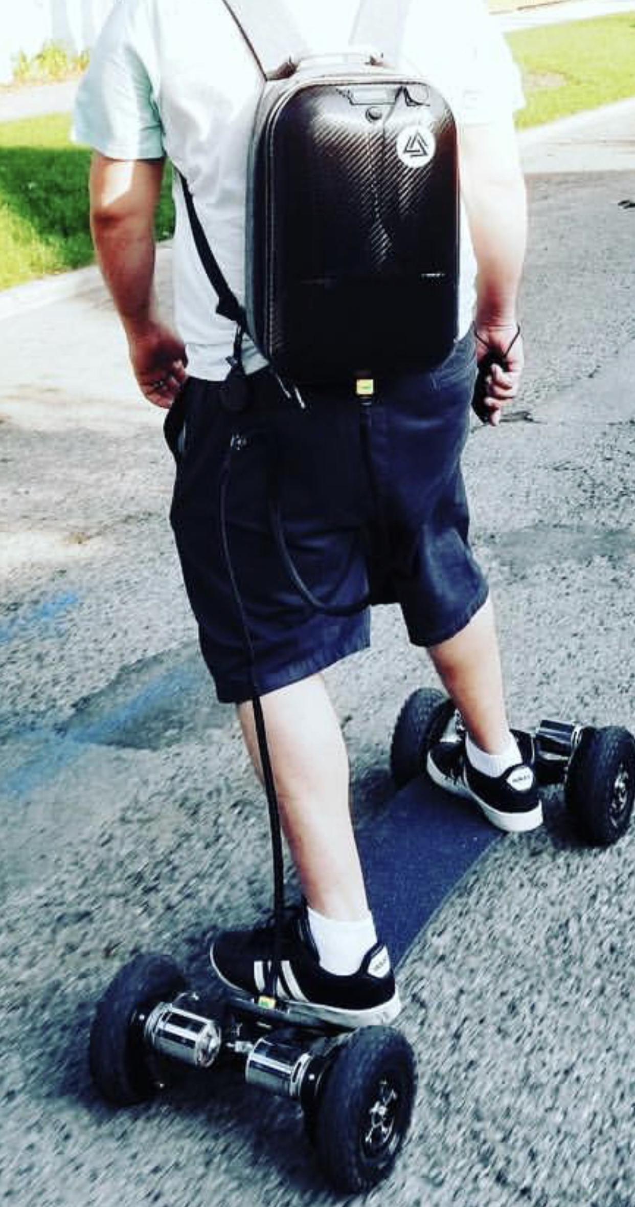

Moving the vesc closer to the motors is good, but moving them away from the battery in the form of a battery backpack opens the opportunity for inductance from the long power cables, so it would still be good to be adding (more) capacitors to the vesc input to tolerate that?
That was my thinking! The caps weren’t specced for long battery cables.

to create a super portable solution like this
Cool build but what if you fall on your back? :grimacing:
Backs are flexible, and most all proper backpacks (like the one I use) has a load-bearing / stiffening / ventilation sheet between it and your back, so not like there’s no protection. Obviously you also encase the battery in a LiPo charging (fire safe) bag.

My backpack parallels to my board so I can use my board alone, my backpack alone or both of them together. Biggest drawback is the board and backpack always have to be at the same voltage to connect them safely.
Been using it for over 2 years
It doesn’t charge my board, it powers it.

Originally I was going to use a large cap bank in the backpack, I thought I’d run it without it and see how it went. It works perfectly fine without it, just thick 8 awg wire is enough.
Just to mention, I can and have used it with the backpack alone but I don’t make it a habit and when I do power it off my backpack alone, I don’t gas it.
My theory on why it works so wel is that there is an onboard battery (12s3p 21700) which handles most of the amp output. I would assume the current comes from there initially and the backpack sort of ā€˜recharges’ the board in times of less amp draw
