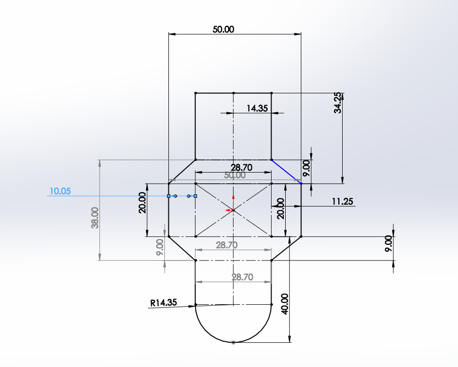

Almost
attempt dos
I have a design that is 99% perfect for my circuit board.
I feel like you’re super close though so probably want that satisfaction of diy.
nah you should post that here I keep messing this model up haha
can you spot the mistake??
Shoot I forgot I have it in 2 parts because of my switch/charger/riser combo setup
Here is the holy part:
The red radius is actually a spline I did so no measurements really. It’s closest cousin is a 13mm arc.
The other part (square cutout) is just a 28.5mm wide rectangle to reach the end of the deck so you should be good there.
