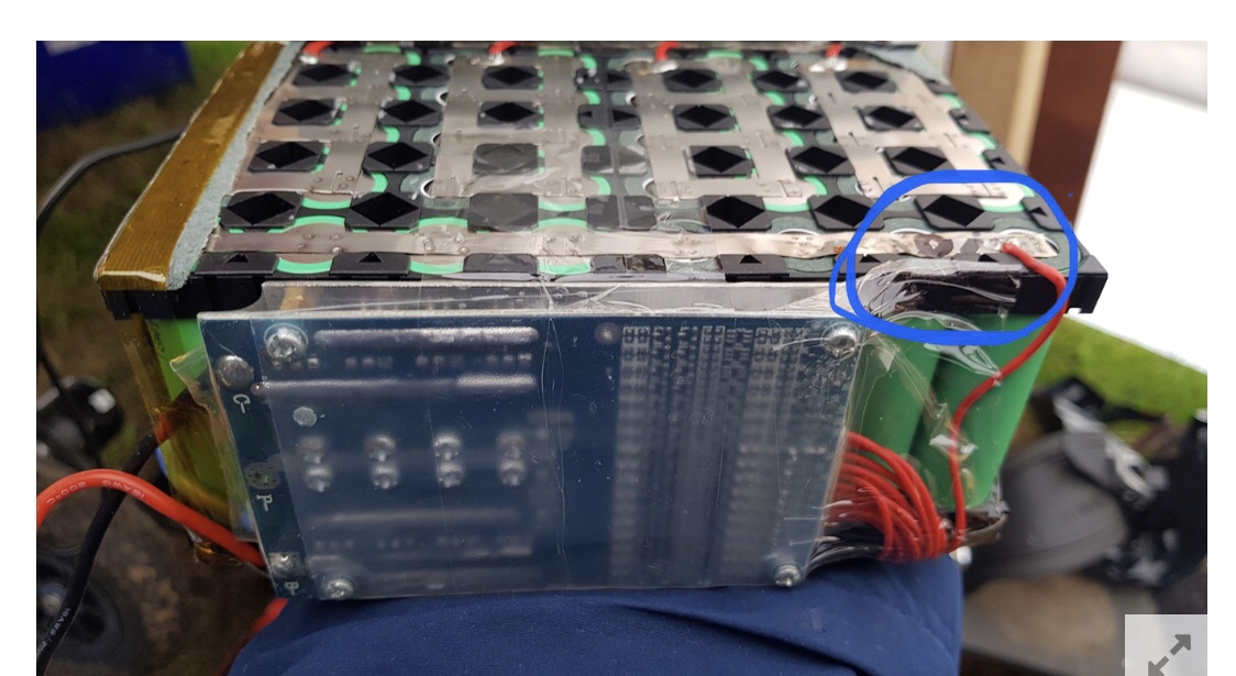

Hey guys thanks for the warm welcome and quick response.

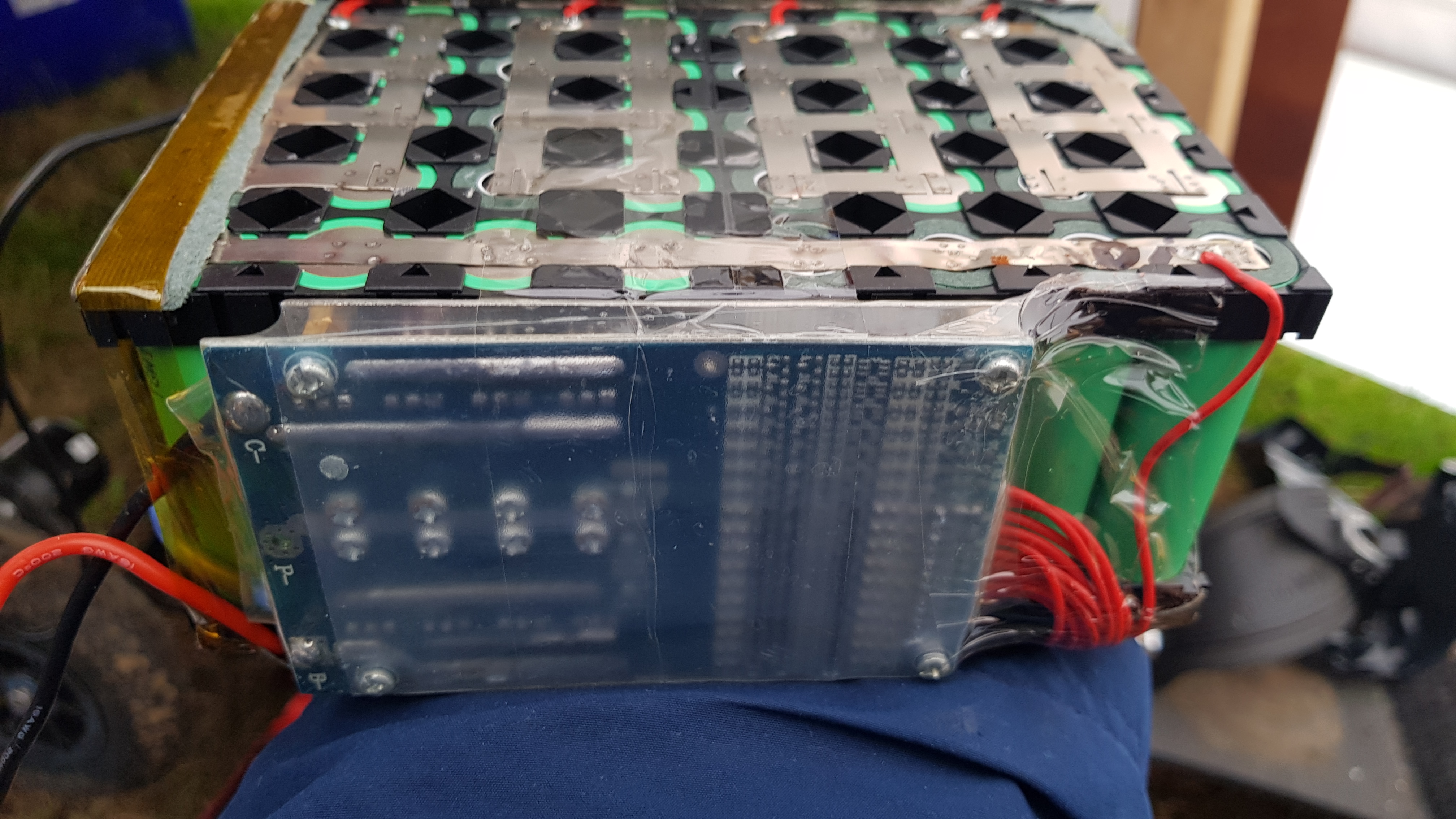

Here are a couple of pics, i just took the shrink wrap off the battery

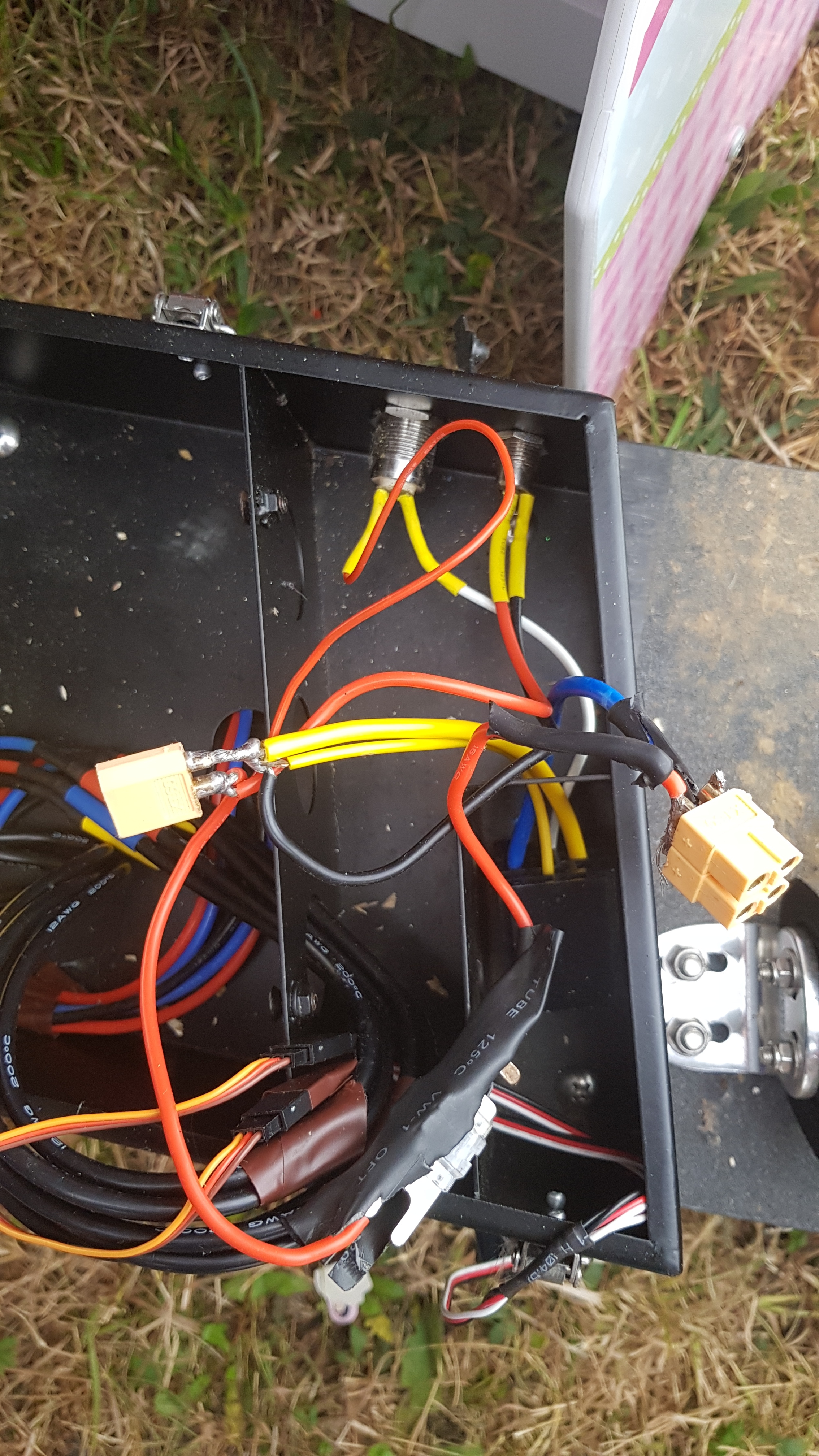

And the wiring of the board, a bit difficult to see

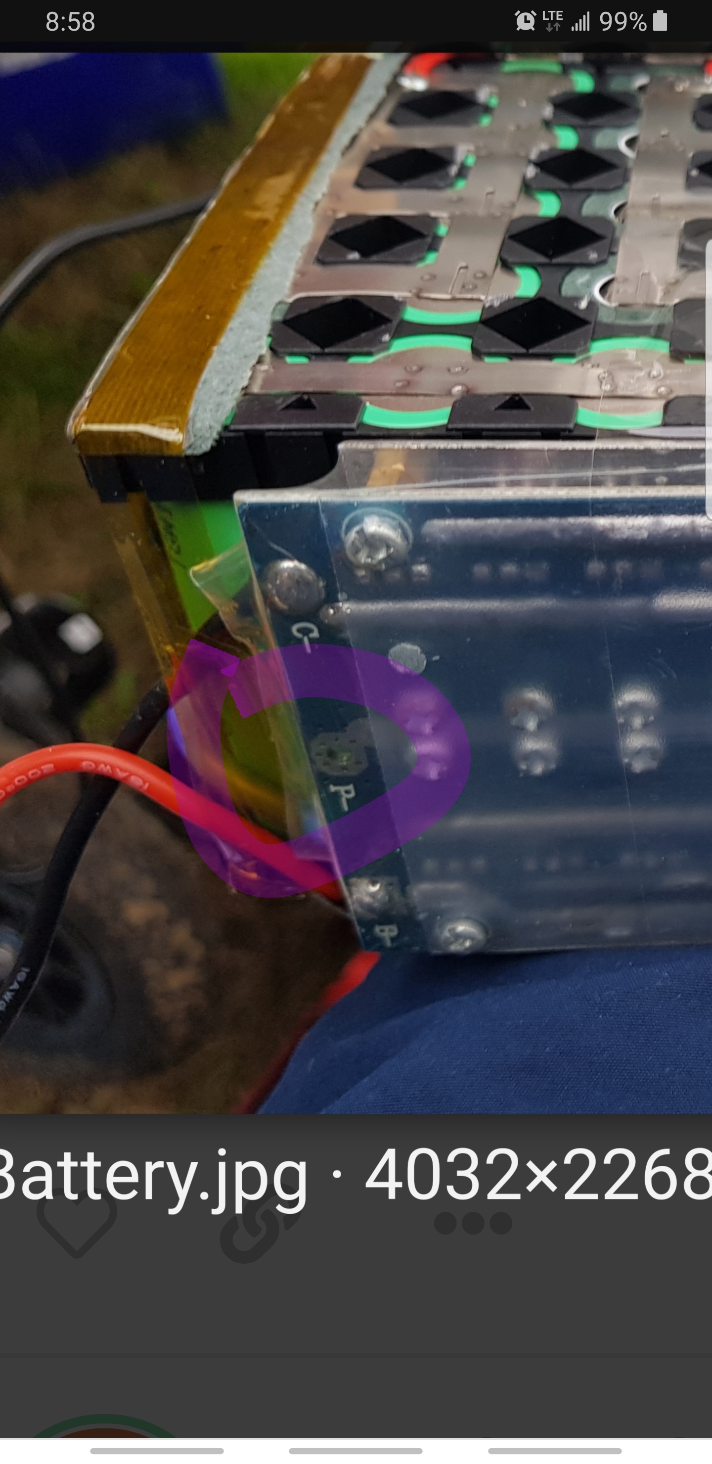

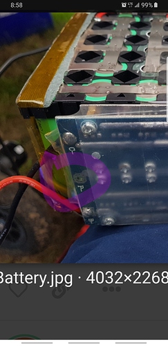

With a BMS it’s important to know if the discharge goes through the BMS, or if it is used only for charging.
Also a FET-based anti-spark in the chain is another failure point.
I’d turn it on and take multi-meter reading from the battery itself, the BMS and any anti-spark, for sure a VESC can use 36V to turn on and spin the wheels.
@magharees @Andy87 from his pic you see it slightly. It’s a bypassed bms. P- isn’t being used :slight_smile:

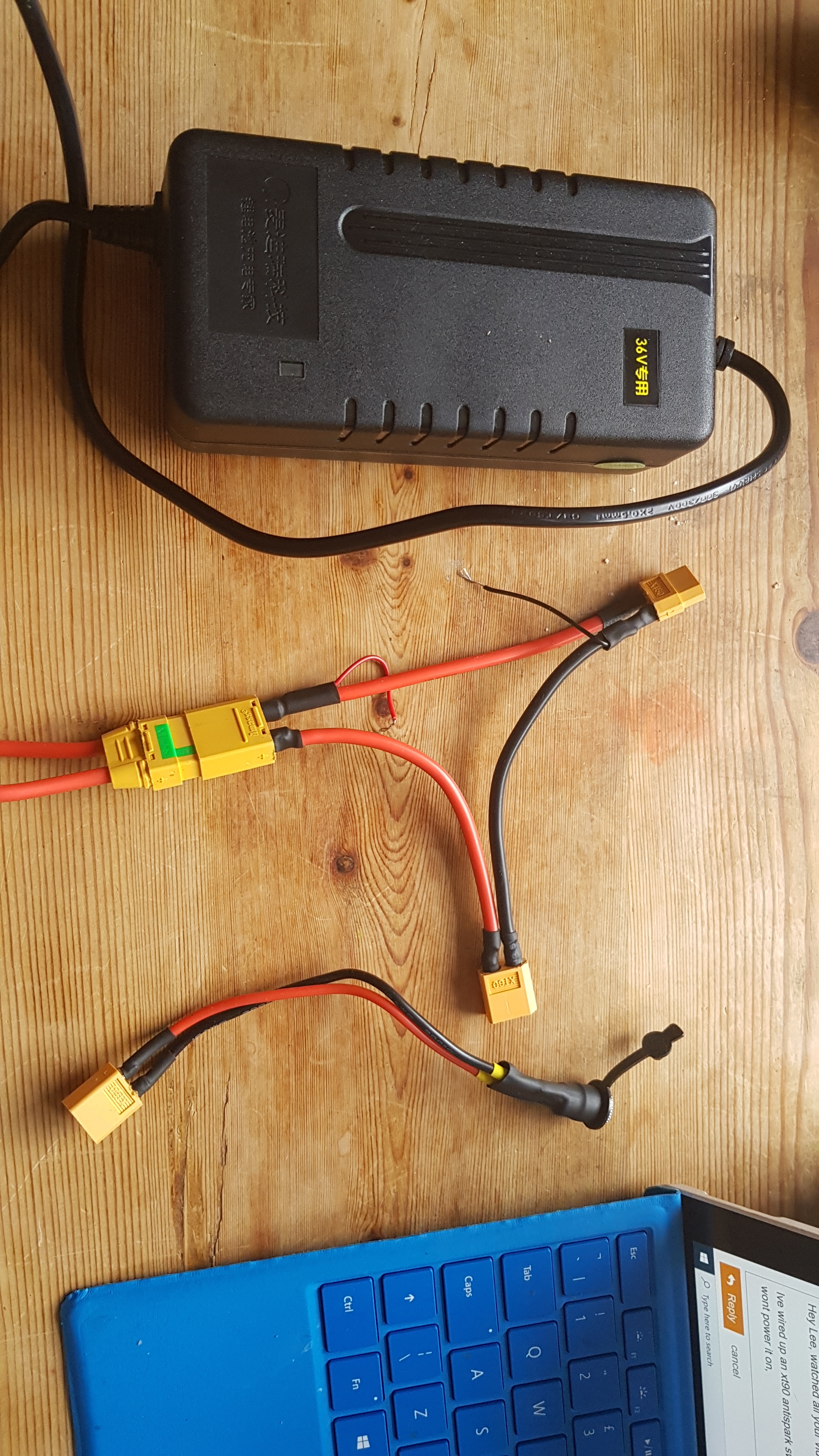

Ive wired up an xt90 antispark switch to test the battery and vesc still wont power it on. Heres a pic of the charger he sent rated 36v as well? The extra wires was where i had a voltmeter but just cut that out to test a 9v battery to see if it was working.

He can just use the charger to power the escs on :wink: that’s enough to check if they still work. For motor detection and stuff I would better go with a battery though :sweat_smile:

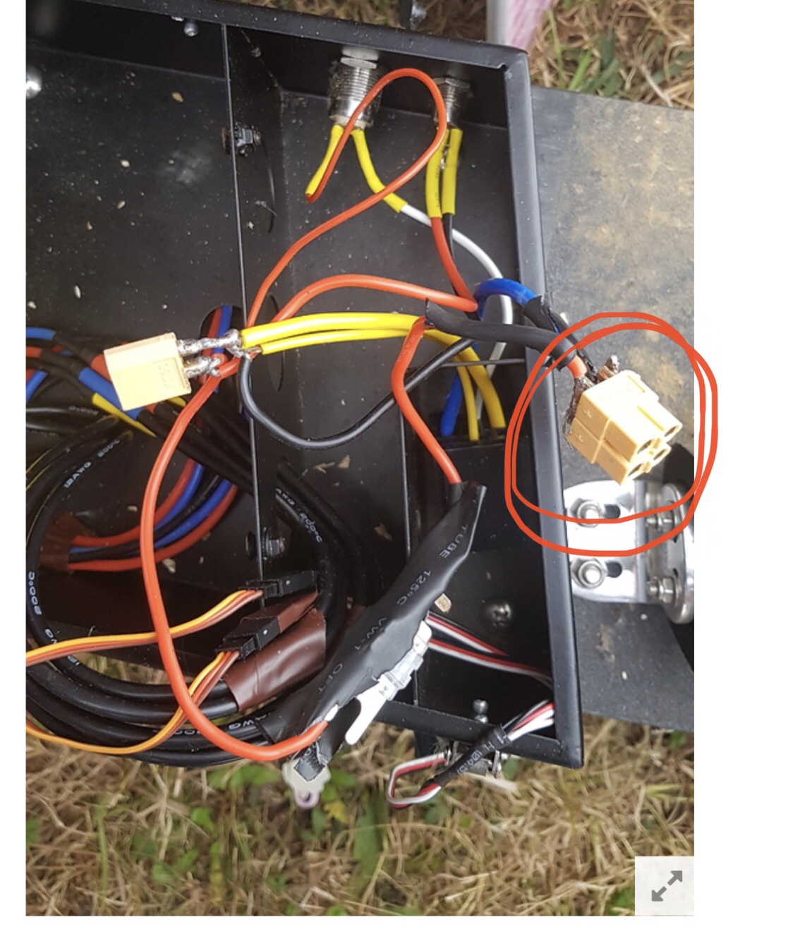

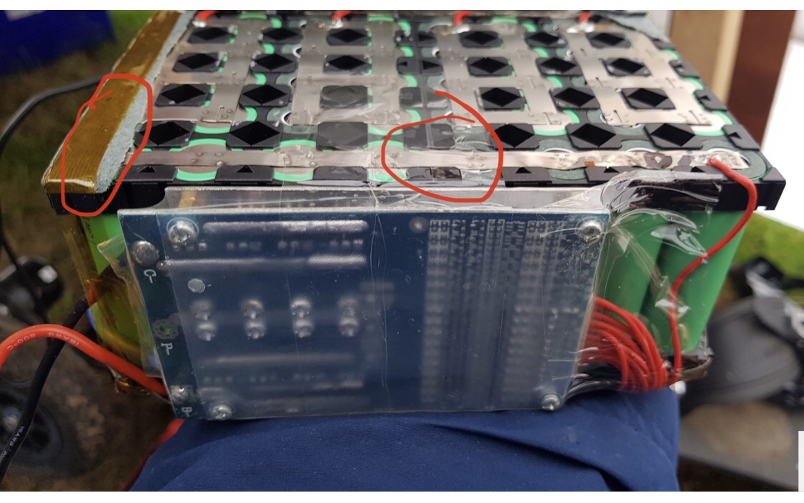

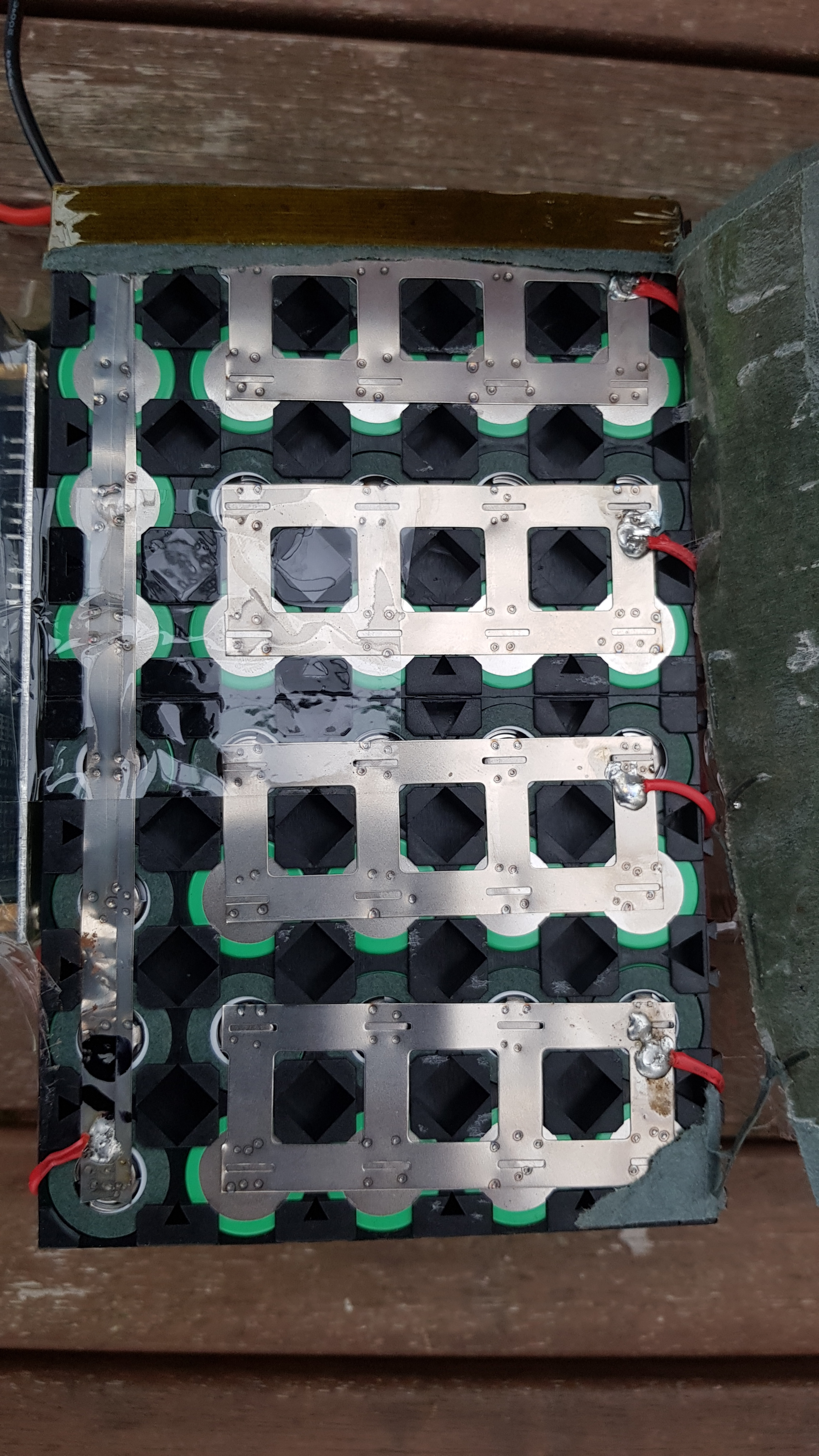

This battery layout is very stupid.
All current run in this two places over only one nickel strip
Also not sure what’s going on here:
Is it just dirt or something burned there?
I see there is a fuse. Did you check if the fuse is still working?
I guess this are the plugs for the vescs?
Did you measure there voltage when battery and loopkey is plugged together?

Yeah, that mark on the battery is a marker pen from whoever built it. and thats the double connection to the vesc but i made a simple wiring harness to test the battery and vesc with the xt90 antispark so completely bypassing all this wiring in case of a fault anywhere on his wiring.
I measured the voltage of the battery with nothing connected and then with it connected with the loop key and it all reads 36volts.
So i can test the vesc with the battery charger? thats cool i will test that out tonight and see if they power on.

Heres a closer look at the top of the battery
