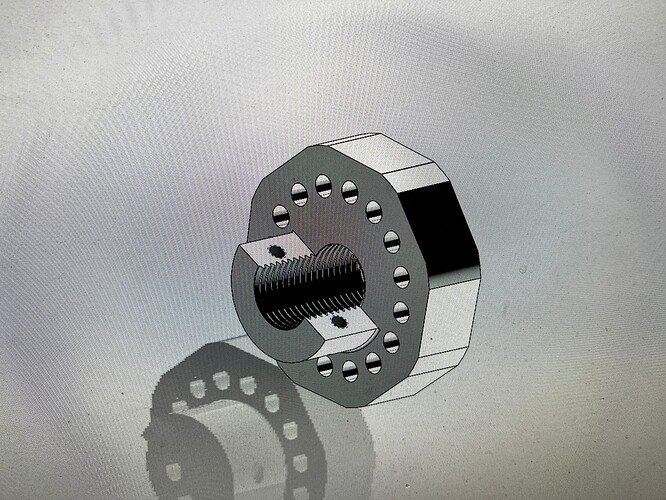

Seeing if there is anyone else interested in clamping adapters to mate 3 links to other gear drives out there like newbee, jump drives, or any other drive that face mounts.
I will make a couple sets this coming week, the price will be $100.00 for 2 clamps.
It is a 2 piece construction. This part is one solid piece…

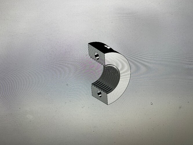

Then, there is this part, which clamps securely to the threaded rod without distorting the bolt holes.
Assembly looks like this…
Cheers, Phil

The thread is 5/8 -18 on what I’m currently making. Changing the thread size is no problem, as well as the bolt hole pattern. Just let me know by Friday. (7/21/23)

Just need the bolt hole circle for the BN AT. Jump Drives are 34mm, and Newbee are 40mm.
