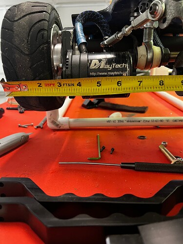

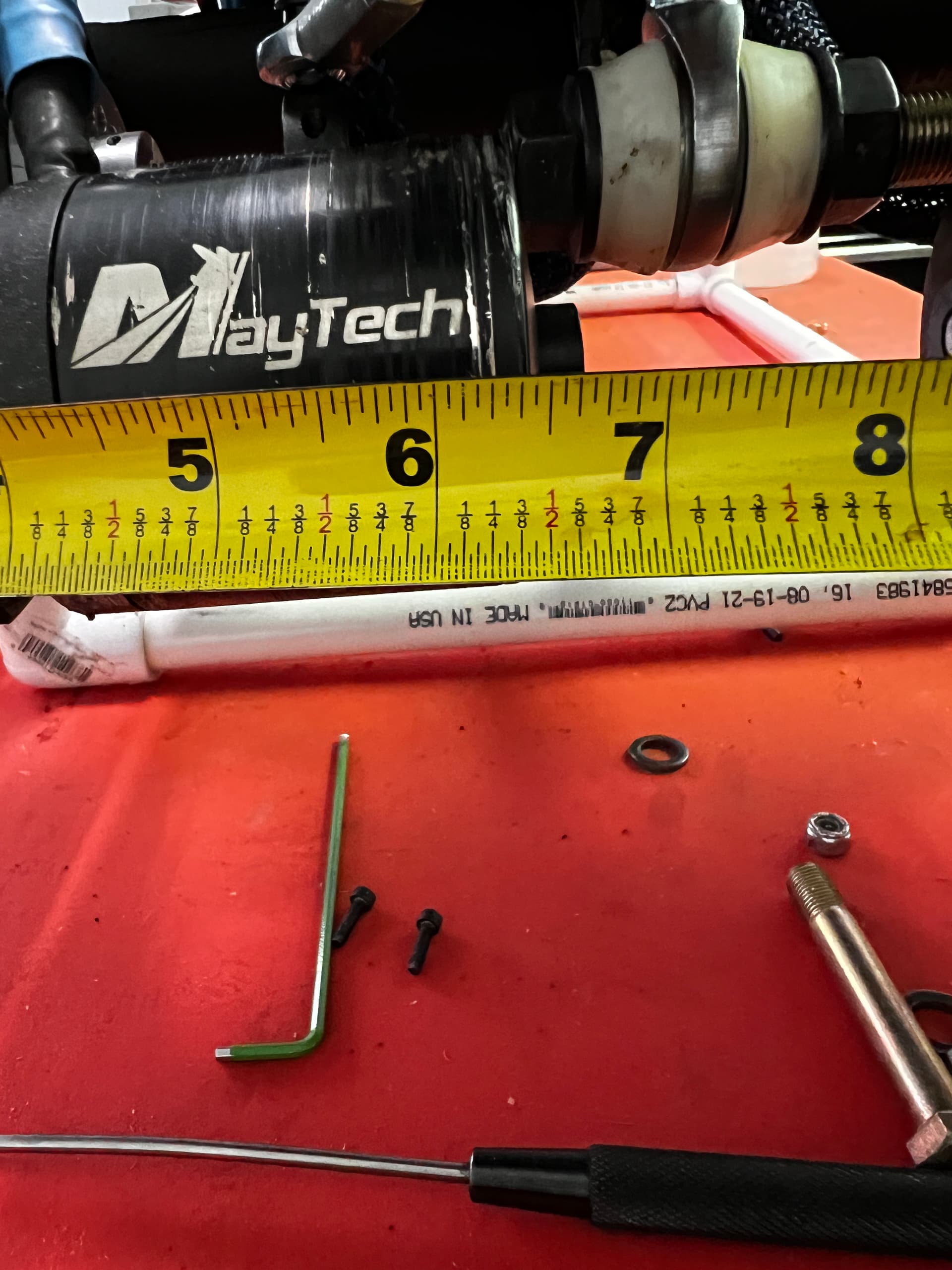

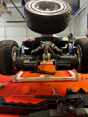

What is the axle to motor can distance for the newbee/Apex drivetrain?
Sure, just send them over.
I have a few more.
Not quite sure which distance you’re referring too?
This i mean, for example how much motor space is left depending on which gear drive is used. I am using the standard hangar, not the HD so it is not as long.
Looks like about 171mm.
Maytech 6374
165x65 tires
Jump drives
These are HD
