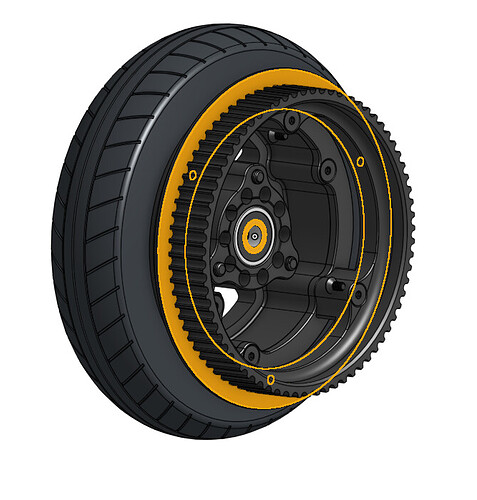

Will there be a version that will work with the boardnamics gear drive and axles?
Yes, there will be adaptors included that will allow you to use 22mm bearings + kegel. Here is a photo showing the adaptor vs 28mm bearings:
Purple is a bit less common, so might be expensive, but we can look into it for you. Is there a specific reason for powder coat over anodize?

@surfnacho @jjsessa I think if i read the first post correctly, these will not work with Rockstar II pulleys? I think you might be missing out on a really big market here. LaCroix riders will buy anything, especially fancy wheels. Just look at the LandSurf folks and their wheels.
I think if these were a drop in replacement for the Rockstar II’s without needing a new pulley, then you would have an easier time selling these to the huge LaCroix owners market.
Just my 2¢
Yes you are correct, they will not fit the Rockstar II’s. Adding so many hole patterns is already fairly tricky, and the rockstar pulley pattern doesn’t really fit with our current design. That being said, LaCroix owners could just swap to our pulleys. We intentionally priced them low so that the whole package is affordable. With the 72t pulley option, users wouldn’t have to do much to install our wheels and pulleys. I do appreciate the suggestion though.

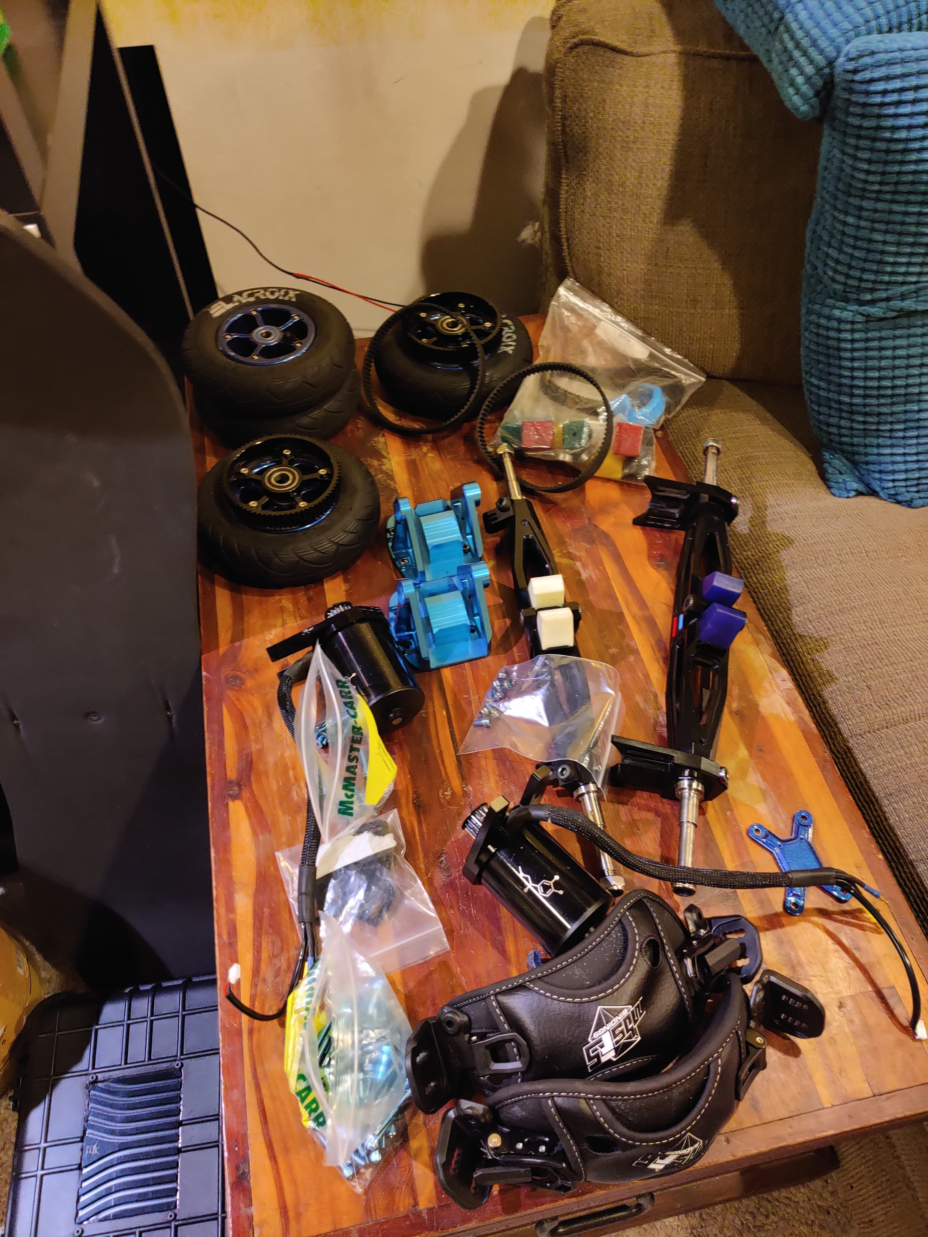

I am sitting right next to a LaCroix drivetrain, what measurements can I get for you? :grin:
Are those pulleys different than the standard rockstar 2 pulleys?
I thought we were talking about these plastic ones without bearing
Yep, they have much longer offset posts, which moves the pulley line away from the wheel a lot.
Not sure if LaCroix used those on the Prototipo, but all the Nazare/Lonestar that I know of use these machined pulleys.

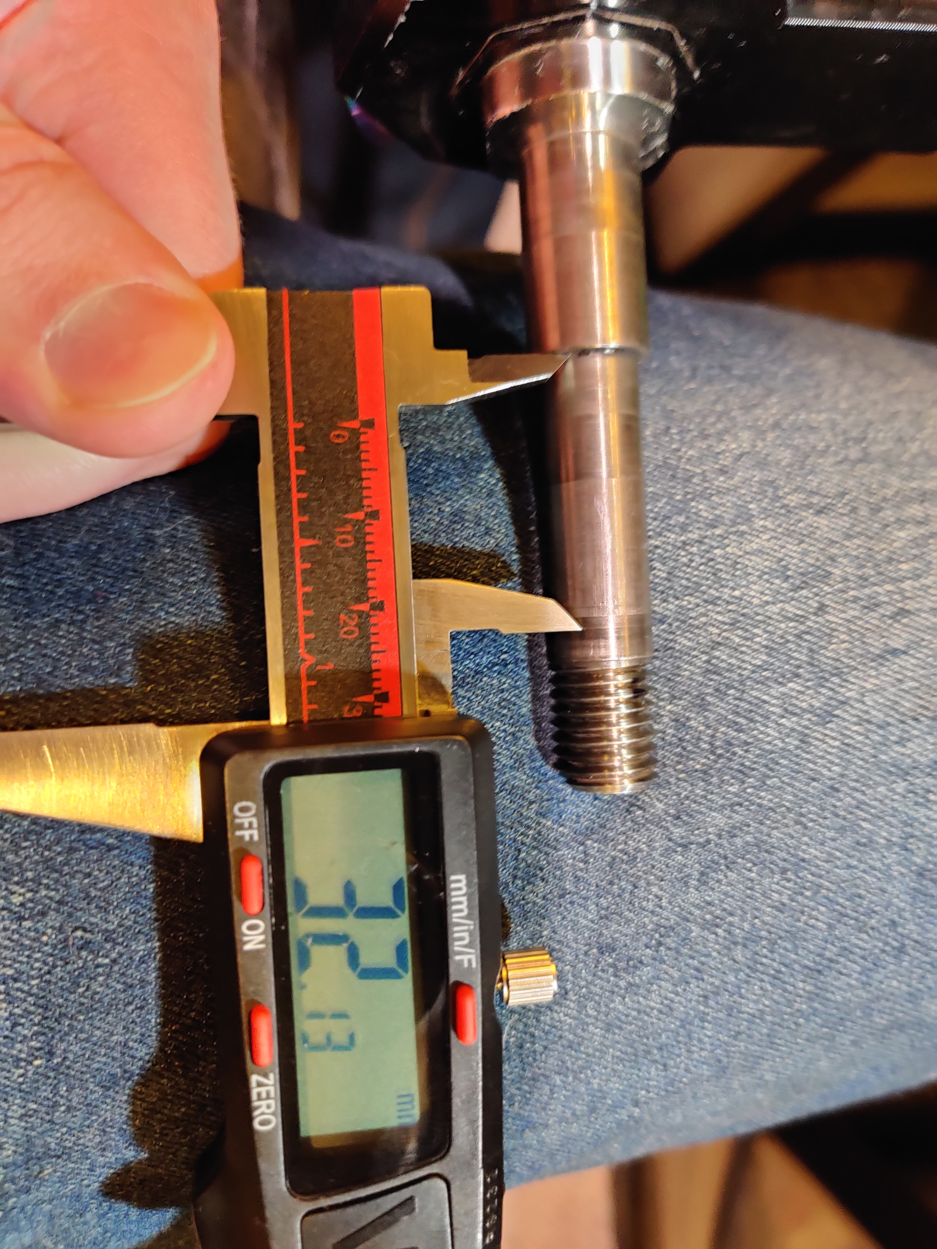

Distance from the bearing face to the pulley flang should tell it all, its 10mm on our wheels, if you need less you could always just use some spacers considering the axels are long enough. The bearing to bearing width of the wheel is 32mm on ours.
28.6mm from the outside of the wheel pulley to the wheel bearing, and the wheel pulley is 18mm wide. So roughly 10mm from wheel bearing to inner pulley flange!
The bearing width of Rockstar II’s is 38mm from outside of one to outside of the other.
Here’s where 32mm lands on a Hypertruck axle.
But that just means it would need a 6mm spacer on the road side of the axle to push the wheel up to the step on the Hypertruck hanger.
