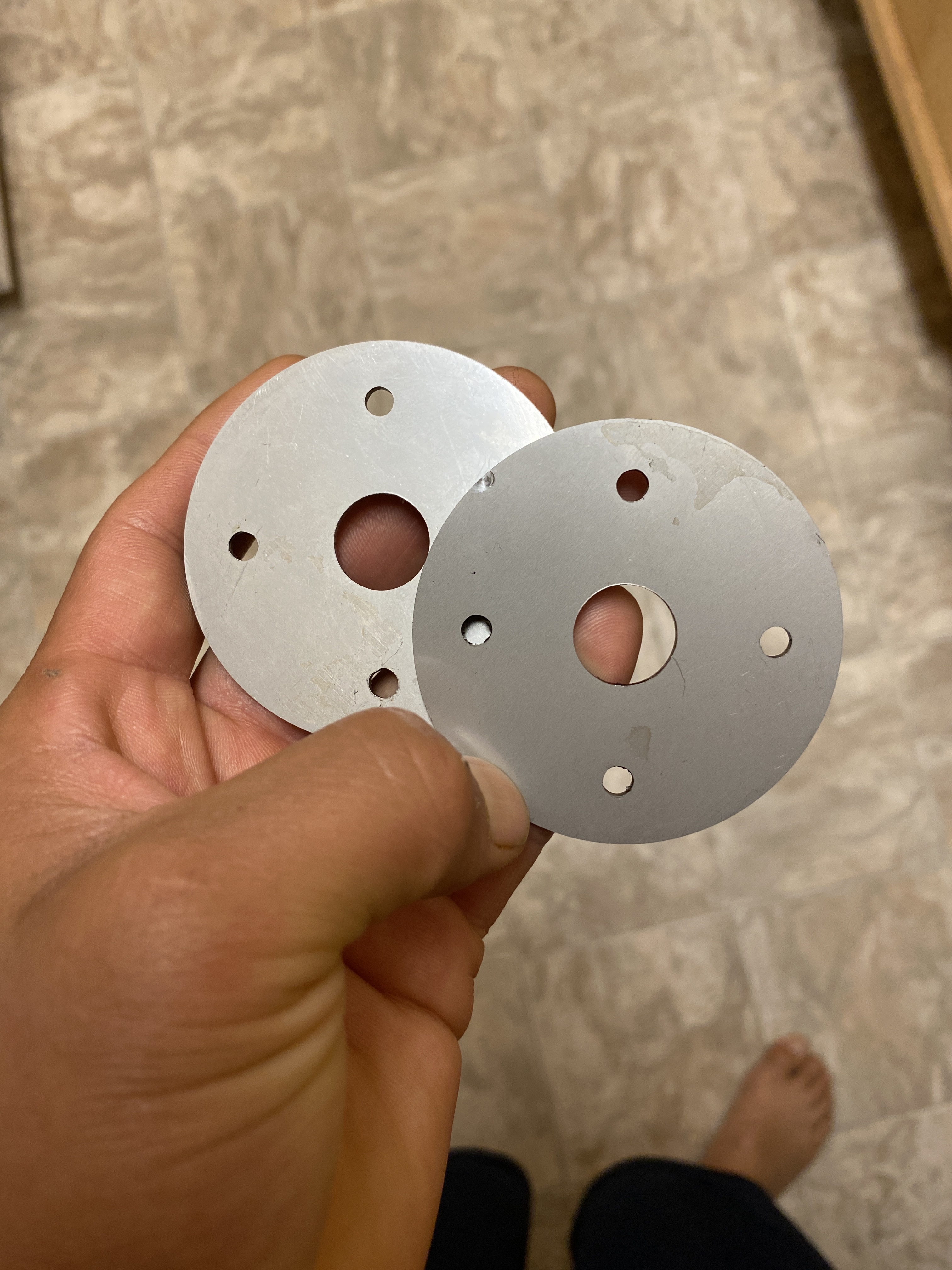

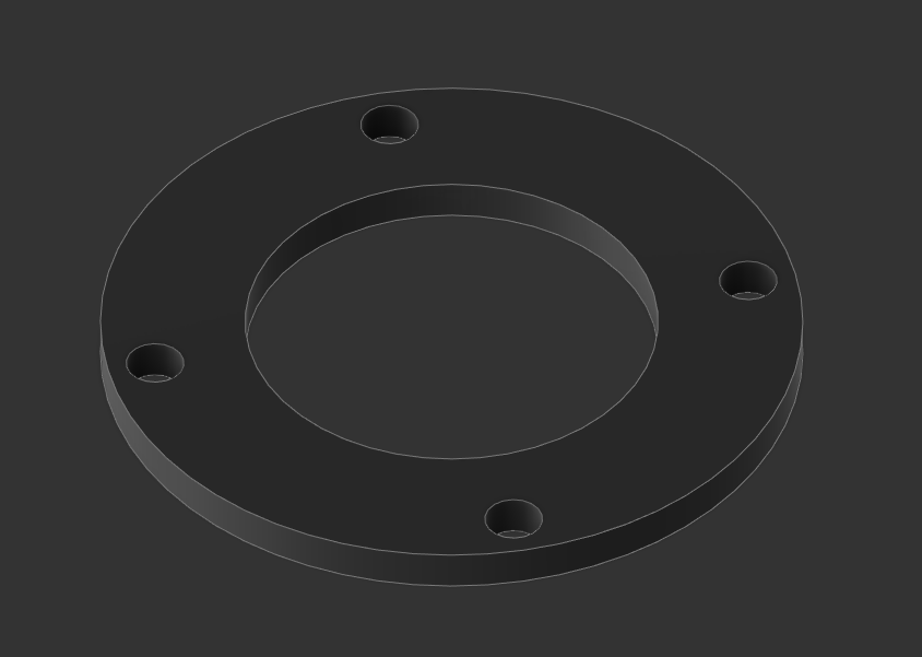

Also this quick and easy motor spacer could be useful to those with 27mm shaft Maytech motors.
No need to trim your shafts :slight_smile:
thoughts? Made from Alu
I like it. Maybe make it as a grease cover for dual functionality?
Love mines :grin:

Good idea but I would make the inner diameter just as big that it lets the circle clip spinning freely. More surface means better heat transfer to the case.
