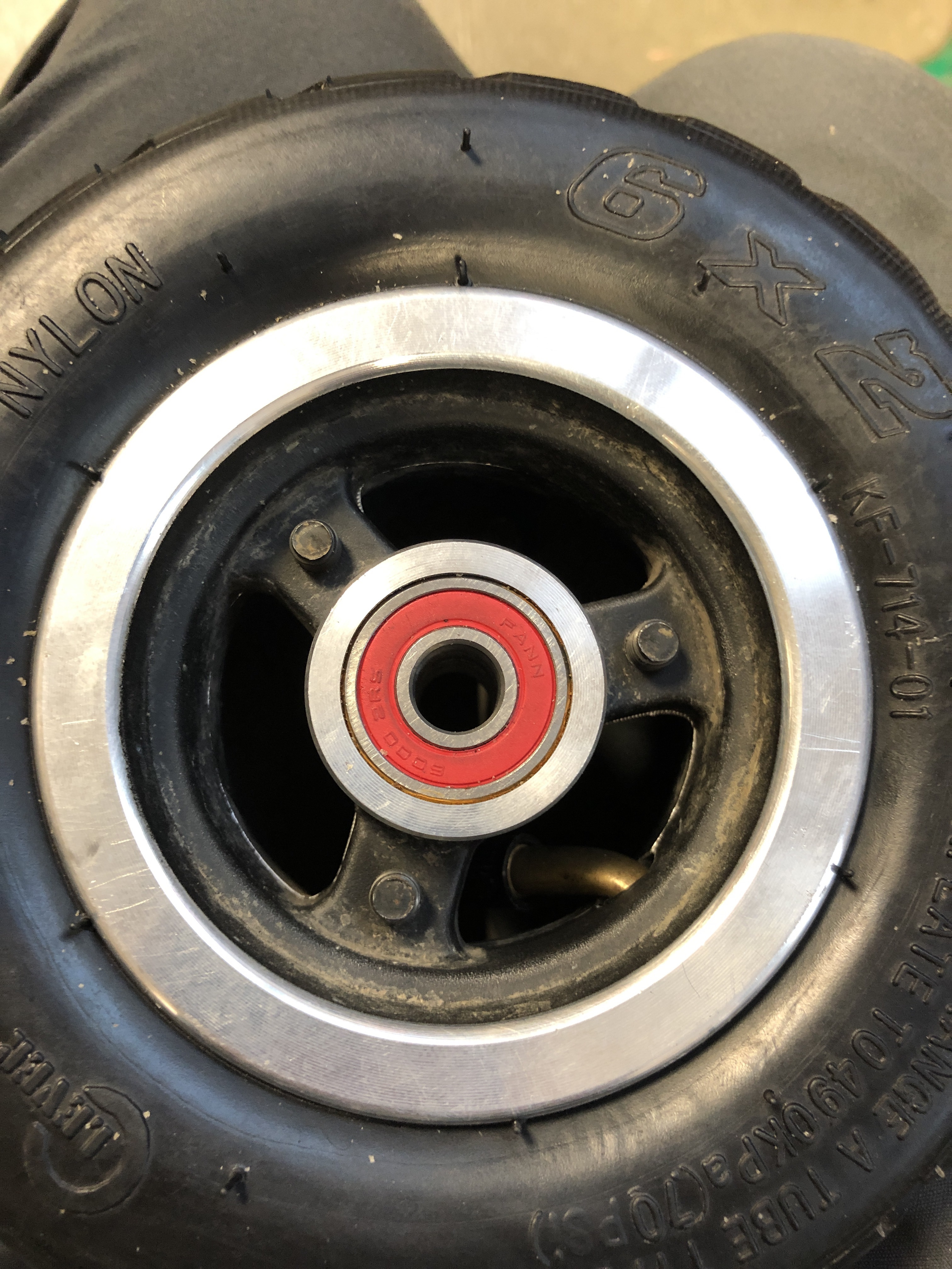

What measurements would you need? I have a pair that I’m pretty certain are the same as dickyho’s although I got mine from aliexpress.
@torqueboards the hubs should fit no dramas. The bolt pattern is similar to MBS rockstars FIY
@annihil8ted
need the bolt diameter and the size of bolts used
You’re talking about the bolts holding the 2 halves of the hub together?
Yes I am
The cheap AliExpress wheels are 3 holes equidistant 25mm centre to centre from the axle. They are M6 bolts.
I just got a cad model of them, will compare the two. Thanks.
@mishrasubhransu your model has a 48mm pitch circle diameter
@Amazingdave your posts suggests that the PCD is 50mm
either way both of them work with the wheel adaptor, just need to know the right value.
Go with @mishrasubhransu his CAD is probably more accurate than my hurried fumblings.
I made 3D printed gears, adapters with that model that are currently being used by me and several others. What I have is fairly accurate.
However dickyho claims that there are different sizes of those wheels based on different manufacturer.
Do one thing. Measure the center to center distance of the bolt. Like the sides of an equilateral triangle. That should also give a good estimate of the diameter.
