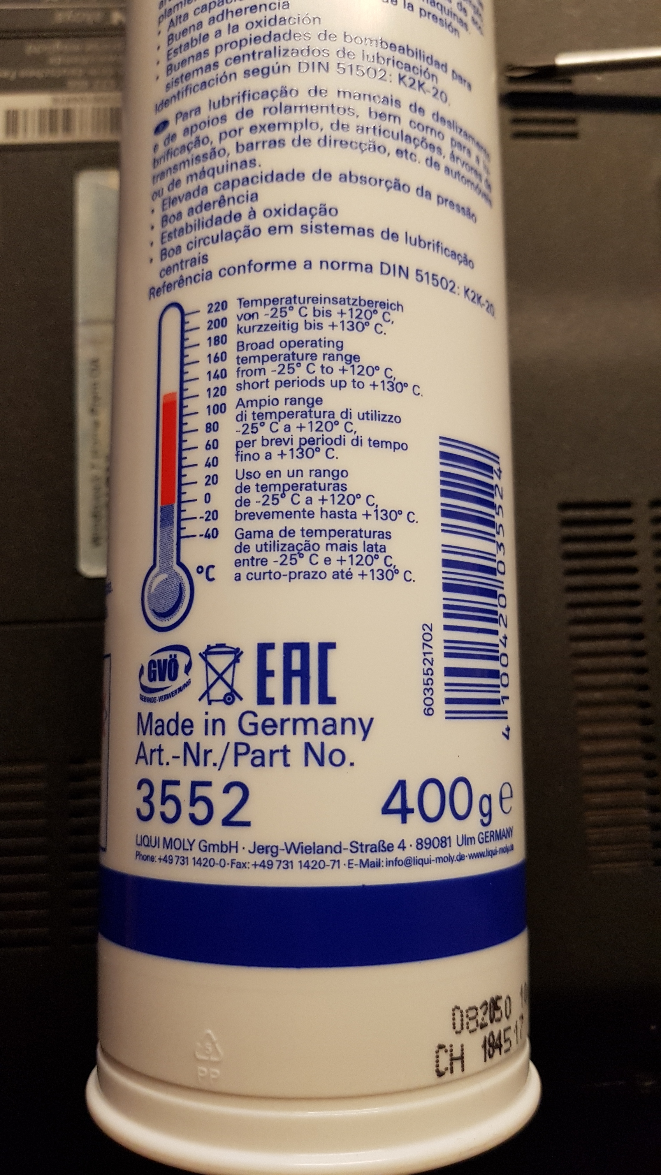

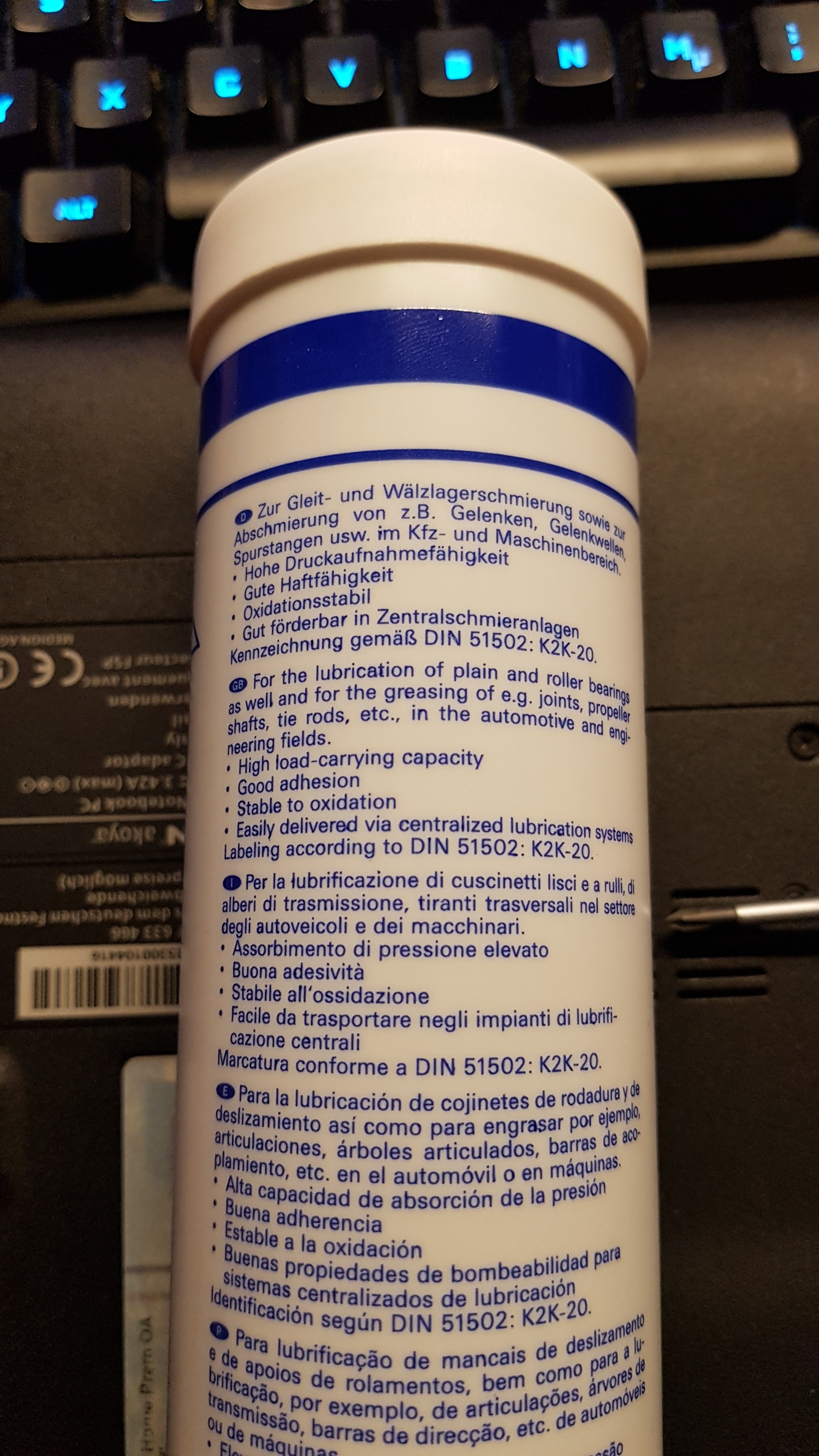

It says Liqui Moly, and last i looked molybdenum disulfide is great for metal (maybe steel but not alu?) but not great for plastics/rubber. It looks like a brand name though, so maybe it’s not moly grease? :slight_smile:
K2K-20.
My motor pinion is steel.
Lithium grease, should be fine I think.
Doesn’t lithium grease lose its property with heat? I thought it was used in slow moving objects.
IIRC eskate gear drives seem to run okay with zero lube? The lube seems to be more for reducing sound, not so much lubrication?
120°C max.
