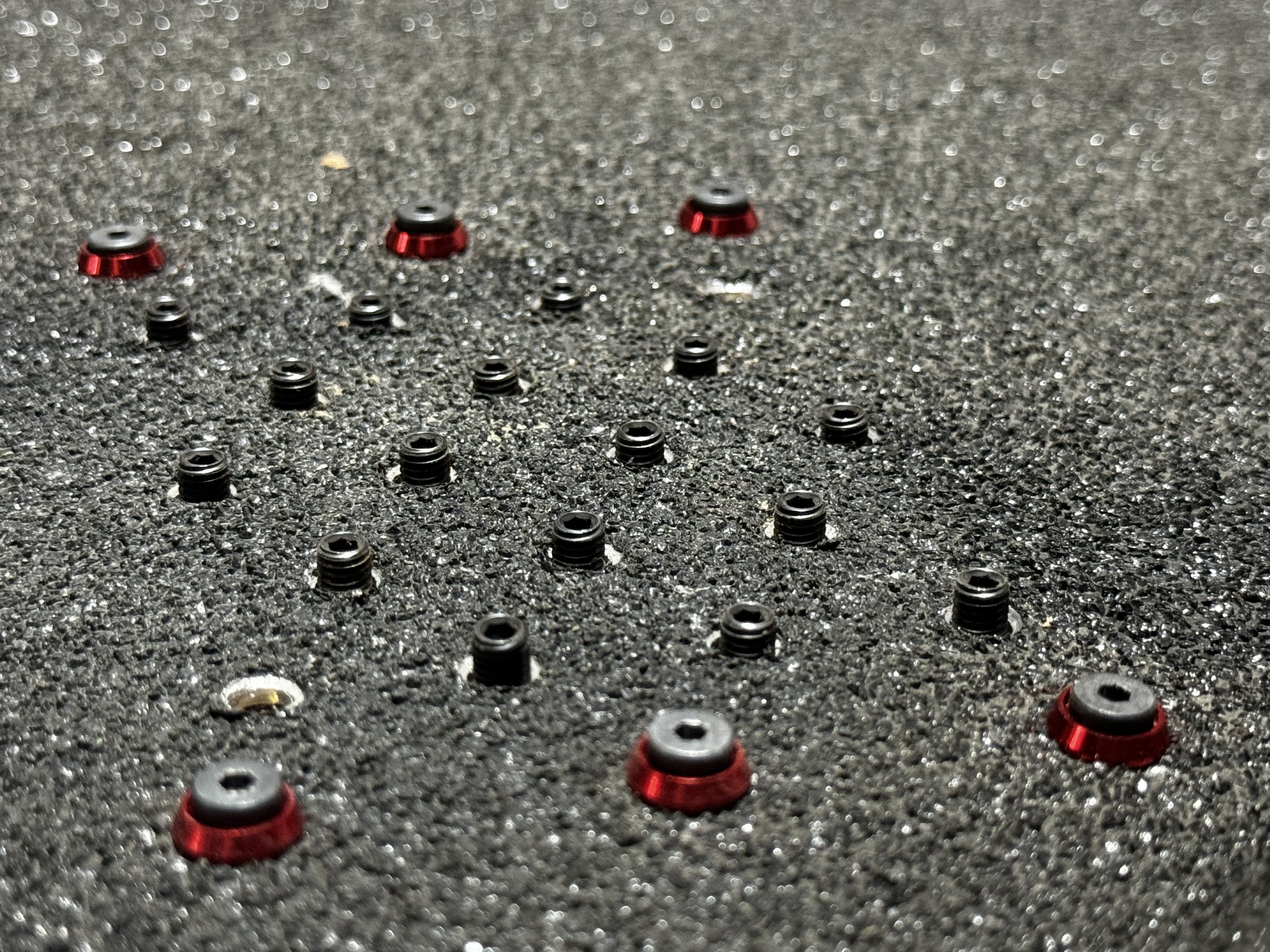

Still trying to do more than what I should be doing
Suffering through a lot of pain to keep it moving :sweat_smile:

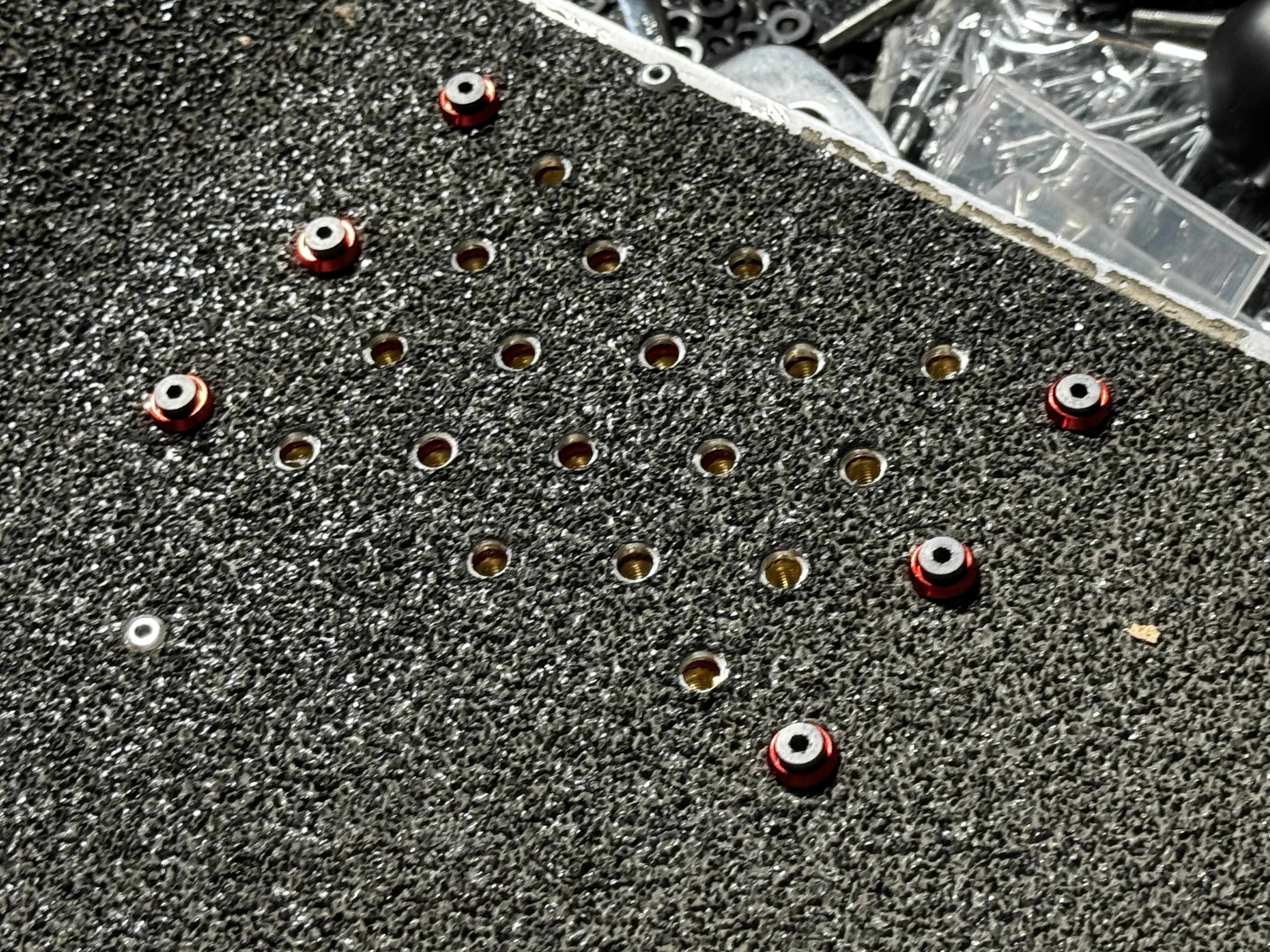

Have to readjust a couple holes.
My drilling isn’t A1 currently so the holes are off
Due so much pain and loss of focus :grinning: hopefully don’t fuck this readjustment of the inserts rn
Successssss
Probably need longer grub screws later on

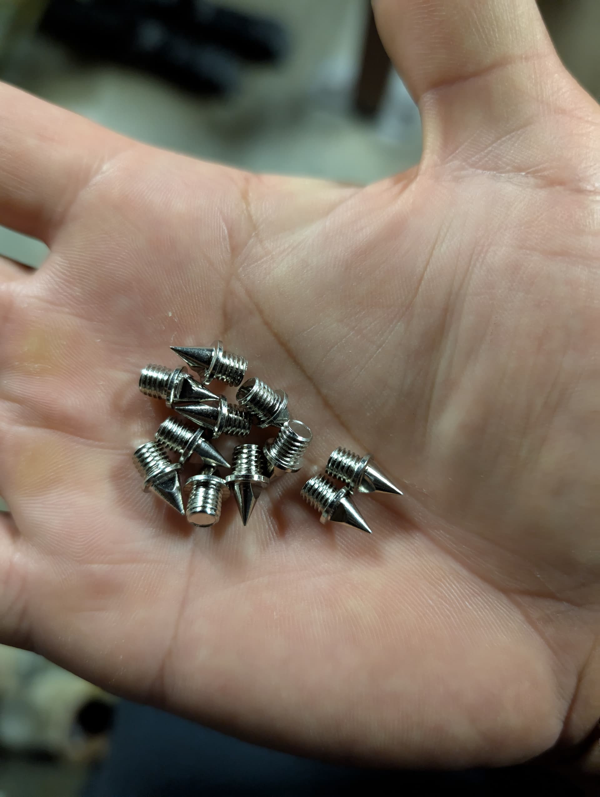

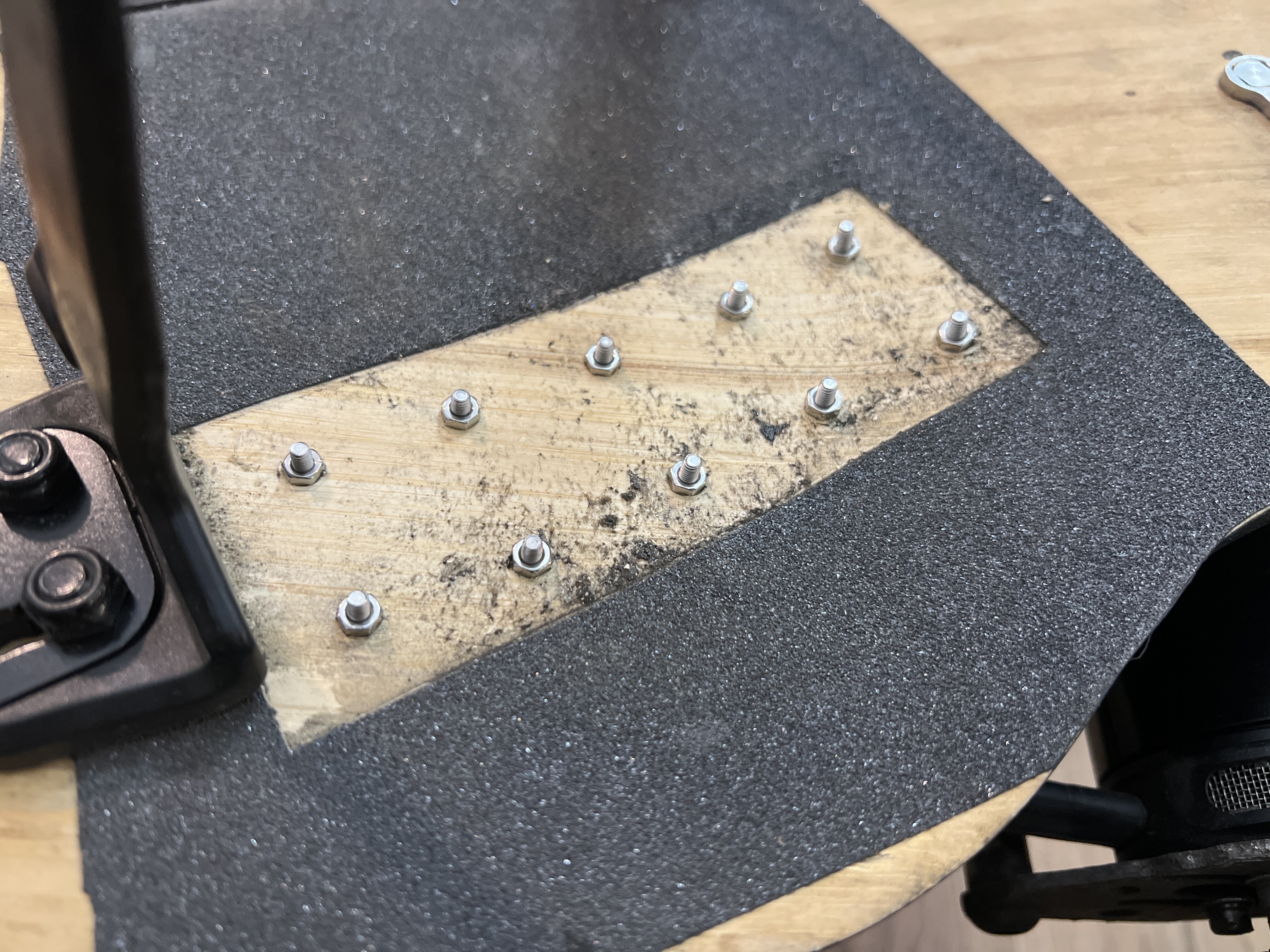

Not keen on running spikes?
I don’t have the money to keep buying a left shoe, yeah I could have went that wood screw route, But I don’t have a wooden deck I just feel like this might be a little better.
Also kind of demonstrating to myself that I can design and make things that are different.
I mean the actual running spikes rather than using ā€œspikesā€ I was gonna do something similar for my back foot but just using a nuts and washers on the underside… would say your vans should be pretty tough knowing how they hold up on BMX pedals but I hear ya.

That looks a little too sharp for me.
Why don’t you just put a magnet in your shoes dude? And a couple on your board
Bro is trying to feel something :joy:
Yeah possibly… no worse than some of the pedals I had though. I thought i saw ruxx running something similar. I’m sure when it comes time to move the board on it’ll be better without the holes anyway.
You can prob use something like this. I have an EUC with spikes similar to this and they grip pretty well for me.

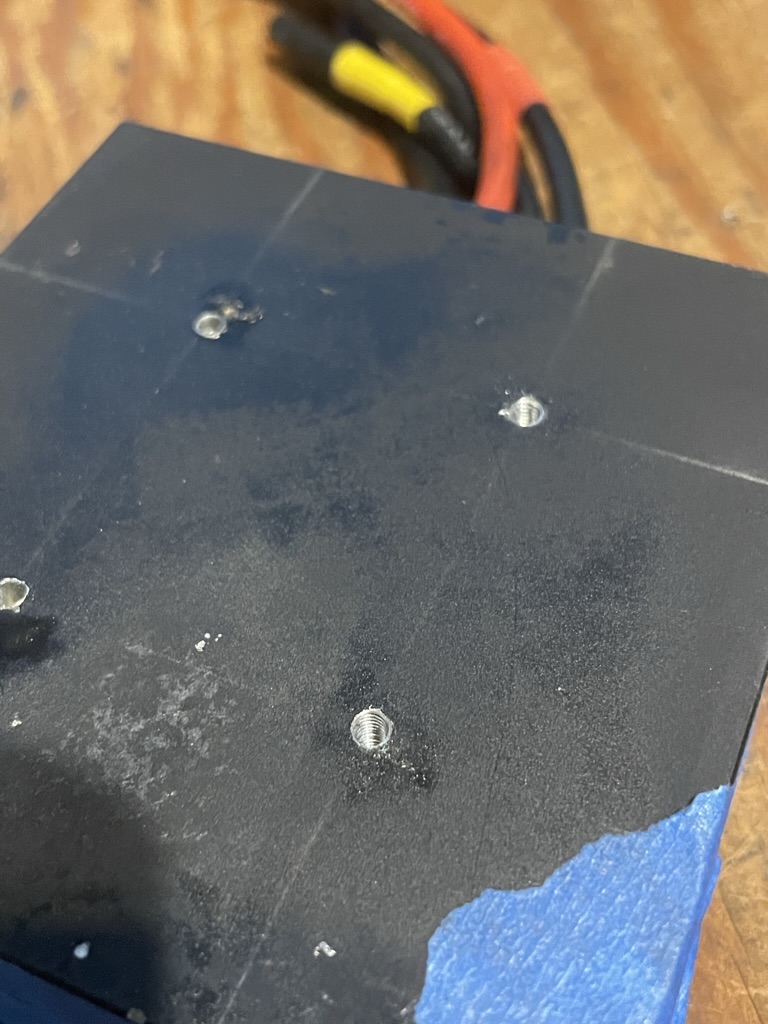

Fess how did you know / determine where to drill these holes?
I accidentally stripped the m3 threads awhile back.
It has held in by sheer awesomeness for some time but the screw finally fell out :frowning:
I now am thinking I should drill & tap to m4 screws but I’m concerned about increased width of the m4 drill & tap potentially poking through and destroying
Precious foccer hardware.
My thoughts are right now is just to drill a little less of a depth than the current m3 threads are at (to be on the safer side) as m4 would have more grabbing force overall, But I’m not sure whether it’s a good idea just yet. Concerned about damaging the Vesc with the overall width of m4 drill and tap because I am unfamiliar with how the heatsink is laid out on the inside.
If you go this route, definitely remove any electronics from the case before drilling and re-tapping. If nothing else, to prevent metal chips from scratching and damaging the PCB.
@tuckjohn I am kind of worried about dismantling and damaging the ā€œfetsā€ I’m sure I could do it but the 5-10% chance that I could fuck it up is holding me back.
Especially so close to esk8con
I’ll see if I can give it a go tho.

imo drilling into the heatsink with electronics attached is a larger risk :rofl:
But that’s definitely an opinion haha
If you’re looking to bodge a fix you could always attach the ESC to the board with VHB tape haha
