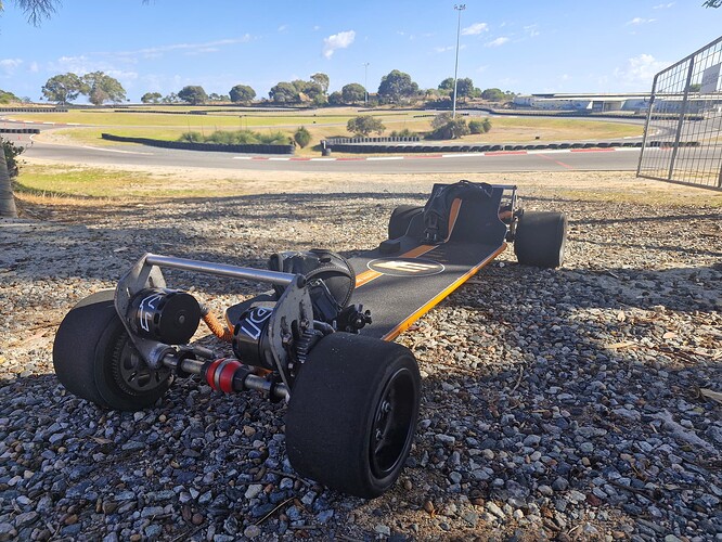

Recently picked up a Semenbone from Flowstate for myself and a friend, so I am building twins! But this thread will be mainly about mine. I’ve been out of e-skate for a while so I wanted to build a reliable/traditional setup that I know to work well (while I work on another project slowly). I’ve left plenty of headroom in the electronics for that reason.
Using the same power train I raced with in ERL, which was brand new at the time. Consists of:
- 6495 175kv motors
- D100s esc
- Hoyt puck remote
- RTKP gen 1 trucks from @Ean.esk8 @ 45/15°
- Linnpower slicks
- a new 16s5p P45B
- And an older wheel design of mine from 2022.
Thank you Evan, It was fun putting this together especially now that I somewhat know what I’m doing after the first build lol.
I nominate @Tasventouras beautiful 4wd v5 build.
After about 1 and a half years of good times and great racing on the previous setup, I was finding some limitations - primarily on caused by a narrow stance. Pushing through the uncomfortable stance was doable, but less than ideal. On top of this, I was getting wheel bite and burns from the rear wheel on the heel of my rear foot which affected my heel side turns quite a bit. I’ve been extremely pleased with the 3-links and 4WD drivetrain, so my plan was to transfer this to a new platform. I did…
