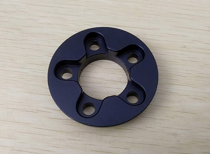

2020.04 revised dickyho's kegel wheel pulleys
this is for flywheels
this is for kegel wheels
The bolt recesses are a great development. Nice work!
Very nice!
awesome. can we get just the rings for our plethora of dickyho pulleys we might already have?
edit: I see that’s what you have listed… <3
it have 38 available on my list.
Is there was difference in functionality between the 2 different 5 hole retainers?
one is for 5mm bolts, for my current kegel pulleys.
one is for 4mm bolts, for my new kegel pulleys. (will be for sell soon, the product have been very slow during the out break)

I was noticed that many people are still use bolt on install pulleys, and my older design are not very good for bolt on.So I revised my kegel pulleys design. it can do well with both press fit and bolt on now.
the kegel hub is difficult to bolt on. I was thinking if use M5 bolts would be too loose, M6 too tight, can not get in. So I go back to M4. and use plastic tubes to fill the space on those hole, and the plastic tube is kind of soft, can obsorb the tolerance. this is the best bolt on solution I have so far. I tested much stable than previous design.
