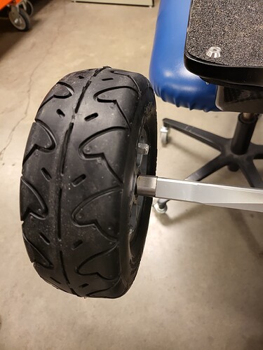

Has anyone tried mounting these on Boardnamics GT3 hubs? I’d love to try a set but I worry the narrower BN hub will cause some ballooning and ruin the contact patch benefits.

There’s no benefit for hubs that narrow. You need hubs closer to 65mm for it to be flatish

They’re 65mm but my fatties are basically flat at 25psi
Ive already got moderately wide hubs (XCELL Spyder XT @53mm between the lips and Lacroix Hyperrims @50mm between the lips), so im really looking for a significant bump up. Not sure if the newbee options would provide that at only 65mm from outer face to outer face. After accounting for the lip thickness theyd probably only be 55-60mm width. Also, plan isnt to run the 200x75 phatties, those work fine with my existing hubs, its to run 8x3 go cart tires haha.
Got any pics of the phatties on the Lacroix rims? My BN hubs are 49mm tire seat, so it would likely look similar
Let me dig through my phone haha.
Not the best photo, ill grab a couple more this weekend or when ive got a minute to switch the 200x75’s back on.

Awesome, still looks super flat. What PSI is that? And just to confirm, those rims are 50mm tire seat width, right?
These are 50mm lip to lip, not too sure on pressure as i just eyeballed it with a hand pump to test fit for ya haha. Probably 25-30psi? If yours are a narrower seat, youd probably get bulge.
