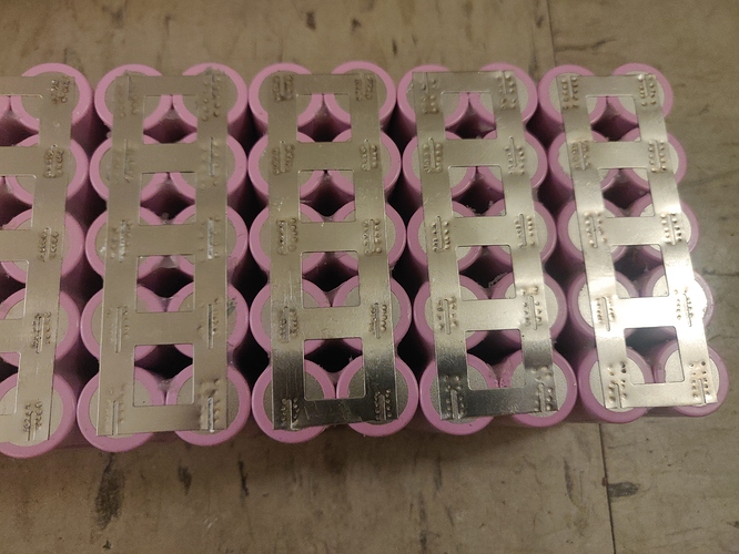

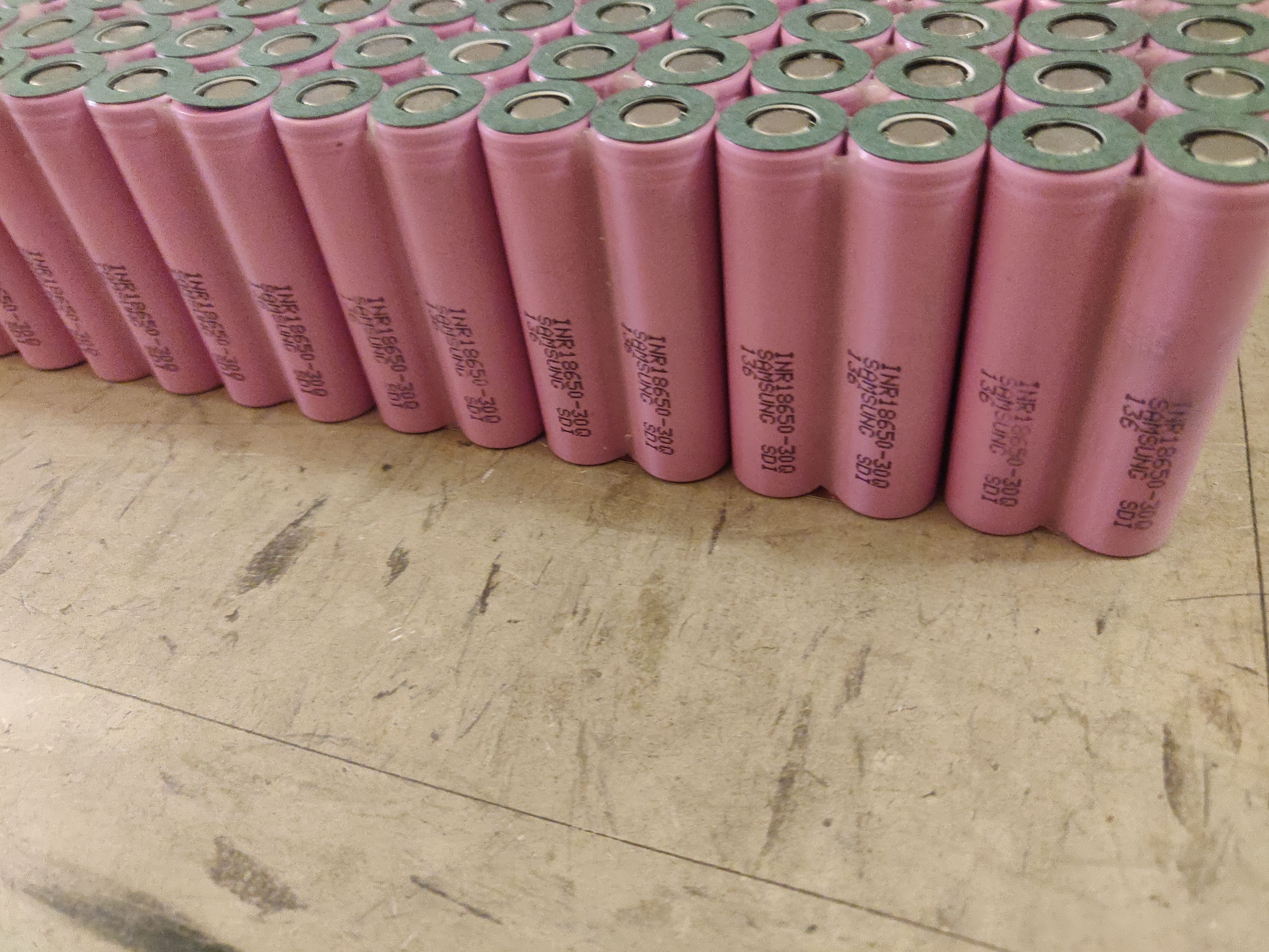

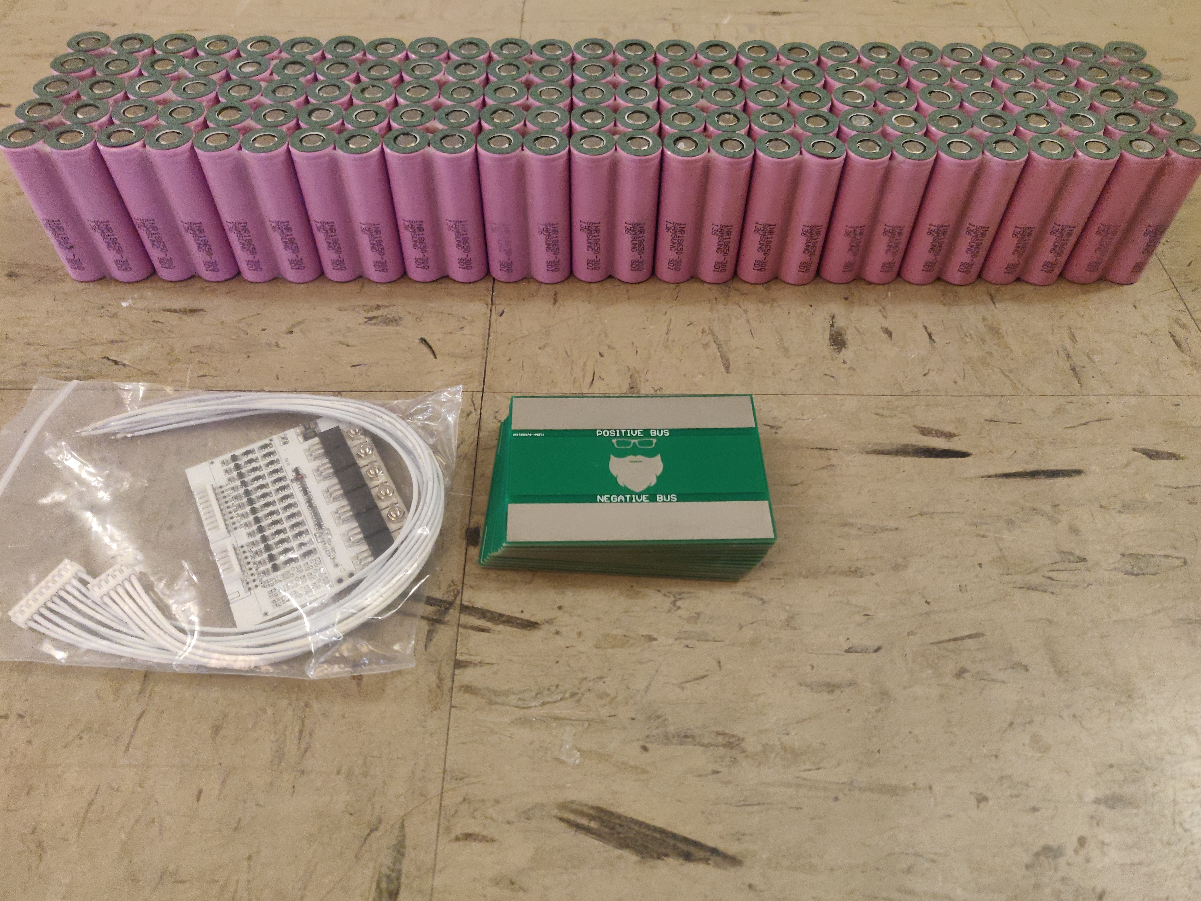

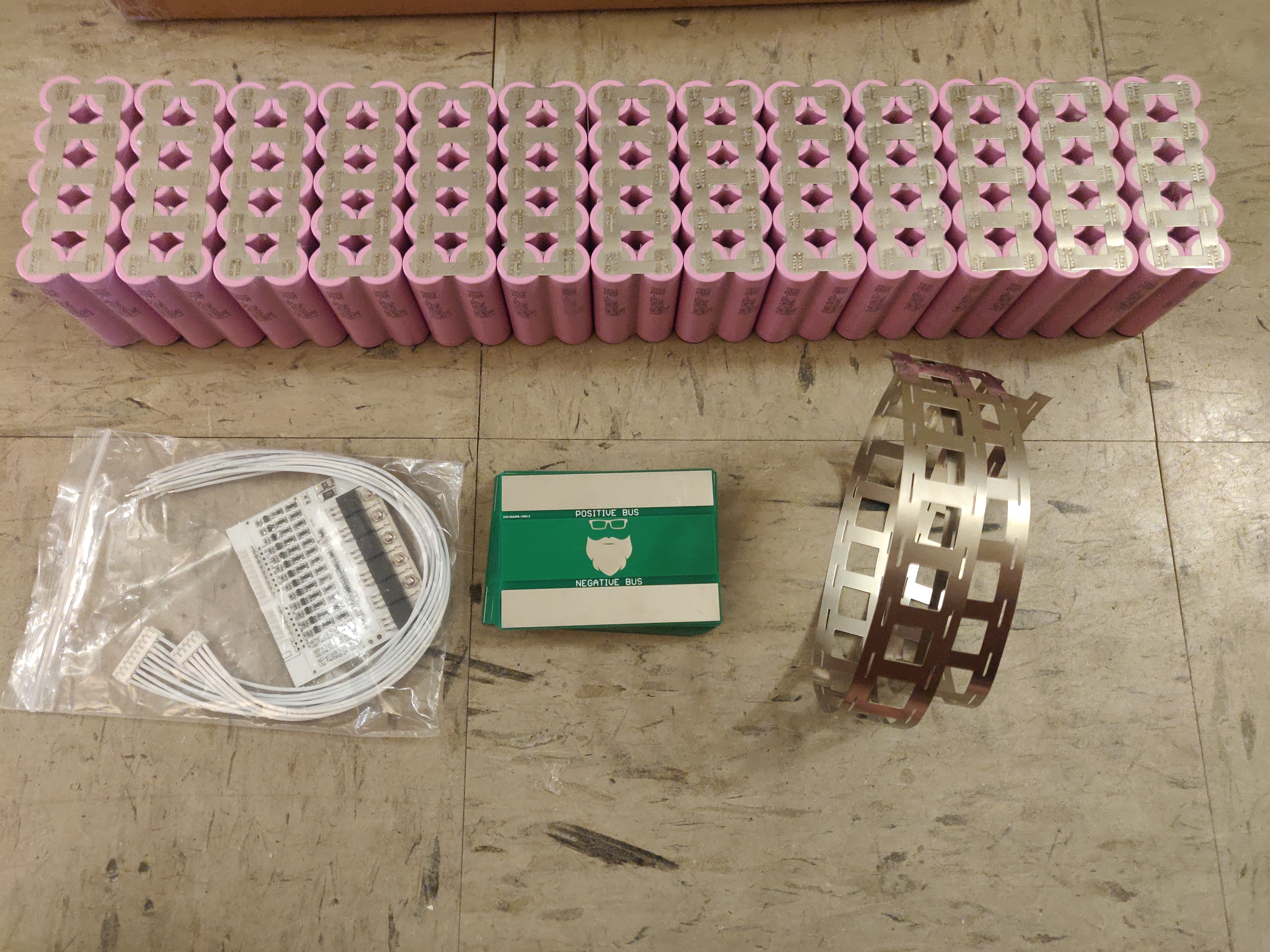

13s10p pack (Unassembled for sale) + hummie deck and extra's
So ive decided to go a different route with the batterie’s on my build so im unloading all this stuff, comes with D140 13s, 2.8ft of pure 2P Nickle, and 13 5P cell PCB’s

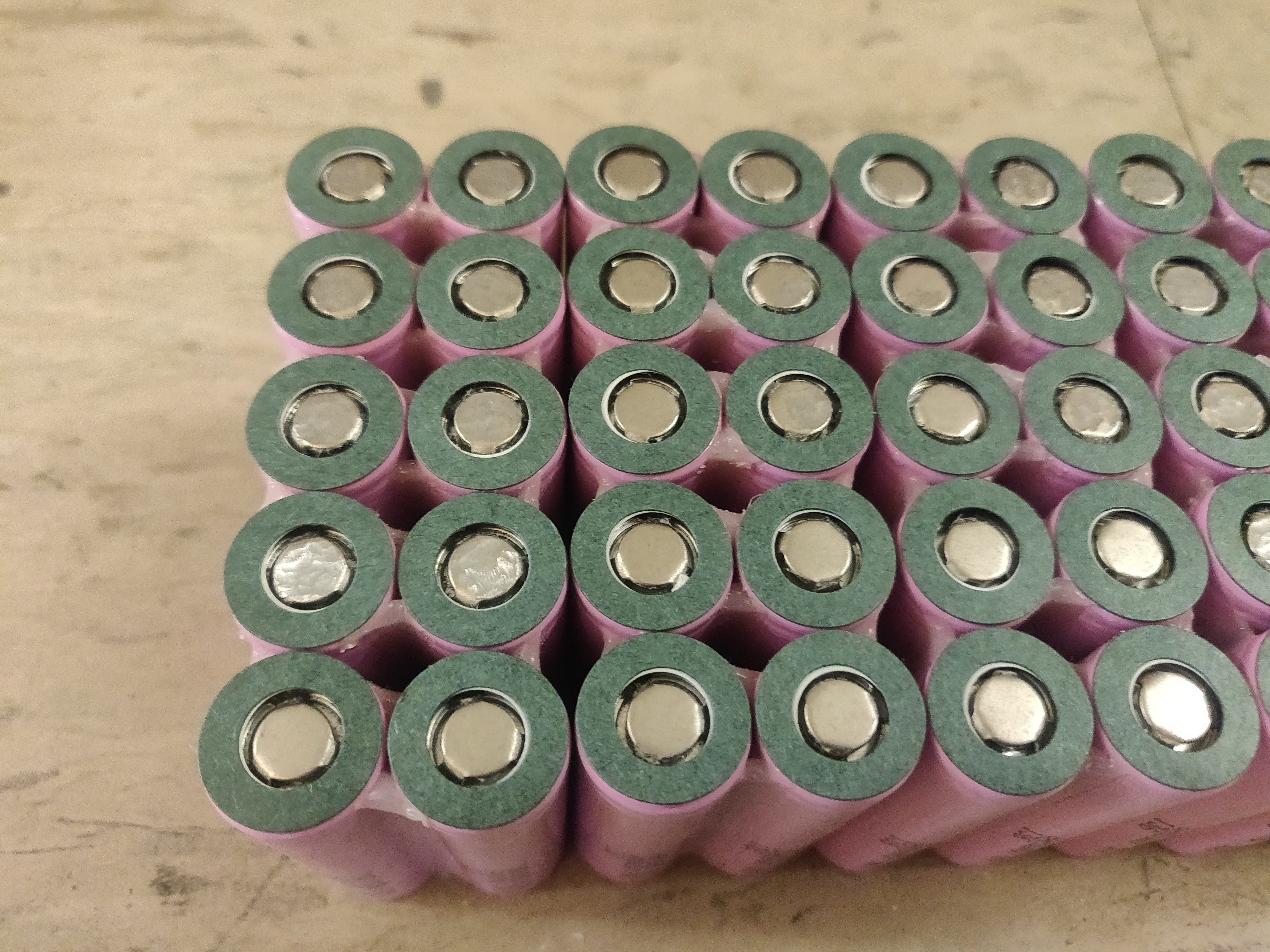

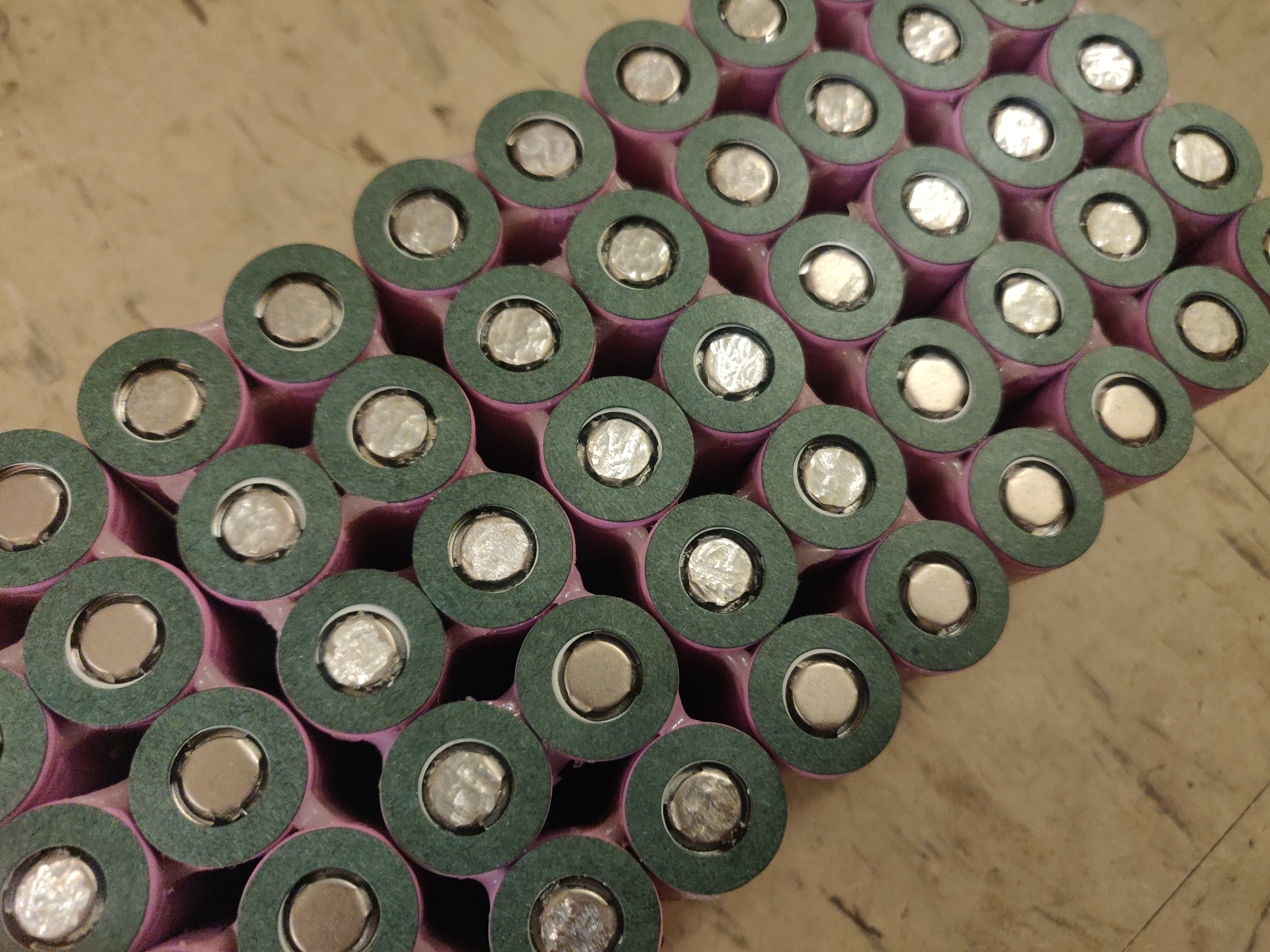

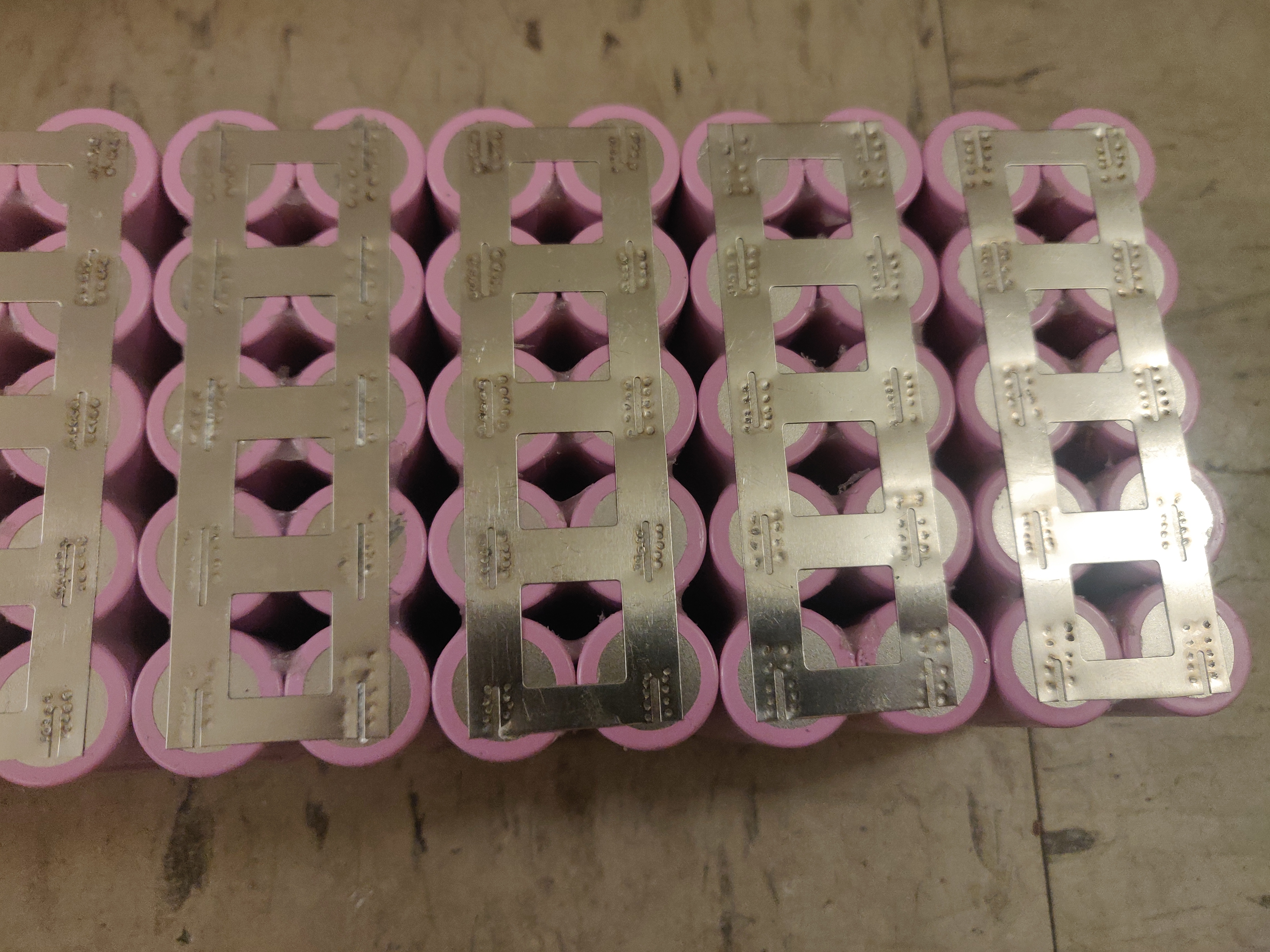

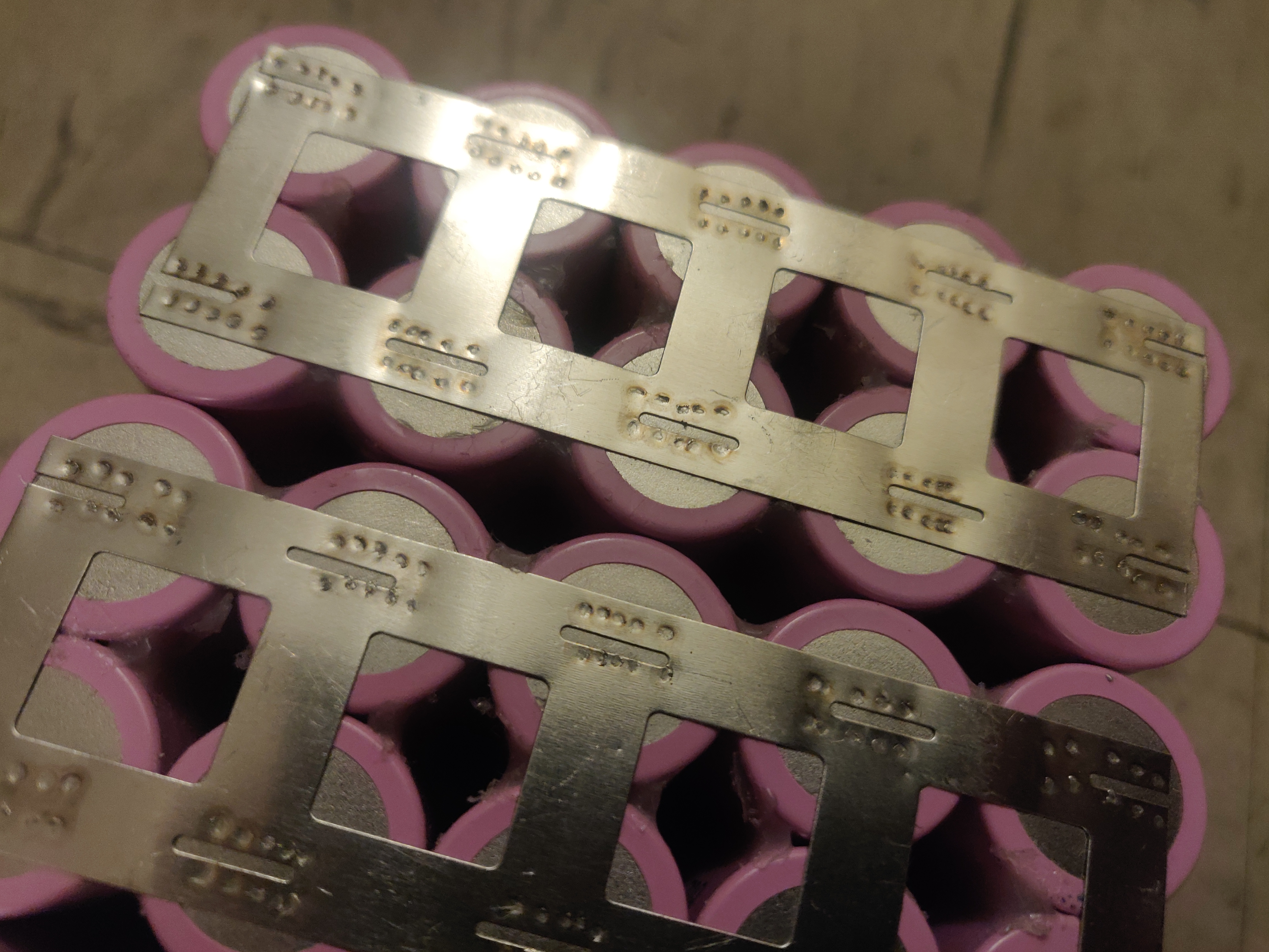

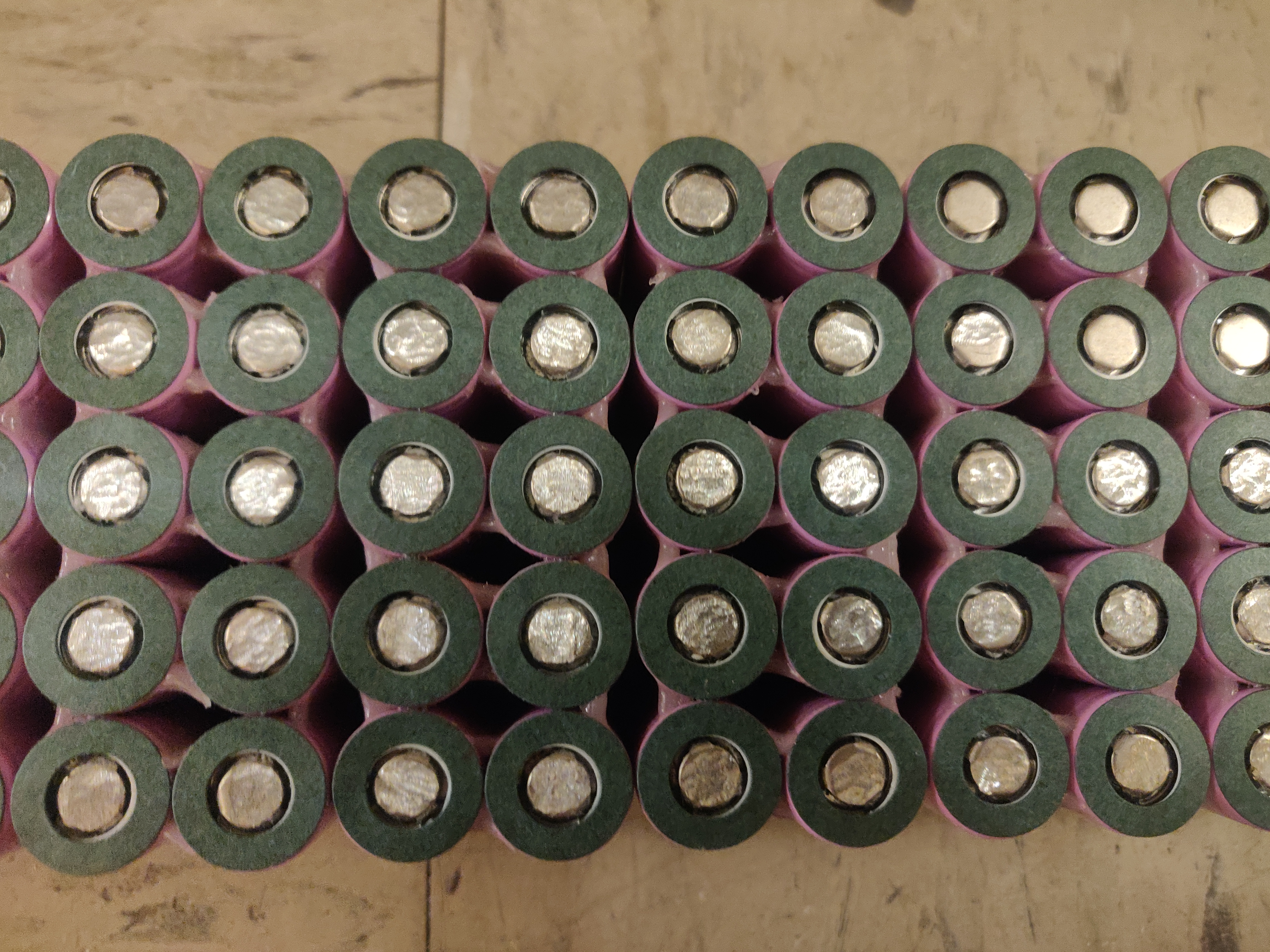

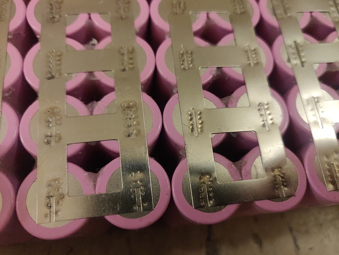

Price is 435 shipped, cells have never been charged or discharged, the top surfaces of cells have been cleaned with a Dremel as I was not satisfied with the weld’s I had, 2 groups have also had cell bottom’s cleaned for the same reason, the nickel strips on the bottom have scratches over them from moving around on my work surface.

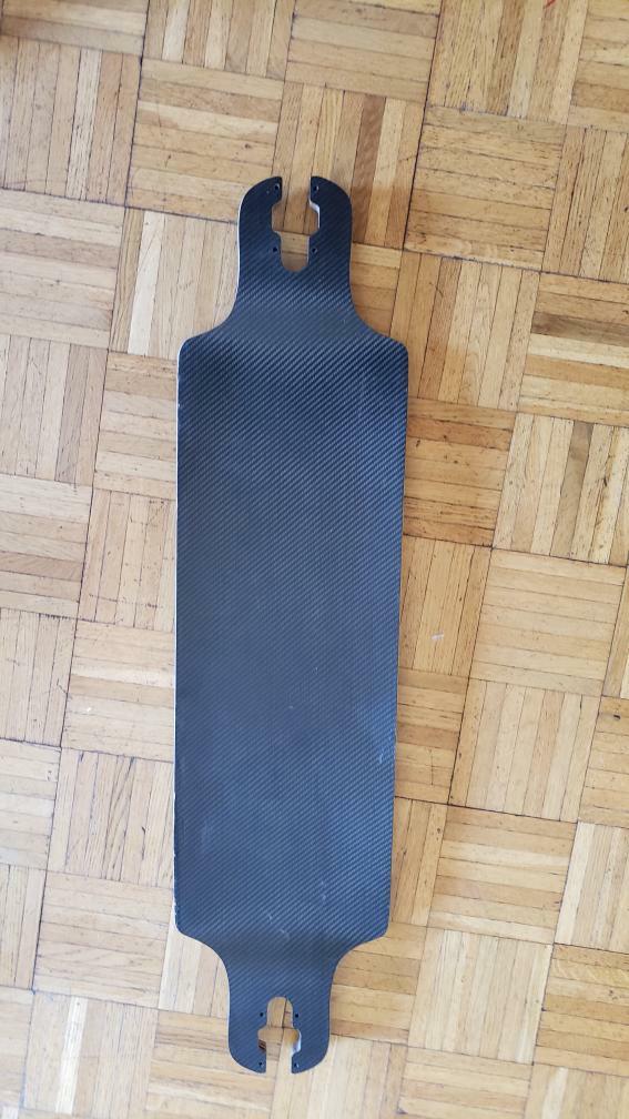

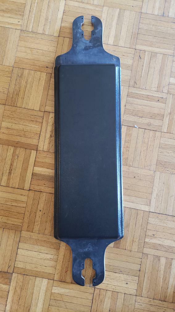

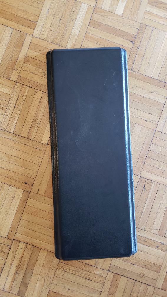

Am also selling my hummie deck and an enclosure made by @Psychotiller to fit the cells (only selling if purchased with cells) **note the enclosure turned out to be slightly wider than the deck.
Price is 160 + shipping from @Sender
Deck and enclosure are currently over @Sender’s place, I would recommend getting the deck skinned.
**only selling deck along with cells.

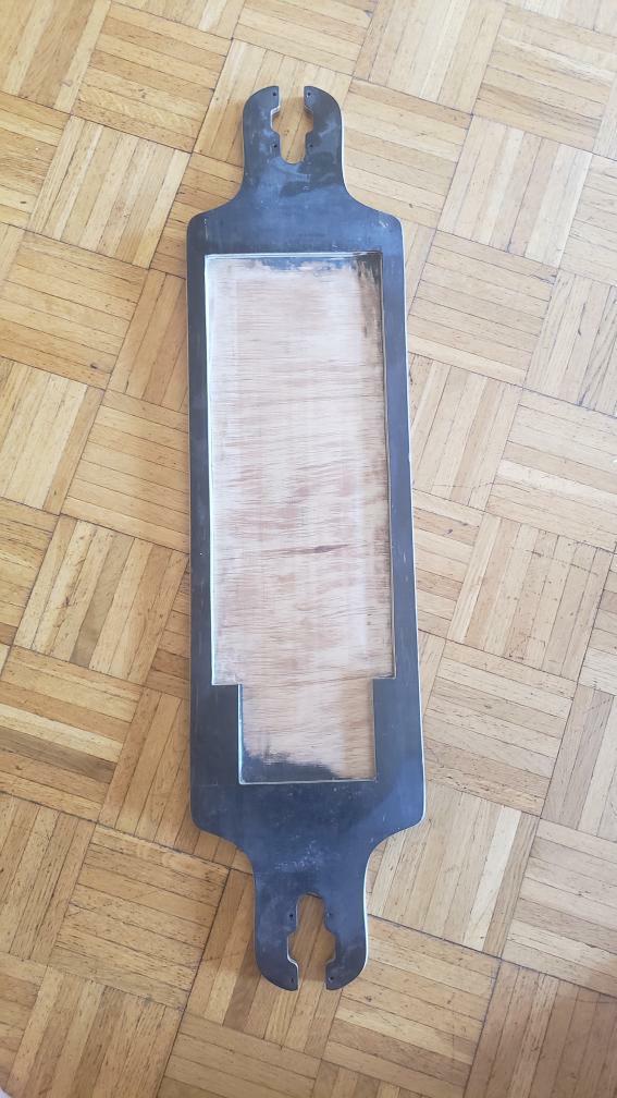

@AlanZhou the cutout in this deck makes this deck unusable as it is, no?
How wide is the remaining part of the deck? Looks like it is uneven, different widths on either side? With the enclosure insert holes going into this remaining area I’m pretty sure that it will not hold up as is. I think it needs to be understood that if you’re buying this deck you’re buying something that needs a lot of work. Additional layers of carbon fibre on the underside perhaps?
Unless of course you only weigh 30kg…
I know this is harsh on you for sale thread but better to look at the solutions before someone gets hurt.
It definitely needs to be reinforced with FG in the cavity and likely layer of CF on the bottom as well. After that it should be fine.
Actually with the cutout it supports my weight without a problem even jumped in the middle a few time’s, the reason I mentioned skinning is because I don’t think it will hold up to a 180+ LB riders with road abuse.
Well if for whoever gets it, it will be shipping out from my place anyway because it is already here. I can go ahead and do this for someone if they want.
I’m going with sender on this one.
That’s alot cut out. My hummie Deck without wood removal had flex
Cant imagine what this would do with an adult on it.
Second this, and mine with way less material removed cracked in all 4 corners
The cutout dimensions are
200~ x 460~ x 15
After @Sender finishes with a deck, strength is an absolute non-issue. It will be super-strong.
(But I’d assume that process will likely be an additional cost.)

You went 2mm deeper into the cavity? Through the CF supportive layer?
No? 15mm deep is the original dimensions
Where are you located? Another person might want 100 cells
Nah, it is just wider.
