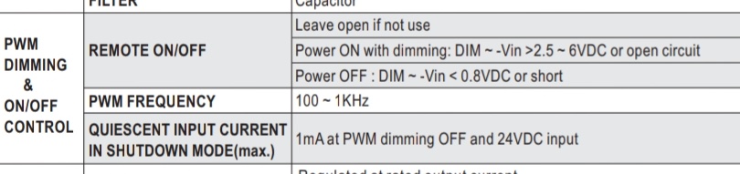

Are there controls? I see a variable voltage output but no knobs or buttons.
edit: Oh damn it has pwm control? So one of those knobs with 3 wires coming out of it? :sweat_smile:
Yeah it has pwm control, I don’t think a simple knob would work though
