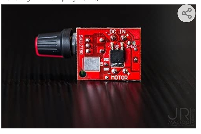

A dimmer would still be nice. How does this one look?
it needs 100-1khz switching freq, that knob is 10khz, not sure it would work
You sure they didn’t mean 100khz-1khz?
Look on Digikey they are a electronic distribution company here in the midwest, have everything under the sun. Might have what you need they have great customer service.
hmm dunno, also that’s not just pwm knob it does the current control, wouldn’t work
Now I’m wondering if this knob could be used instead of the meanwell. So many ways to light up a board I love it.
