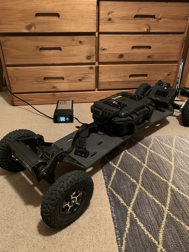

Pelican storm iM2050 fits an 18650 12s8p NESE Pack and BMS perfectly

We just got this finished last night, 12S8P, Smart BMS and decent charge port in a pelican 1200 case
There is pretty much no extra space in the case, there is around 6mm between the top of the battery and the case. I posted it here:
