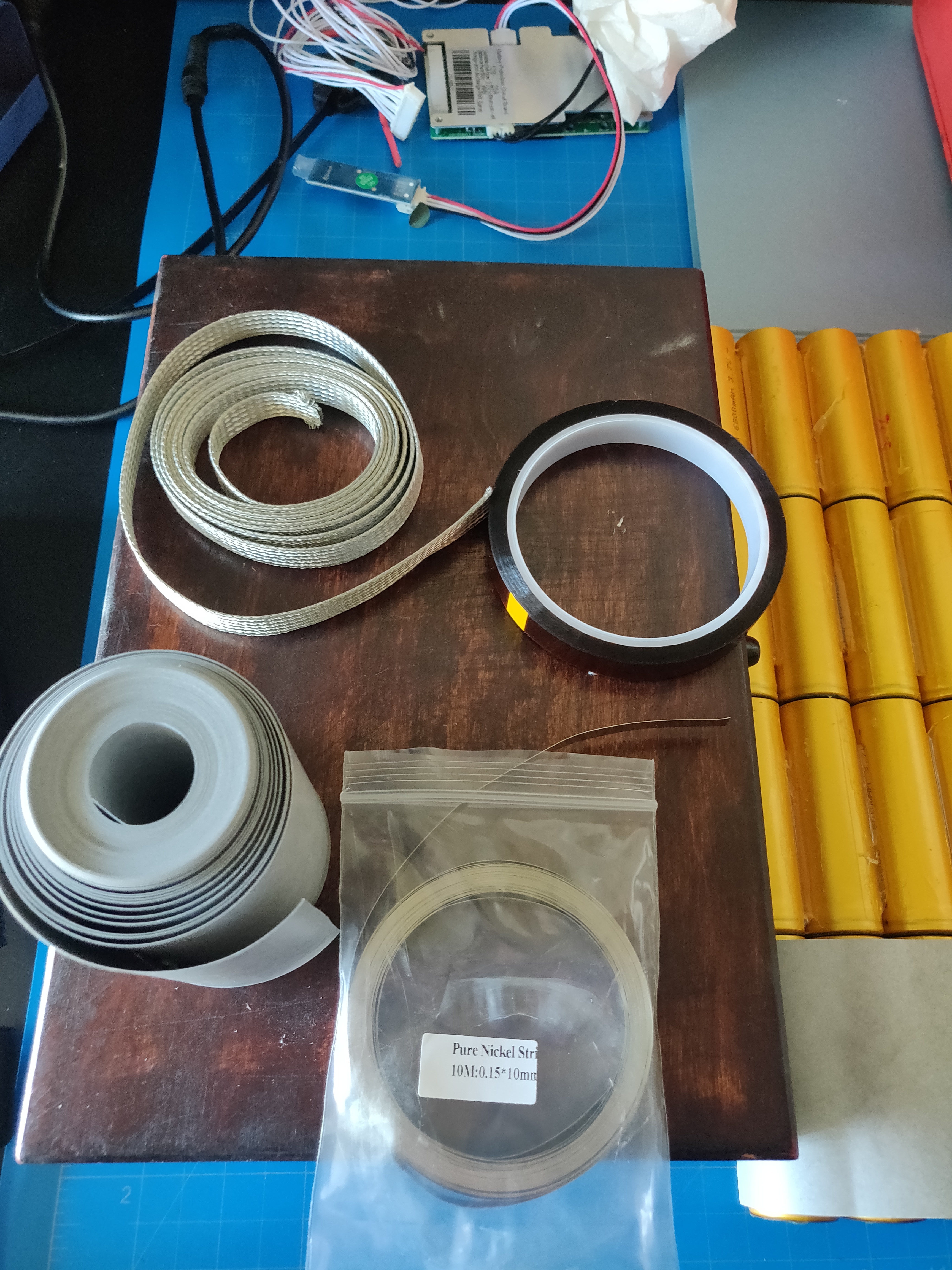

Alright small update. Got my materials. Got everything siliconed properly. Had to redo it because the other silicon I used wasn’t clean and I wanted to to redo them.
Now they all look close to this.
I’m also pretty sure I know what my arrangement will be. I’m going to build it as a 12x7 upright but then folded at 6p. Then lay everything on its side . This way it’ll be harder to explain but it’ll hopefully make for a nicer shape on the deck will add pics as soon as silicon is dry.
The connections will be .15x10mm nickel for the p group (brine test in progress). Then using 1/2" tinned copper braid (9awg equivalent) for the s connections. Probably going to do 3 of these For each s connection. These will be soldered but I’m confident the large cells and p group count should provide enough mass to keep the actual temperature down and not damage each cell. Pretinning everything of course.
I will see if I can solder before welding but that might prove tricky.
The p groups will get one side of fish paper such that each group only has a single layer between them. This is mainly to save space. Maybe someone can tell me if this will be sufficient? @Skyart possibly?

Nice build bro. I’ve got some nice 4 awg tinned silicone wire (the good, USA made shit) if you need some for this, probably overkill, but so is this pack. :stuck_out_tongue_winking_eye:
Single layer of fishpaper should be enough. I would be more comfortable with each pgroup wrapped in fishpaper this would give you 2 layers of protection
Thanks dude! Honestly the ampacity of this pack is only like 100cont 200 burst. Not exactly astronomical but the 3x 9awg should be sufficient. Thank you for your offer though!
Hmm ok. Well I have enough fish paper to do either. I’ll see how dense I can get it with two Layers.
Il send you some pics when I get home you can still get it pretty compact, if you wanna stagger those cells
Maybe pics are not necessary lol. When you wrap the cell with fishpaper, make sure you push as much fishpaper as possible into the grove between the cells, this will let you get them closer together
