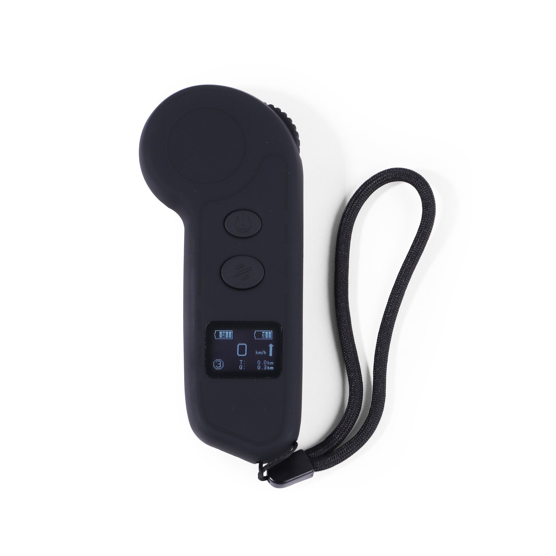

Looks like there are three RS versions and two standard versions on the bottom. Can you share pics of the Standard version remote?:raising_hands:

Standard ghost is using standard hobbywing remote, but remote upgrade will be an option for the standard ghost too, still undertest. Rs remote is share the exway rexus remote as the Phantom x.

Oh so it’s this remote then? Not the same as the newer linnpower and Acedeck JK remote.
yep.

the remotes should deserve some attention too
Agreed. This board deserves a much better remote but looks like Rev is working on that. I was hoping it would have a JK ESC so it would have the radium mach one s remote. Either way I think the Iris remote from OMW should work with this board since it works with hobbywing.
