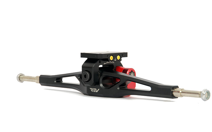

What is this red L-shaped component on the trucks?
The red part you saw is arm, connecting the bushing kinpin and the hanger.
Thats interesting, never seen that before! I presume it allows for a lower ride height?
@That_Jamie_S_Guy
Regarding this Truck, the width is 468mm and the weight is 1250g. This is our latest patented Truck SAT(swing arm truck systerm). The features of this truck include the use of three types of bearings: thrust bearing for hanger kinpin, spherical bearing for bushing kinpin, and ball bearing for back support of the hnager. Because of the design of these bearings, the movement trajectory of the entire truck is very precise (NO extra wobbles during the movement) and the rotation is very smooth.
As shown in the picture, the PU is positioned horizontally. The horizontal PU allows for freer steering and prevents the PU from being affected by weight, unlike traditional RKP truck . This enables you to use softer formulas to achieve the same stability without losing flexibility.
At the same time, to prevent wheel bite, we have incorporated physical limiters within the cable truck, with a maximum rotation angle of 28 degrees on each side. Our truck also supports angle adjustments, accommodating angles of plus or minus 10 degrees. Including the angle of the deck, the maximum angle is 40 degrees and the minimum is 20 degrees, with a default setting of 30 degrees. A larger angle makes the cable tray more flexible, while a smaller angle provides more stability.
EVERY PART YOU SAW IS MILLED 7075-T6 ALUMINUM
Bushing Support by @RipTideSports

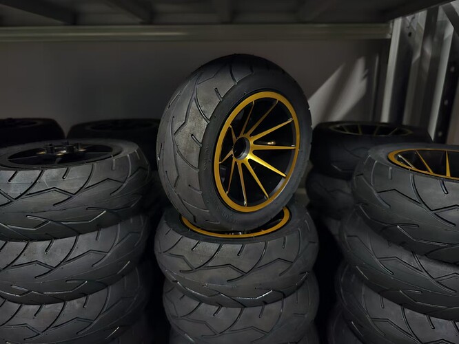

For the Rim:
  • Material: Our wheel hubs are made from 7075 aluminum alloy, known for its superior strength and durability.
  • Two-Tone Anodizing: We utilize a rarely used dual-color anodizing process in the industry, with a gold outer ring and a black inner ring for a sleek and premium look.
  • Lightweight Construction: To enhance handling and reduce weight at the ends of the trucks, the hubs have been meticulously optimized for extreme lightweight performance. The total weight of the hub, including bearings, is only 430g.
  • Dimensions: The wheel hub measures 136mm x 70mm.
Support street tyres/ knobby tyres

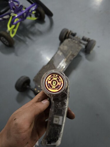

For the remote:
We have partnered with Exway to adopt their Rexus remote control for our boards.
Touchscreen Display: The remote features a touch-enabled color screen that displays essential * information such as speed, mileage, and battery levels.
  • Customizable Themes: Users can personalize the remote with various color themes.
  • Dual Throttle Modes: The remote supports two throttle modes for different riding preferences.
  • OTA Updates: With the Exway app, users can access OTA firmware updates to keep the remote up-to-date.
  • Advanced Features: The remote includes RGB brake sensing, quick reverse switching, and offers a stable and interference-resistant signal for reliable performance.
  • Handbrake Function:Prevent accidental throttle engagement and Keep the skateboard stationary on slopes, preventing unintended rolling.

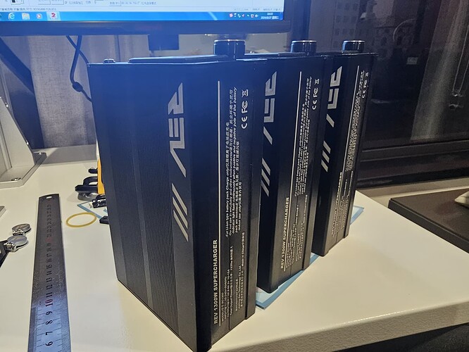

About the charger
  • Standard Charger: A 1300W charger is included as standard.
  • Connector: Supports XT60 plug-and-play design for easy use.
  • Dimensions and Weight: 170x106x55mm, weighing 1270g.
  • Performance: Delivers a maximum current of 15A at 88.2V, allowing the Phantom X to be fully charged in just 2 hours.
  • built-in 65W PD Type-C module inside the battery enclosure, enabling users to charge their mobile devices conveniently on the go.
