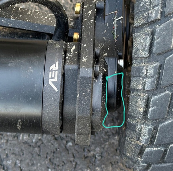

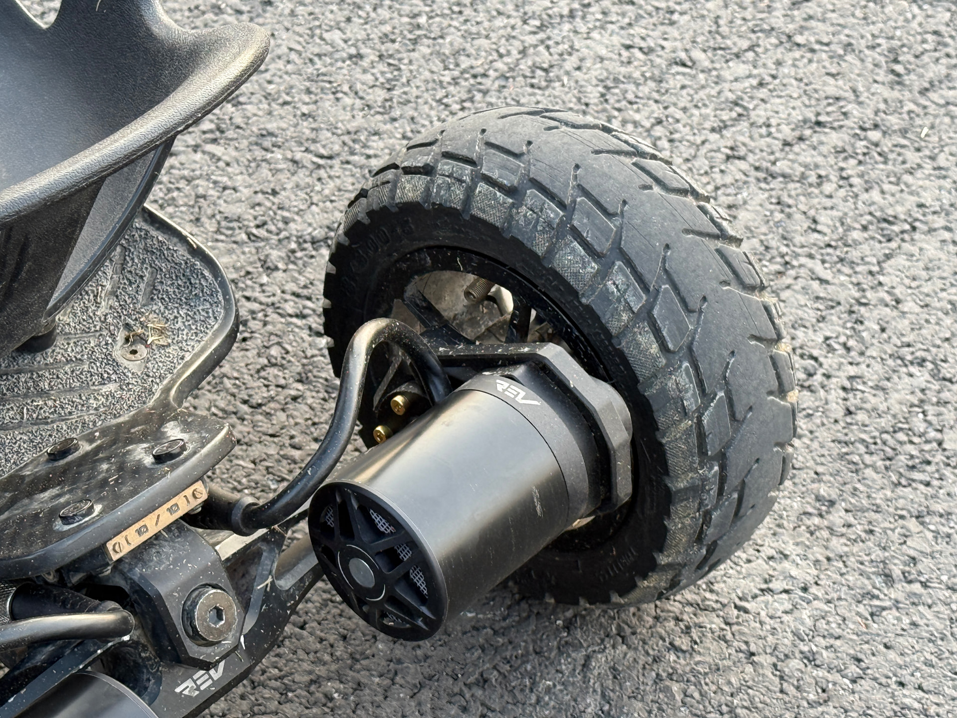

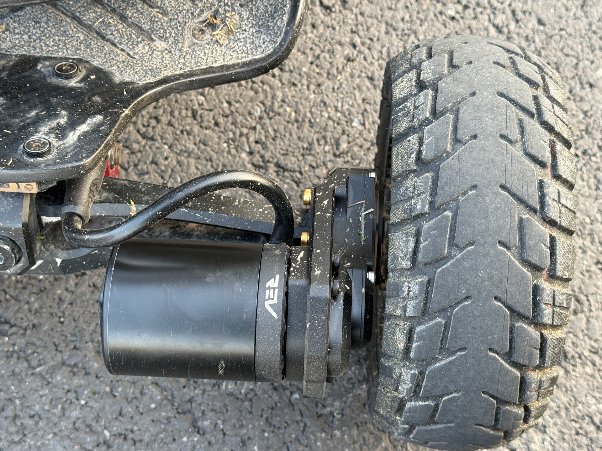

12kw beast designed by Revskateboard
ready for fun
Durable steel but will corrode easily.

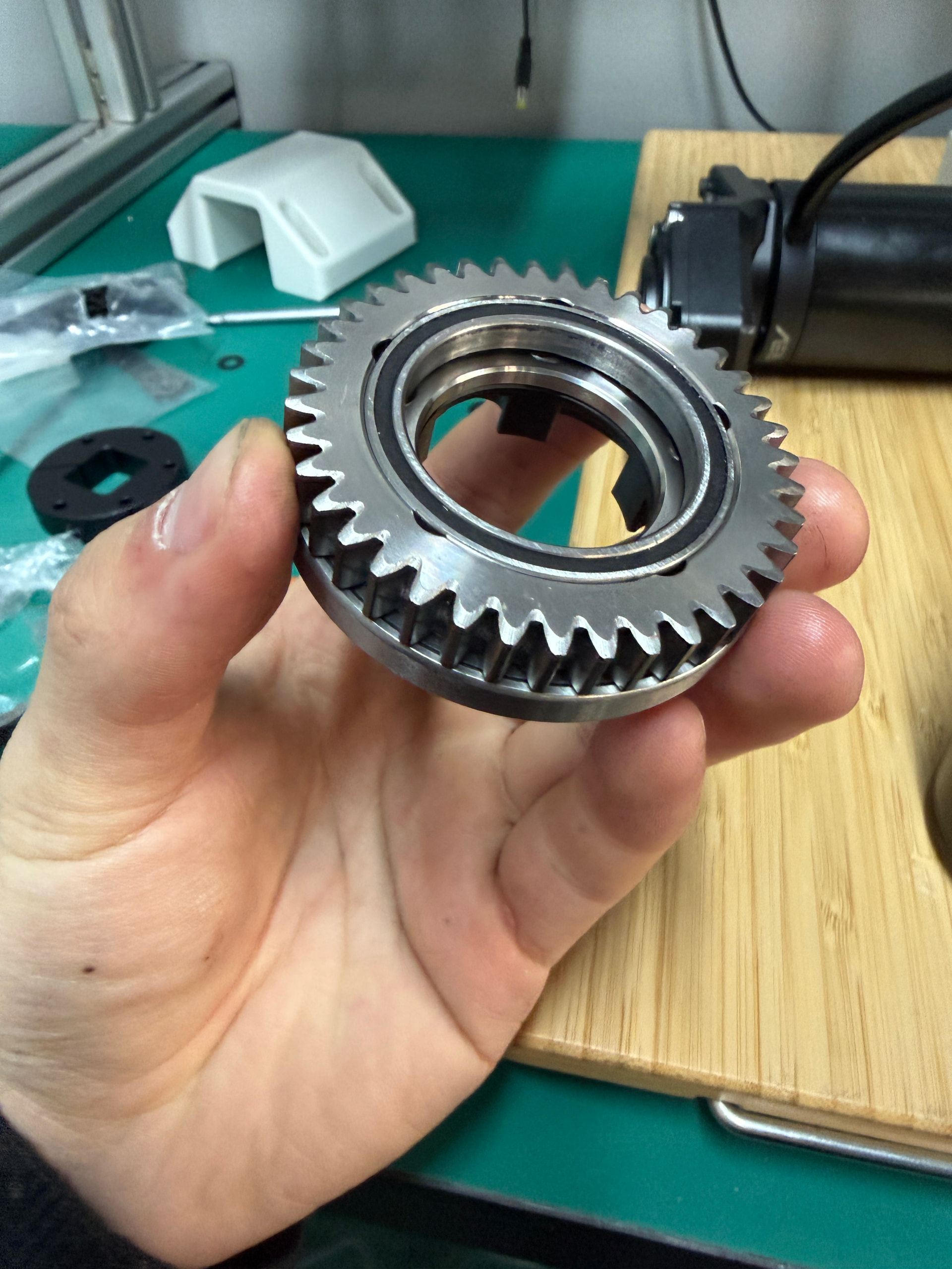

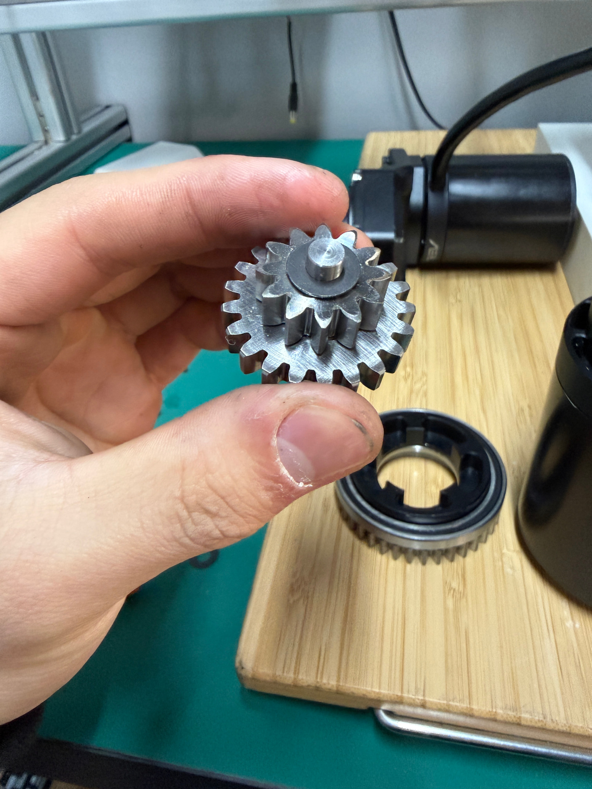

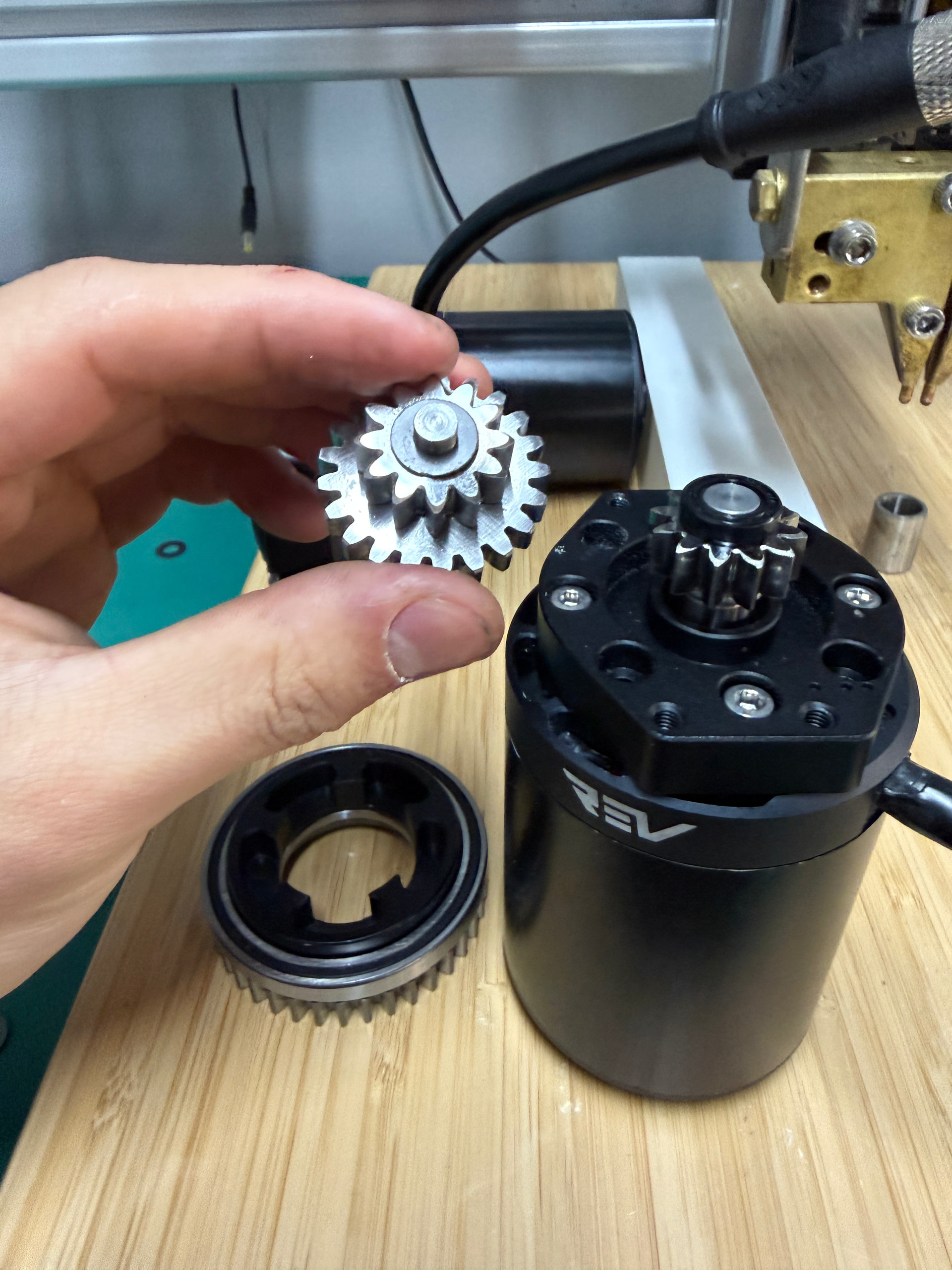

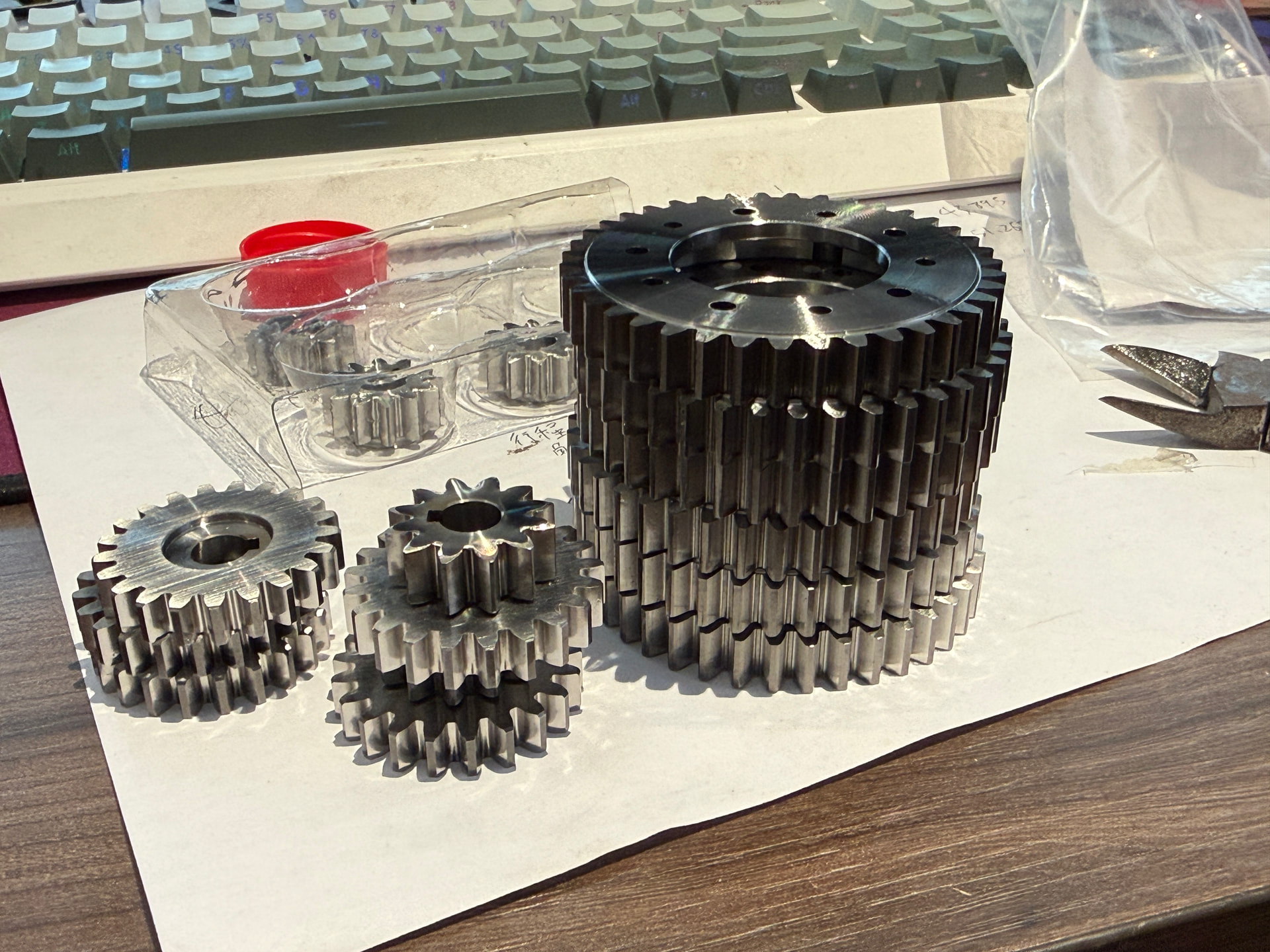

two stage gear finally arrived.
Look @Pecos
this even more quiet than I expected!!
Is this the final version of the product or will there be more improvements?

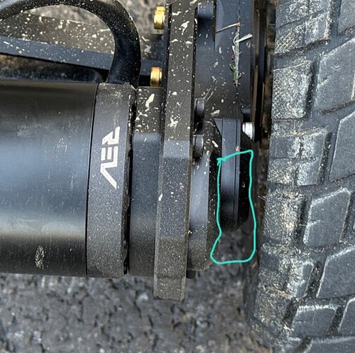

Have you thought about making an encoder mount here?
Could you do 8:1?
I would like this)))
not really…which motor you want to use
I use reachertech 6395 128kV and 20s battery
it could compatible with this drive directly. I don’t think the encoder would fit well. especially different motor has different shaft lengths.

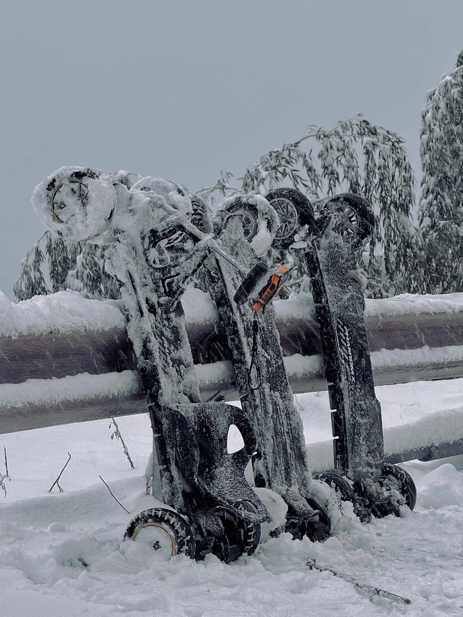

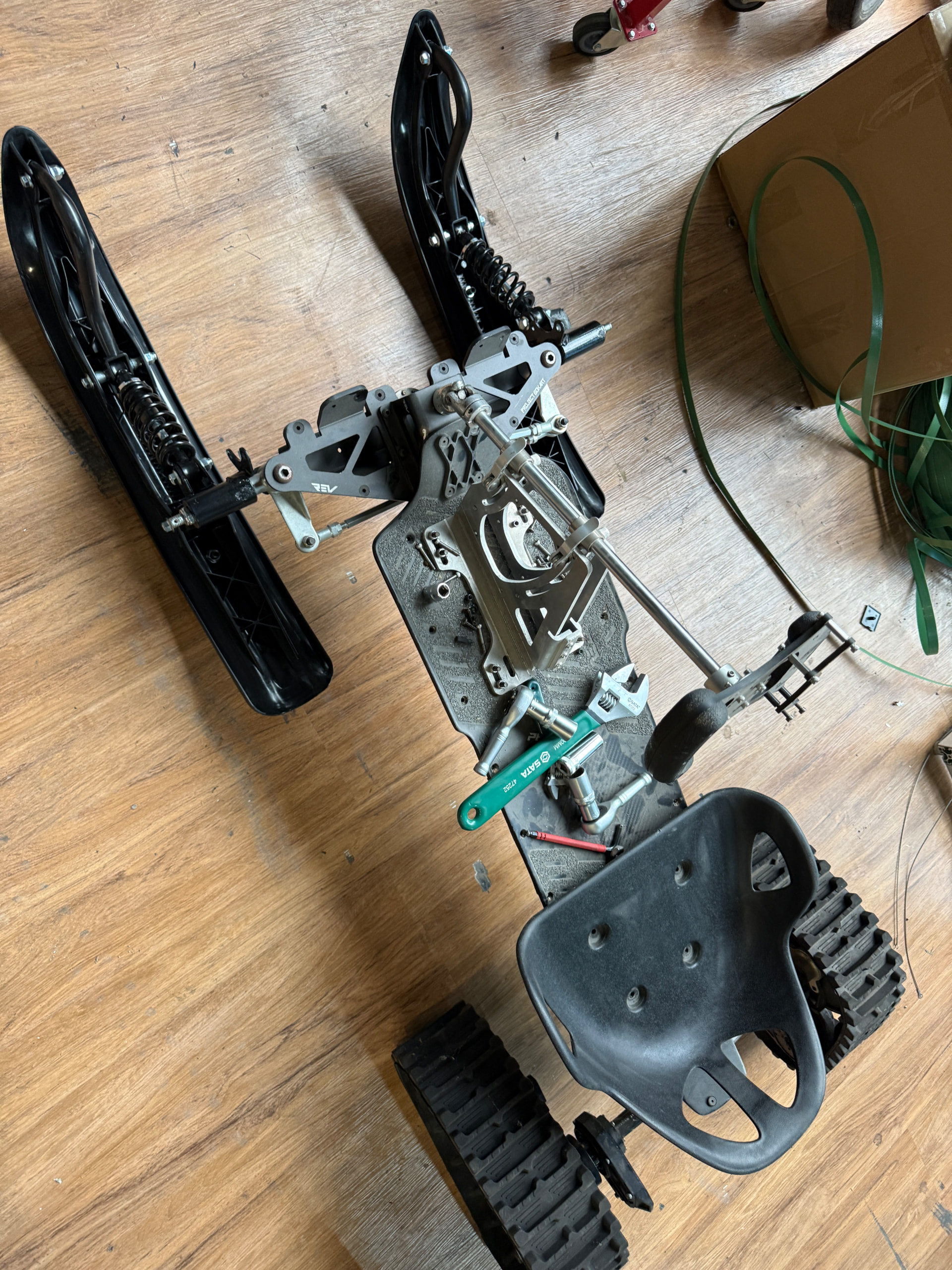

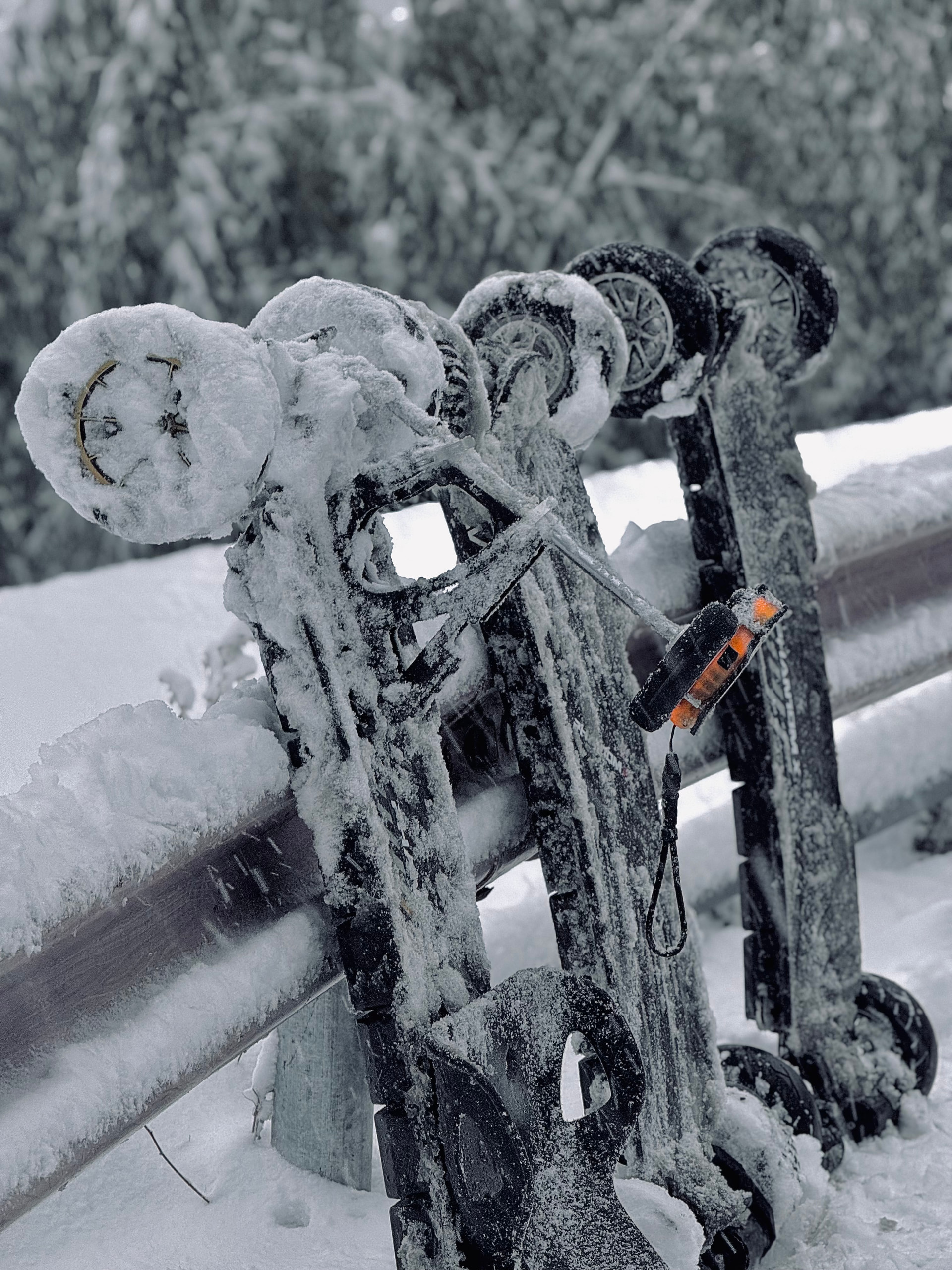

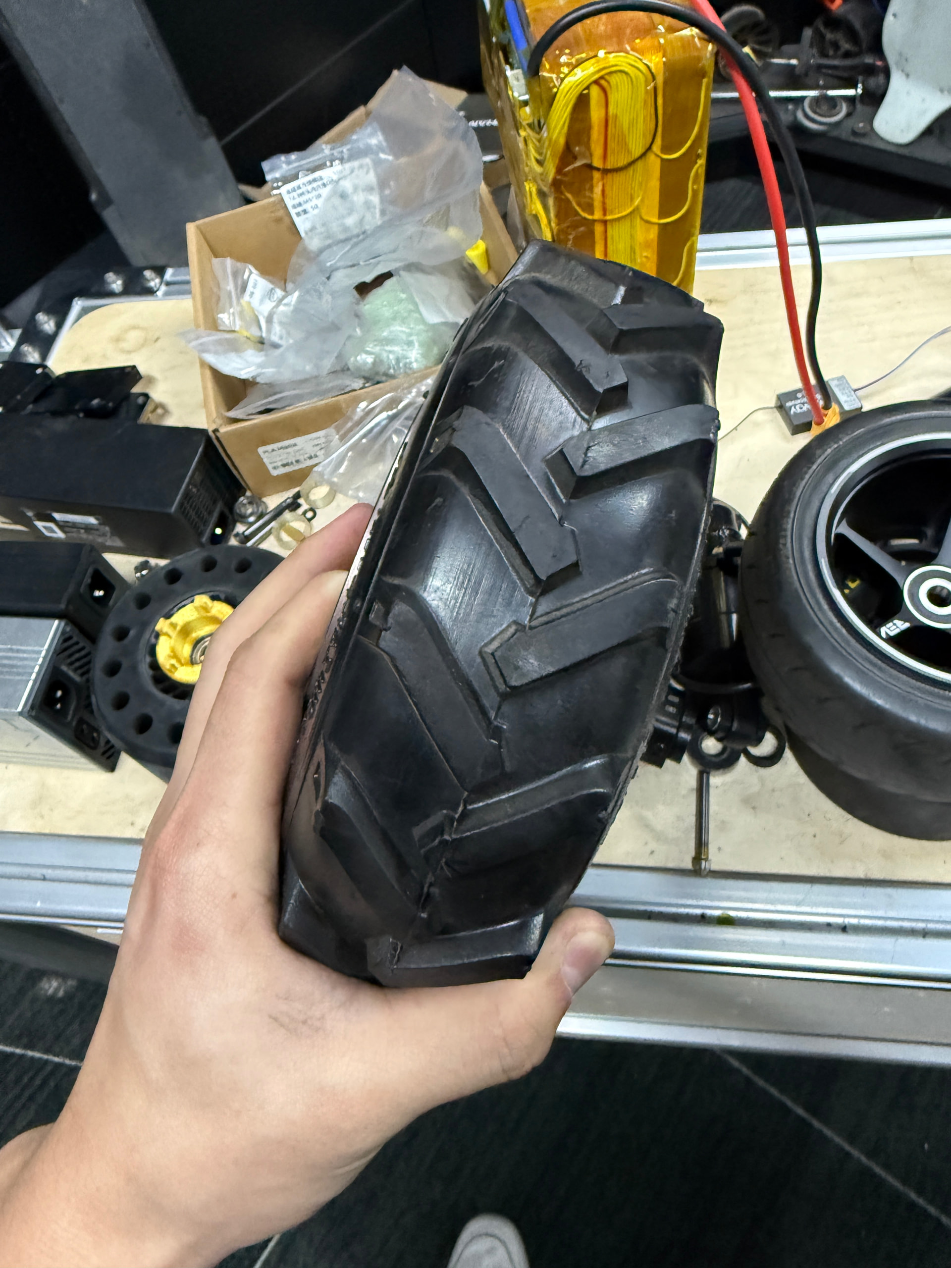

You got any video of these riding in the snow?
So who drew the short straw and got stuck riding the slick tires?
Me, we didn’t expect such big snow out there, lol
I hope you remembered to wear your butt pads…
I had mine on when I ventured into the winter wonderland…

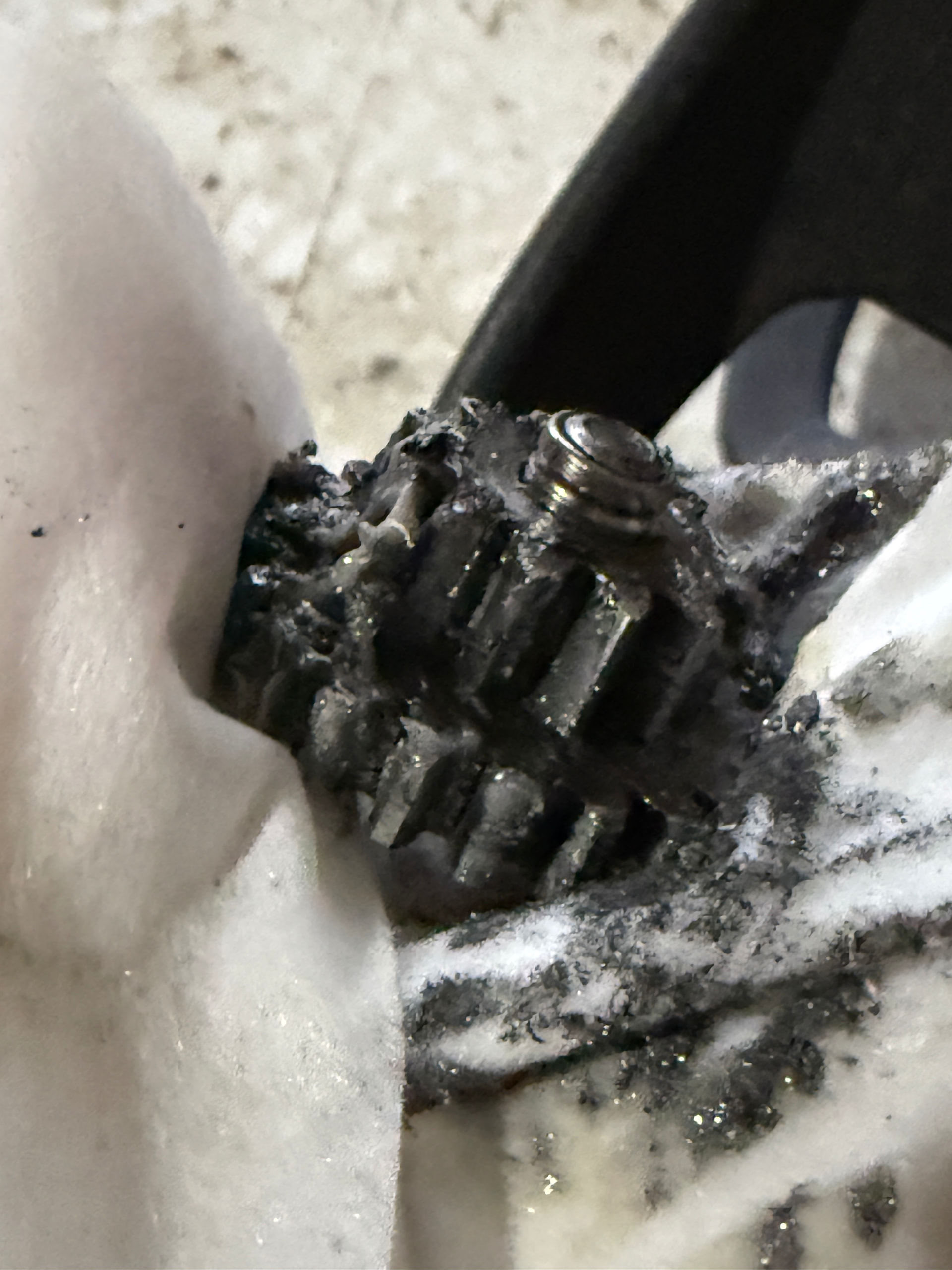

So far…gear seem last fine, but I had some issues with the bearing failed, I need to mill the housing for different model of bearing.
