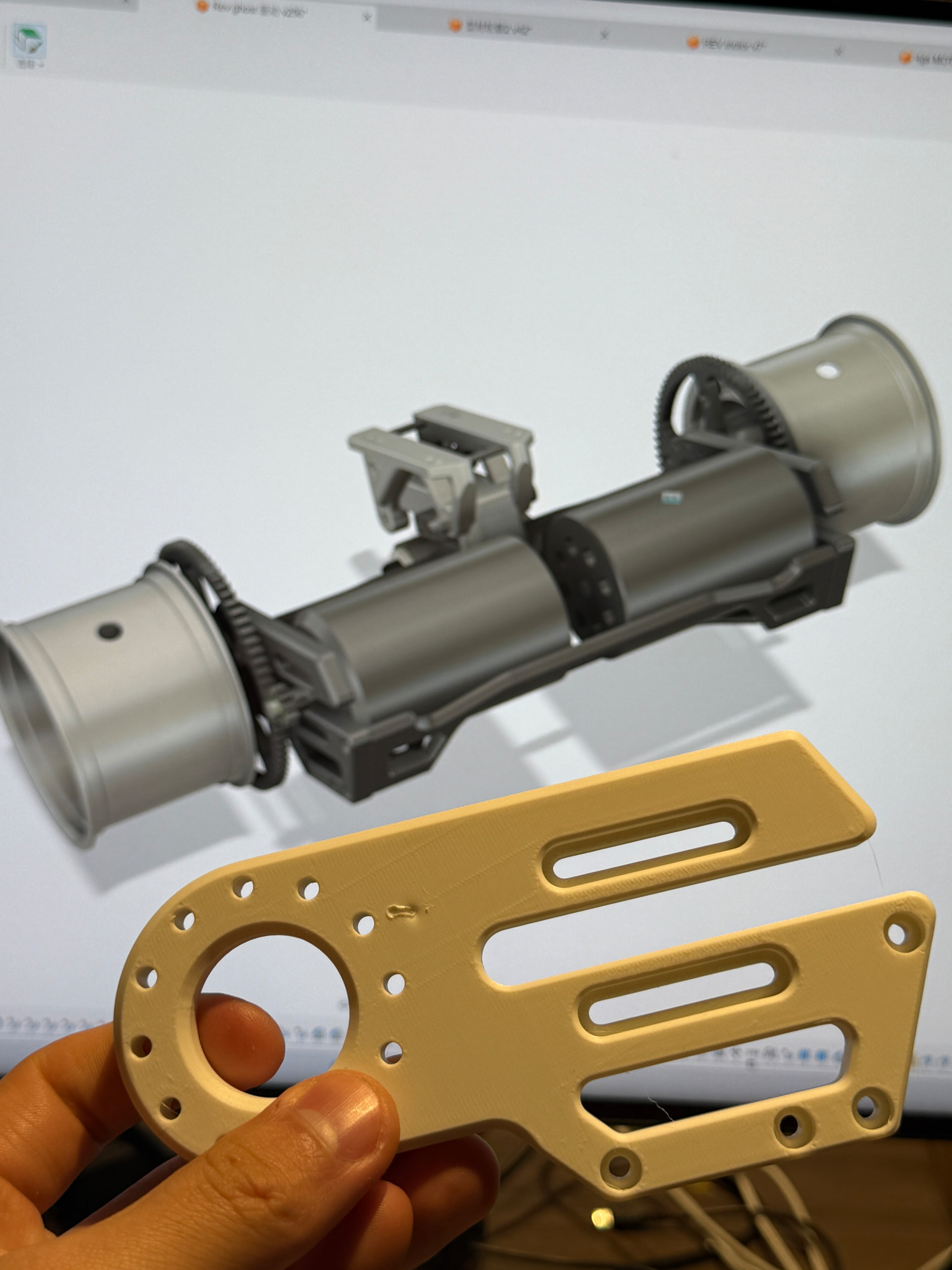

12kw beast designed by Revskateboard
open gear and sss56104 motors on ghost truck…maximum fit 56118 motor.

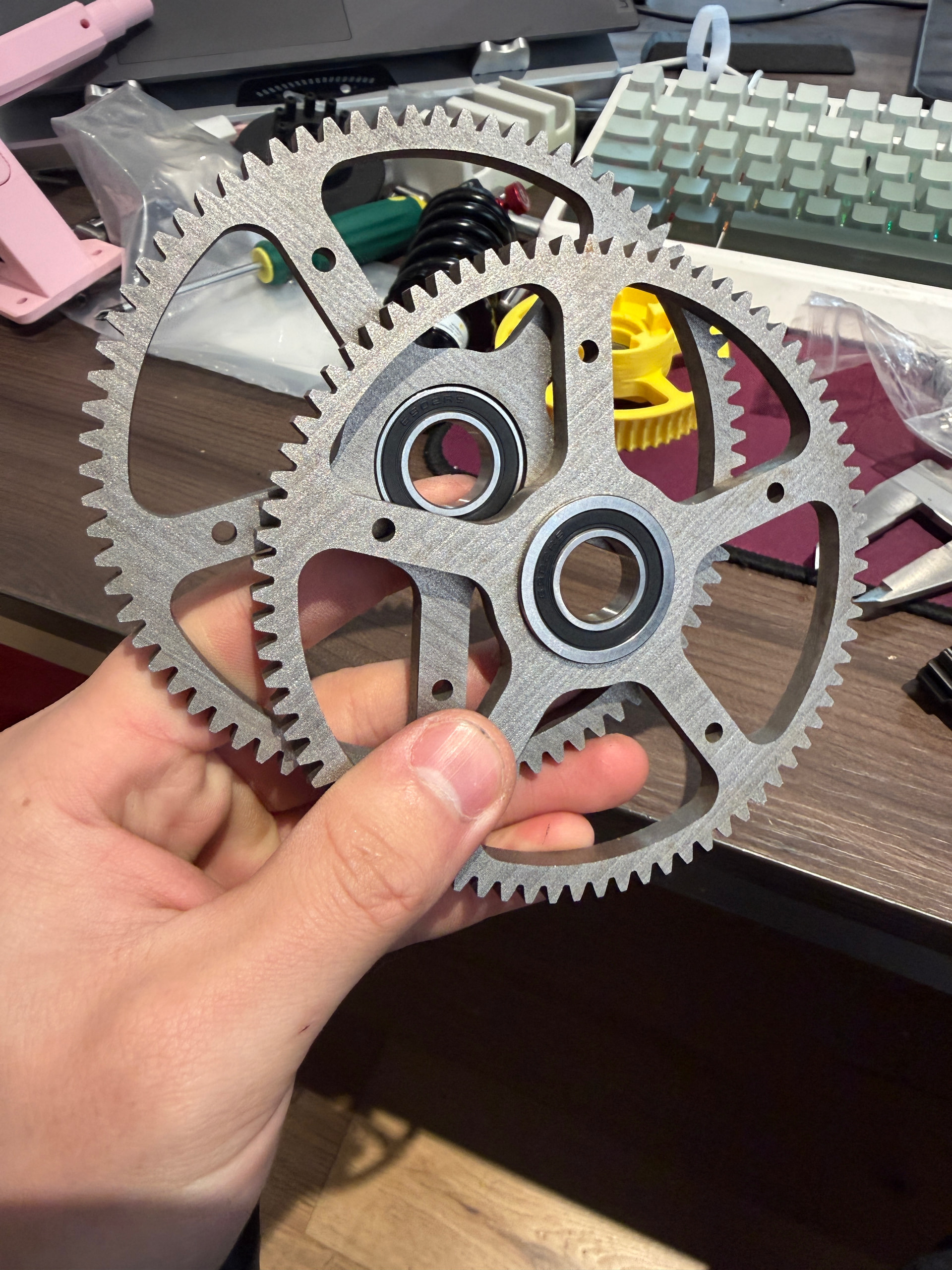

Rack is available $99 for a set

56014,360kv, I think I could make this motor work on my two stage gear drive, my new hanger would fit this. 68t/12t with radium sr125, very good set up

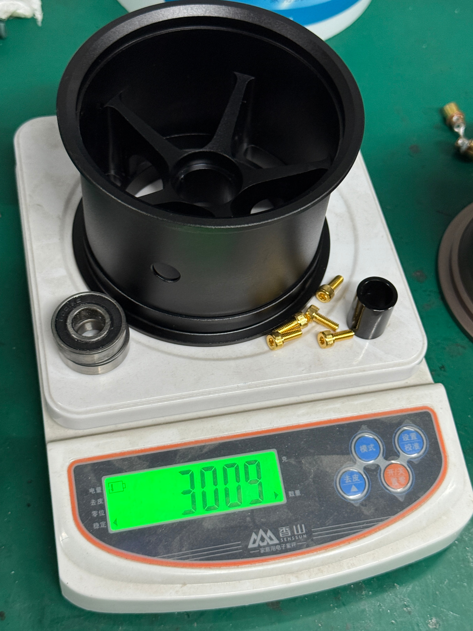

Rim for the Ghost series compare to the master rim
100g lighter per rim.

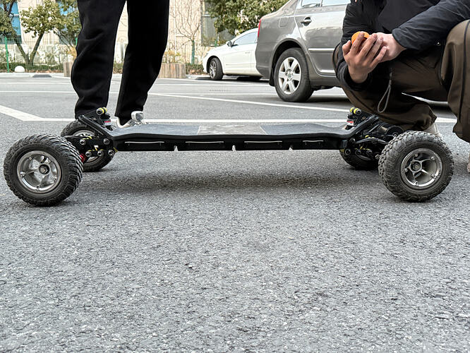

Tuareg series working on progress.
Damn doing exactly this but as a universal solution for mountain board trucks was a dream project of mine.
Best of luck with this! Looks awesome so far
this is an hard work, space and wheel base so tight, also need big travel of the suspension

What material is this? Hardened carbon steel?
D2 steel, HRC60
Whats the tooth count and pitch on these?

open gear just for racing purposes, fit inner runner motor, maximum gear ratio 11/78.
The two stage gear drive is for out runner motor. maximum gear ratio 12/68.
