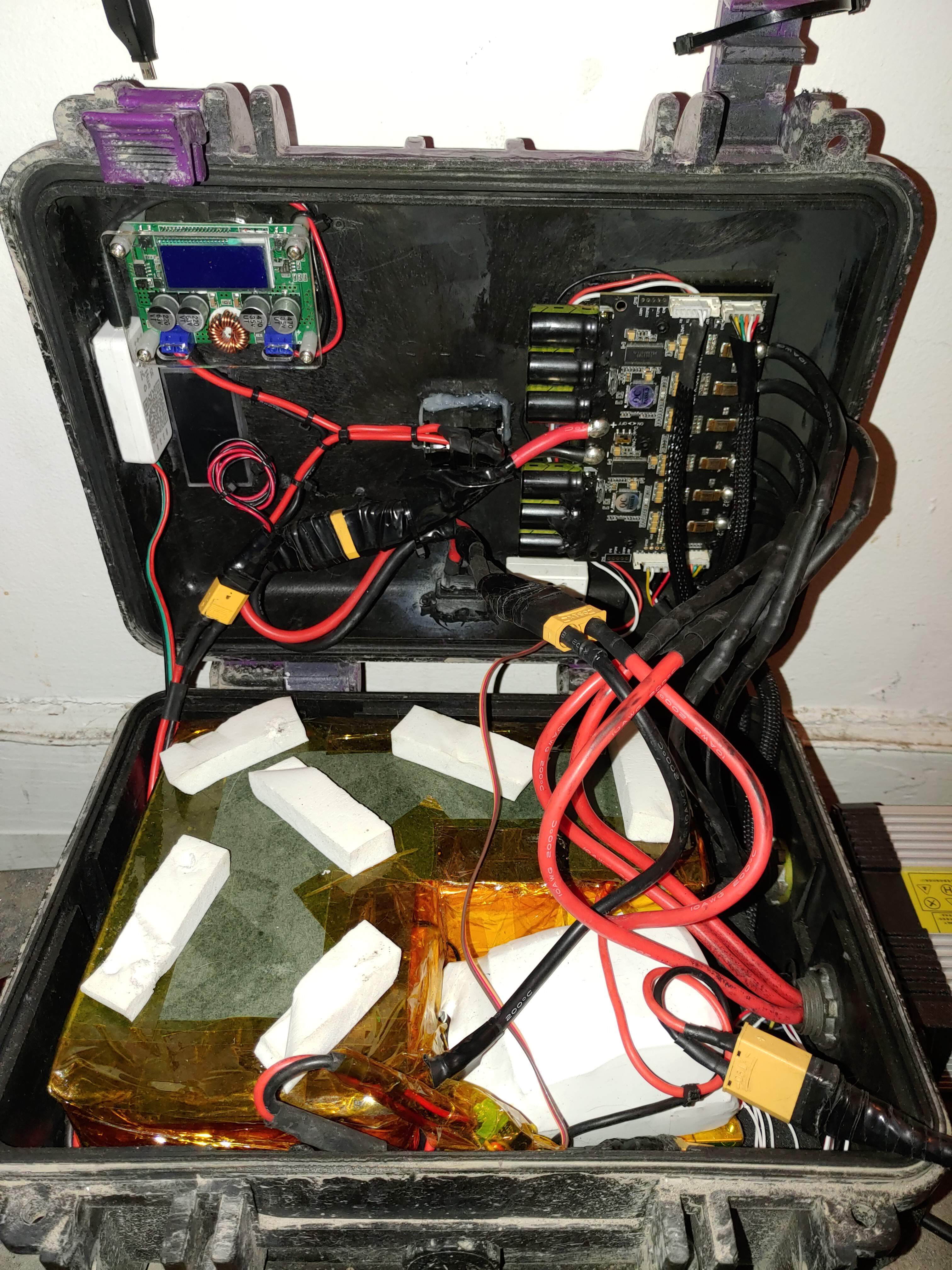

interesting. build like a brick or laid out?
Brick style
Pcb 6p packs 8 on left and 4 on right (bottom right space is used for BMS and accessories battery)
