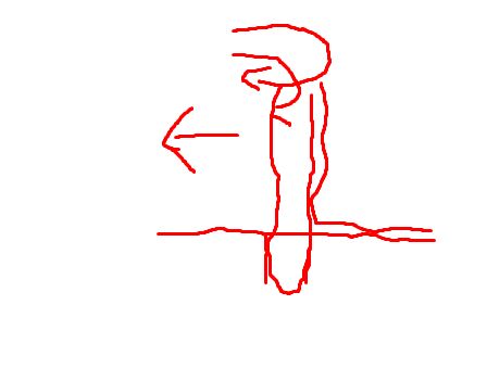

@Pedrodemio I would recommend to use a drill press and turn it by hand. This way you can get it in straight. Unfortunately I do not have one…
I know a method. Pull it to you during the turn. Don’t do it excessively. It’s hardened steel. Check again, if it’s straight with a square.
