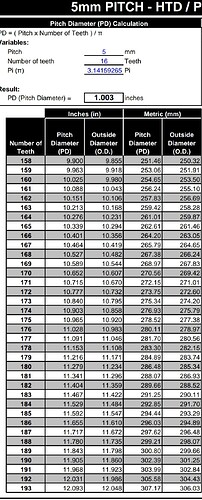

If you imagined the pulley was exactly the same size as the wheel, then pick whatever wheel size, and the torque is the same.
In your example btw, a 90T HTD 5M pulley would have a circumference of ~450mm => diameter of 143mm, or around 5.6 inches. Not bad for a 9 inch wheel or whatever.

*click to expand chart
I don’t follow your logic here…you can’t just change the pulley diameter without affecting tooth count.
that was just a hypothetical example to show that ā€œin an imaginary world where we didn’t need teeth / teeth were small enough to always fitā€, if you scale the wheel up along with the pulley, the torque stays the same, because it’s literally just the torque your belt is experiencing :upside_down_face:
