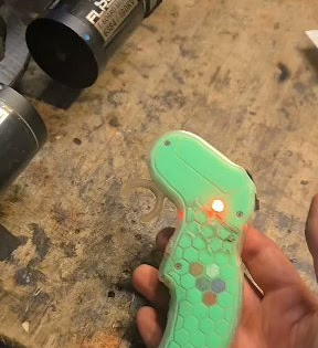

hi,before I search aliexpress for a tiny led battery capacity indicator and try to stick it into the Z.mote I would like you to confirm: the led indicator on the Z.Mote ONLY signals whether it is connected or not to the vesc. Correct?
As far as I am aware, thats correct. Hes never mentioned capacity. Id be interested in doing something similar… Post what you come up with
I’m confused:
ā€œThere’s a single bi-color led to interface with the remote which can tell you the connection status, battery level and the current speed mode.ā€. This refers to the trigger-only version of the remote. I got the last split trigger version and I noticed that once turned on and just before signaling successful connection to the vesc, the led of the remote sends a single flash. Maybe that flesh tells the status of the battery? It seems to me that such a signal has always been blue, but maybe I’m wrong and at low battery maybe the color of that flash changes. These are only conjectures, does anyone know more about this?
Ive seen Blue,Purple,Red. I have not had the battery go low as of yet so I can assume it would flash red for low batt but no indication of what % it is
He just sent me this email with the functionality of the LED.
"If you click the right button momentarily, the battery check function will take over for about 2-3 seconds. After hitting the right button, the color you see will indicate the battery percentage. Blue color is over %70, purple is between 30-70, red is 10-30 and flashing red is below %10. "
And in regular use, red is slow mode, blue is fast mode

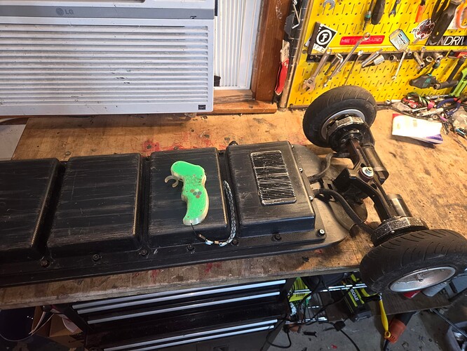

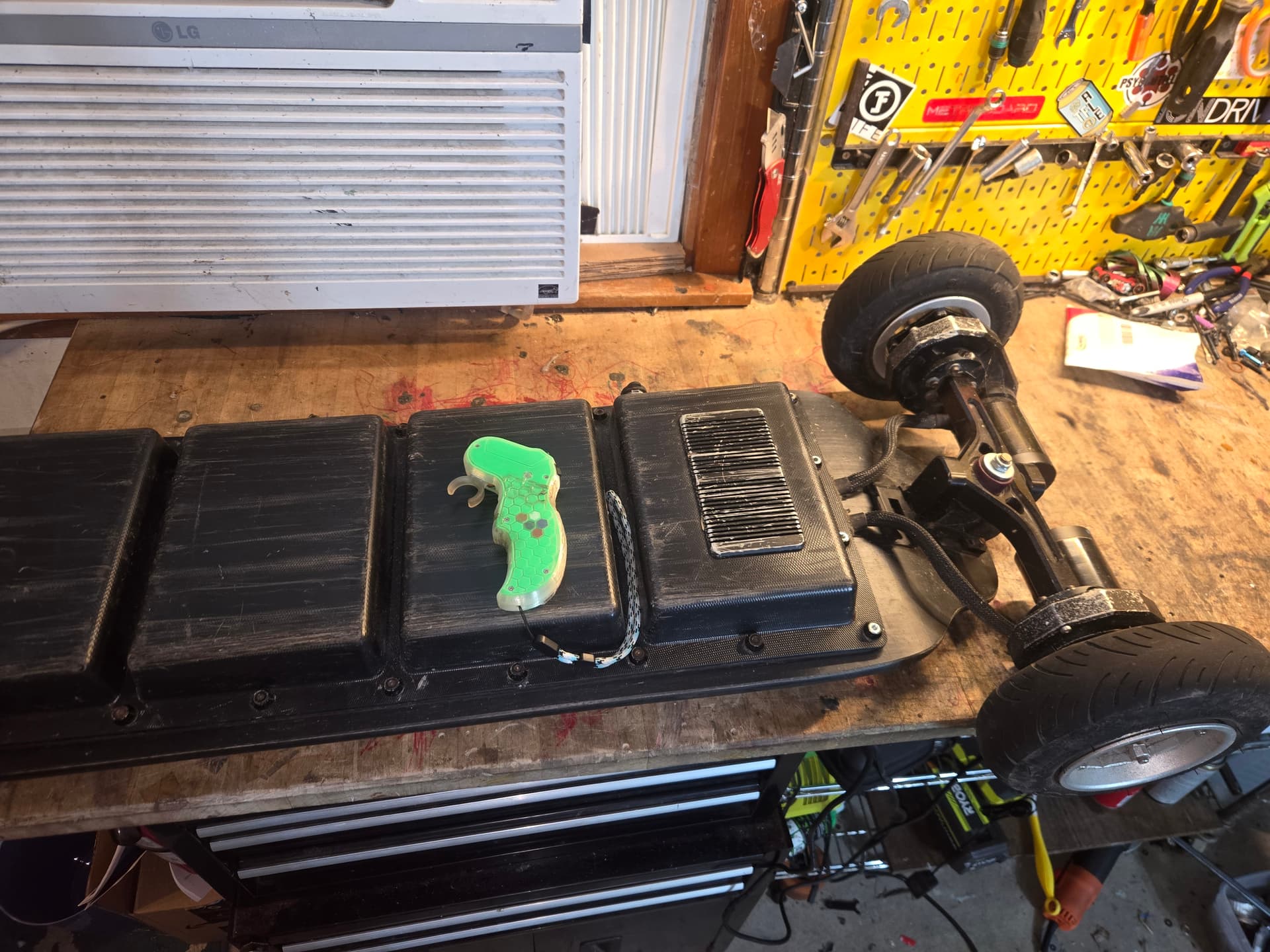

After many years of flawless performance and pure joy I have started running into some issues with my Z-motes.
I have had 3 affected.
1- the control arm broke and I printed a new one and it is back in service. Early unit.
2- I was riding, and we stopped for a second, and the remote just stopped talking to the board.
It turns on. But there is no PPM signal. Early unit.
I just took it out of the board and replaced it with a spare Z-mote.
So I would like to Maybe trouble shoot it.
3- is the one I’m about to work on.
It’s a weird issue.
It turns on.
It connects.
It works.
But after a minute or so a yellow light flashes sometimes and signal seems spotty…
I am about to open up the board and will probably replace this one as well
Damnit all kids…

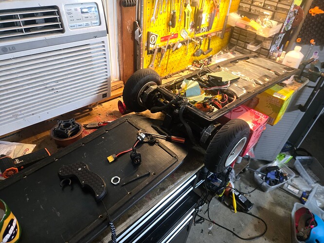

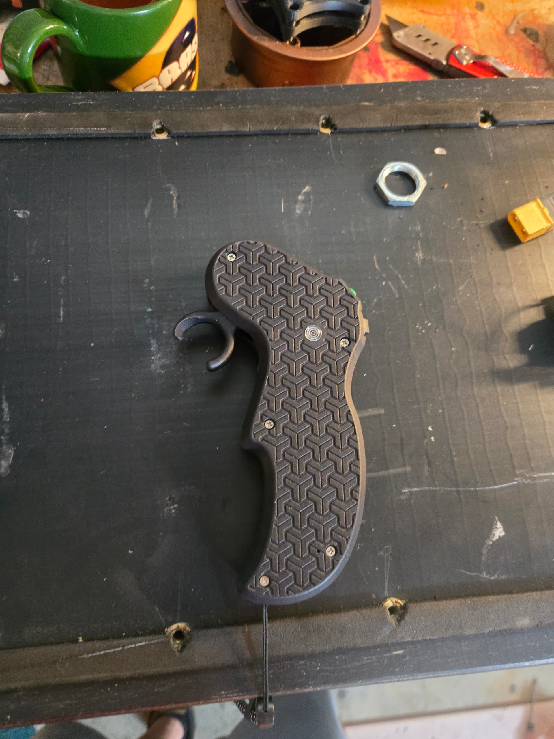

More Z-mote challenges…
The original X-motes I got were paired to a specific receiver.
Had no dead man switch.
Some had lights.
So less features, but more plug and play.
I have one of the newer ones now I’m trying to work with.
I was able to pair it
I was able to turn off the dead man switch.
So I thought I was good to go with set up in VESC .
And while setting up the PPM input it’s messing up.
When trying to see the Min Max , after throttle it does not got back to zero.
You can see the bar moving around on the screen recording below.
I believe I have recalibrated the trigger when going into the menu. But I’m am unsure as mine does not look exactly the same as the one in the Video…
Any thoughts on what else to try?
Do you guys think I have a bad remote?
I will email Kaman as well, but usually try here first.
