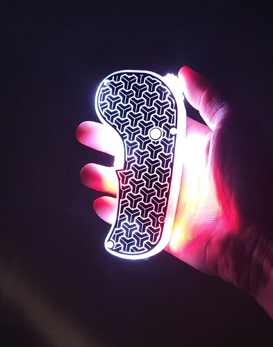

Thank you for the letter :smiley: I think I created this account some time ago and I totally forgot about it. I was surprised when I was able to just log in. I had to track down @Shadowfax regarding his order :smiley:
I’m working on “Light+” version for the thumb throttle version. It looks absolutely stunning at night and great for visibility as well. Pictures and videos doesn’t do its justice at all, they look so much better. I’m working on it on my free time for now, just adding lines to the current code. I have couple concerns and they require some more testing but we will see how it goes :slight_smile:
Here’s how it looks so far

daaaaaang bro, this is so cool. speaking of flashy remote, hands down this is the best one out there
Thank you, so far it works quite well. What I’m trying to add is a voltage divider with 200k and 10k to a battery. We already have a ground from the vesc so a single thin silicone cable preferably after the antispark switch goes directly to the receiver and theoretically it should be safe up to 70V but lets say 60V to account for the overshoot.
Goes like this, you press a battery check button, code checks if theres a running light mode at that time of pressing the button, if yes (stop that sht), switch to static mode, get color from the color wheel according to the reading we get from the receiver, hold it for 2 seconds, switch back to the mode you’ve been in.
if no, switch the lights on etc, after 2 seconds switch off the lights.
For now this works with remote battery but going to test it with my board which is only 10s but i will see how it goes.
Depending on the deadmans switch state we can check both batteries. If de pressed run that check for remote battery, if pressed run it for the board battery etc.
From the color wheel Im limiting the %100 to blue color and as it decreases goes towards red which is %0
It is of course not a precise measurement but it should at least give you a rough idea of current battery level.
