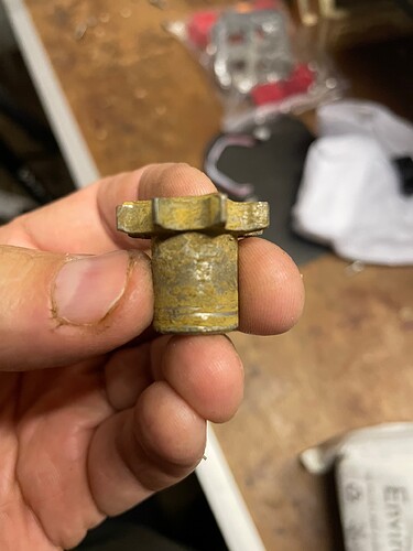

Off the shelf chain on the left and Apex Chain on the right (ever so slightly darker due to anti rust coating)

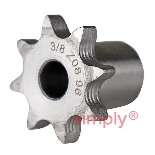

Off the shelf Sprocket not coated
Ends up looking like this

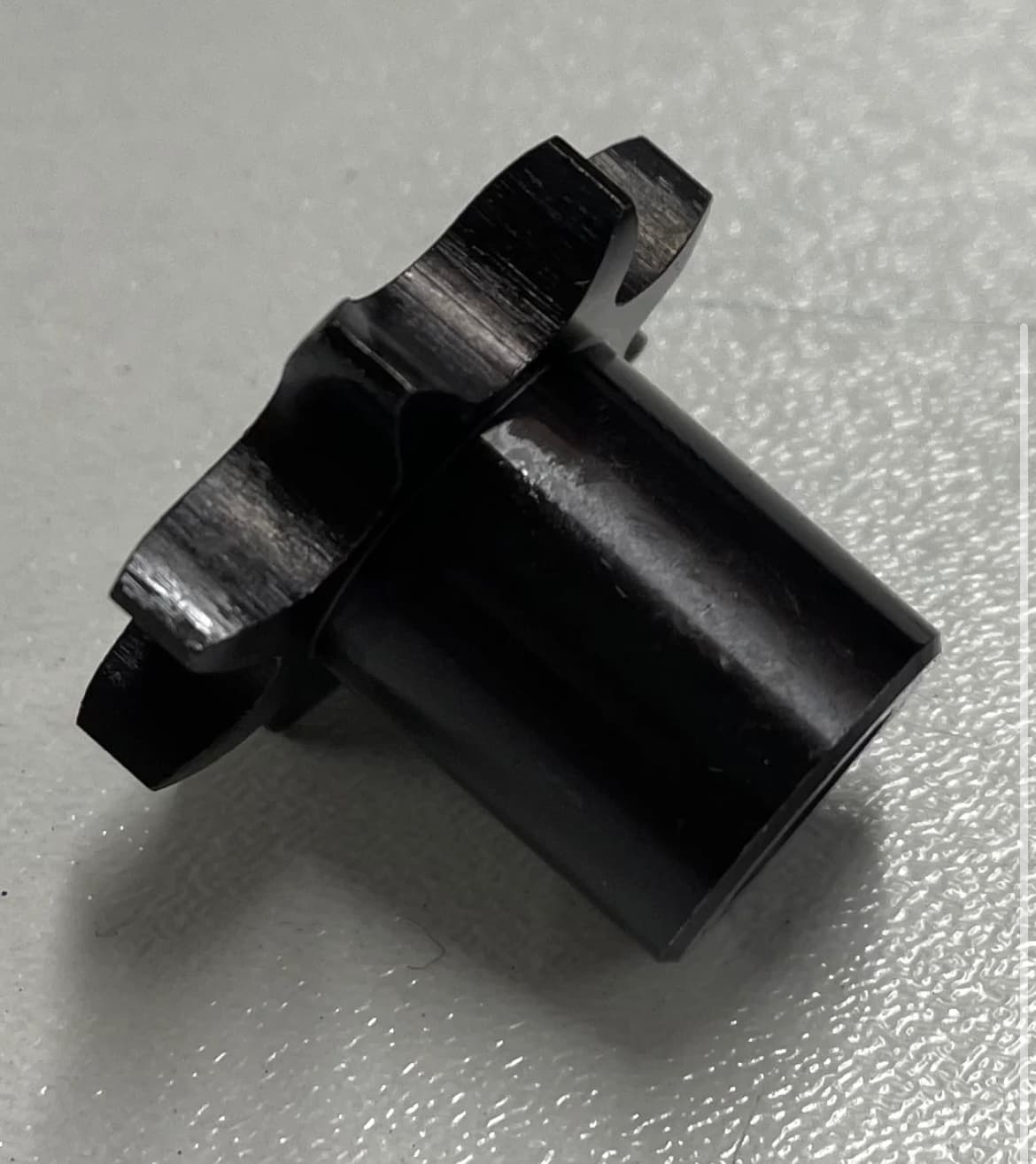

Apex Sprocket
Oooo whats the anti rust coating your chains have?
Anti rust :smiley:
im not sure how good it is yet, now the crappy weather is here we will find out but I hope it helps a little
Definitely looks like black oxide, which, if applied correctly, should be great except the teeth, but if the chain is well lubed, no worries. A well applied black oxide is great where there is no moving parts on them…
Black oxided screws “normally”suck for anti rust, as most screw manufacturers run them in huge batches, and don’t really fully clean the oil used to manufacture them. When the black oxide process is done correctly, like I assume they would be with these, :+1:t3:
The chains and the sprockets have different finishes. The motor sprockets look particularly dark on that photo but they aren’t that dark IRL, they have been case hardened and then coated.
