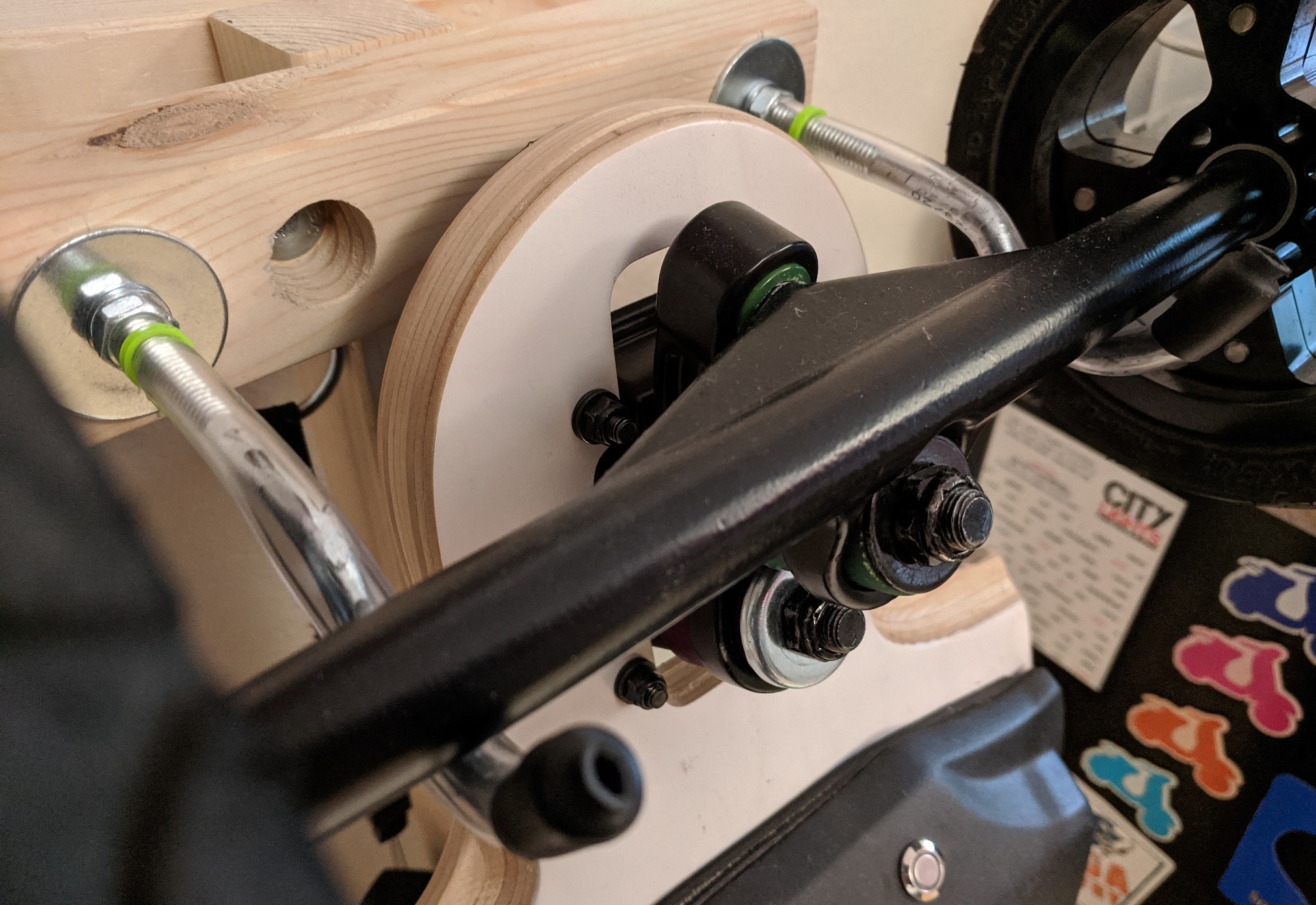

I wanted an easy way to store and charge YT. Requirements:
  • Minimal floor space
  • Charger can easily mount to stand, but can also be easily removed for travel charging
  • No metal on metal contact
  • Board is positioned so that charging port is easily accessible
  • Brake light fixture is protected from contact
  • Addition of spare (at a later time) will not impact the fit
  • Could balance well on its own as well as when loaded
  • Remote storage
I toyed around with different designs, eventually landing on a design using:
  • 2x2 wood pieces
  • Sunk holes to ensure no metal extended beyond the wood
  • Vinyl covered eye bolts (bent) with heat shrink on the bolt ends
  • 1/4" hardware for affixing the wood pieces to each other
  • Wood spools with spacers to affix the DC charger to the stand
  • S-hook for Remote storage
  • Soft pads to protect the floor and wall
Here’s the design:
And here’s the finished product:
