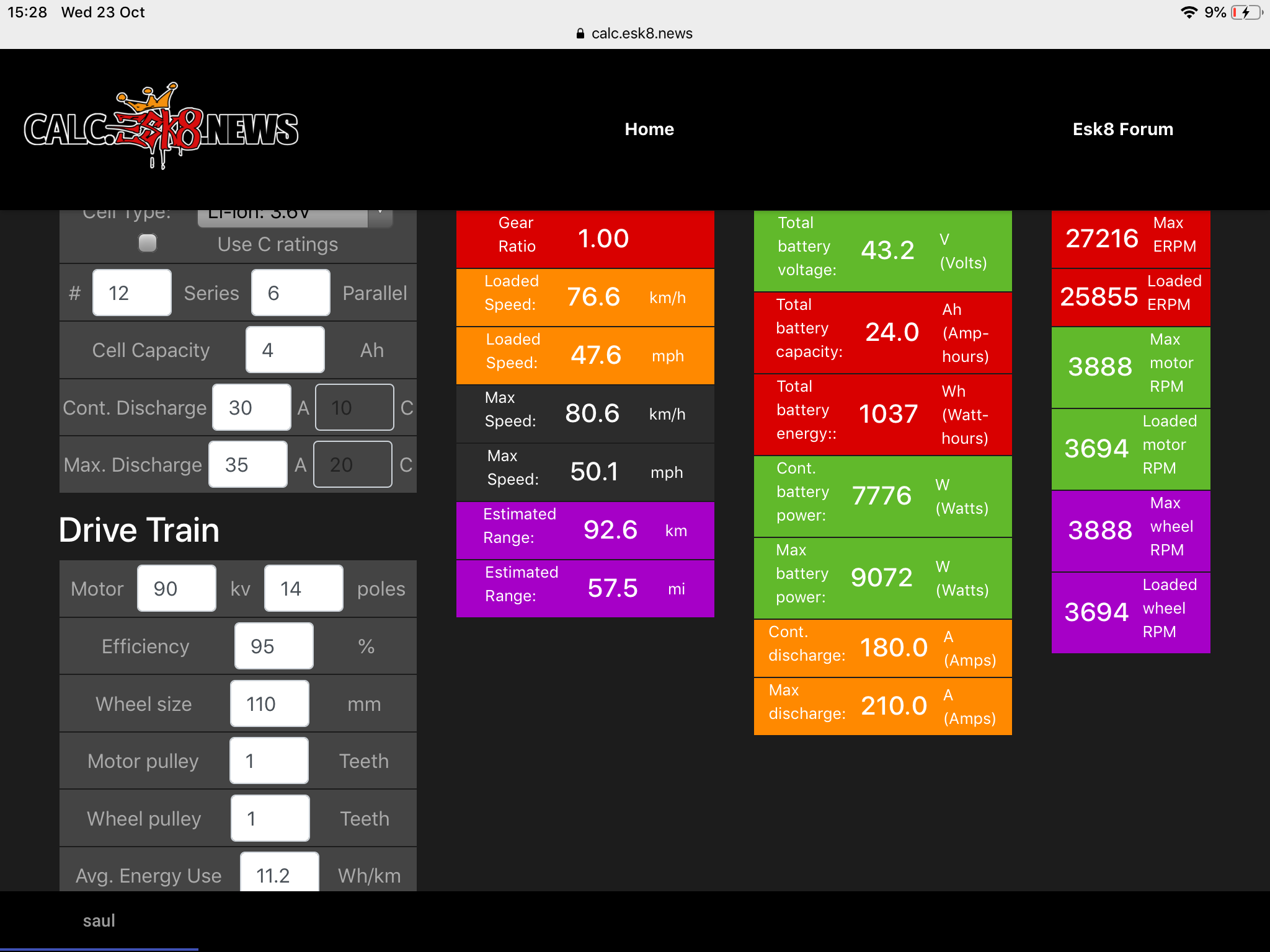

Mine:
Tb direct drive with tb110 90kv
TRAMPA vesc 75/300 x 4
Landyachtz evo with double stack enclosure
12s6p using Samsung 40t I think it fits
Tramps wand remote
Extras:
Davega
Metr pro
Sender to vinyl and epoxy the deck
What is your ultimate build??

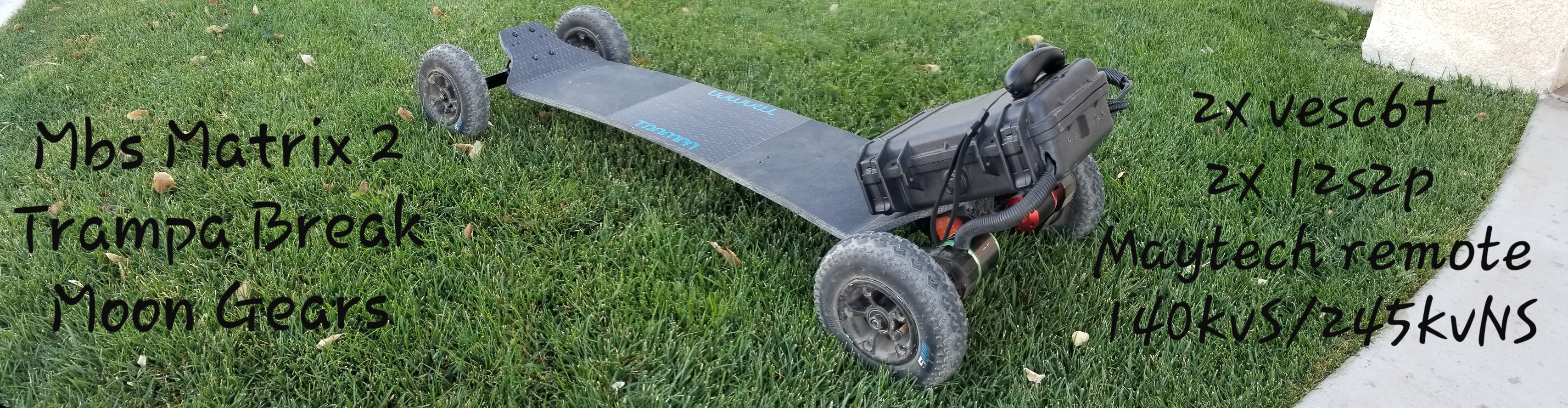

Its one 12s2p to one vesc and one to the other. No parallel connections just split pwm. Im already getting 20+ mi, i never kill the battery, The acceleration and torque is leaving rooster tails, I can climb up unbelievable hills, ive reached 35 mph at 3/4 throttle, what more do i need. If i add more batt its more weight. Everything fits in the pelican and looks sleek. Cost to build $1250
different kv motors? no drift when you accelerate? :thinking:
Mine would be a rocket hollow core deck 12s3p or 12s4p of 30t cells dual 6355s venom Mach 1 wheels with some boardnamics 184mm trucks
I have not. I was advised that i might get something like that by LHB but she stays straight as up to 35mph. Although letting off at high speeds is a lil rough but im learning to slide atm. One is sensored and the bigfoot is not.
My other is a single drive and in the dirt i get all kinds of drift
