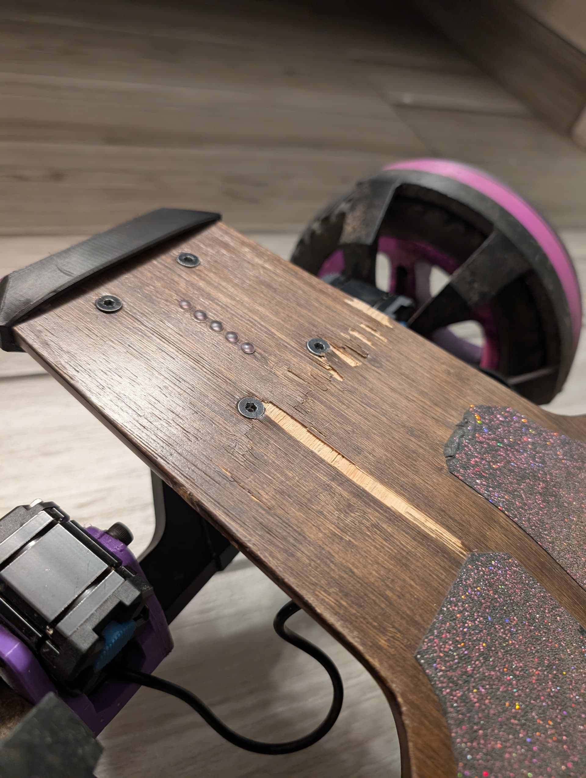

So it’s a Hoyt UAV Dadbod built by Hoyt.
  • Chocolate stain
  • Hoyt Puck - purple
  • 44mph
  • 7" Hoyt tires & hubs
  • 190kv 3400W 100A Motors
  • 16s9p 2017Wh Molicel P42A Battery
  • Special sauce
Customizations:
  • Purple glitter griptape
  • Custom logo on the belly

Next up, I did some resin work and filled the lasered logos and branding with purple & glitter resin!

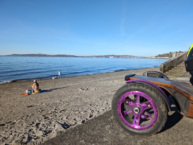

So I sent my 7" hubs off…
For custom anodizing :purple_heart::unicorn:
Wow!!!
Fuck me!!
  • painted the bronze valve stems purple
  • purple anodized unicorn valve stem caps
  • purple tire lettering paint
  • shredlights FX+ & sl300+
  • TPU nose guard by @jack.luis

Was there any noticeable change in bearing fitment after anodizing? Anodized layers aren’t very thick, but hub mfgs usually CNC the bearing pockets after anodizing to ensure a precision bearing fit.
Nothing noticable. Most went in with a light press, a couple pushed in easily by hand without the press

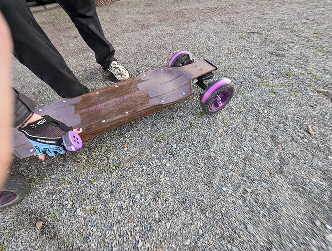

So, as seen above, I added fenders, designed by @jack.luis, I printed them with filament swaps to add rally stripes purple on black to match the whole motif
Also, added some dope lights that Jackson also sent :purple_heart:
Oh man I gotta send you the ones with the angles fixed. I tried to make them not blinding and definitely overdid it
