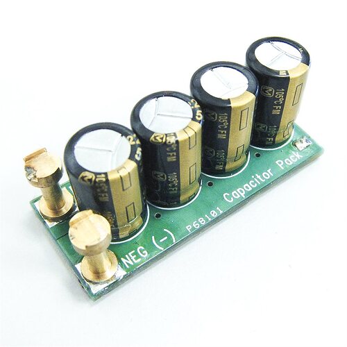

One thing we mustn’t forget here is that, while we are dealing with DC, the VESC generates 3-phase AC; this results in intense switching—turning on and off—that closely resembles AC behavior. That’s why having capacitors on the input side is a good idea. I suspect that many of the VESCs people condemned would never have failed if they’d had them.
The Long battery wire inductance thing sent me down long deep twisting rabbitholes, for which I am grateful.
It seems that more capacitance at the input of the ESC is a very good thing when there is Antispark measures employed. Absorb the voltage spikes caused by long battery wire inductance, and reduce voltage ripple as the mosfets switch on and off.
Reducing Inductance which can cause the Water hammer like ESC damaging voltage spikes is something I had put no thought into when I built my batteries, nor did I managed its output wiring or the loopkey harness as well as I would today to reduce potential inductance.
On my future battery builds, My output wires are going to leave the battery in close proximity to each other, run in close as possible Physical parallel proximity for their complete distance to the ESC, while trying to minimize that distance. Reduce the loop area, reduce the inductance, reduce the size and speed of that voltage spiking electrical hammer, AND have some more capacitance at ESC input to soak up any which still does occur.
I intend to attach a capacitance ‘wart’ on my ESCs, even though Mine are low powered and I’ve yet to smoke an ESC. I like the idea of reduced stress on it and potential avoidance of the walk of shame. Or a smoke release event when emergency braking.
Reducing inductance potential with shorter runs of parallel battery to ESC wiring can likely also reduce EMI/RFI and perhaps those signal dropouts or general ESC whackadoodlery.
We’ve seen a not indiscriminate number of xt90s fail at higher voltages on this forum. I assume that adding in a cap bank would likely place even more stress on the antispark device.
Both of the links that you’ve posted talk about extending the length of the wires from the esc, but there has to be some length of wire from the battery, i wonder what the esc engineers would consider an ‘average’ battery cable length, as this would surely need to be considered when choosing the caps that are native to the esc.

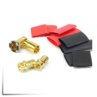

14S+ voltages and 500+ uf of capacitance are some AI slop numbers when I asked it at what voltages and capacitor capacitance does the resistor inside an XT90s fail.
I am totally clueless on how ESC with built in antispark works.
Are the Caps only eagerly sucking everything they can when the battery is plugged into the ESC that first time, or every time the ESC is powered up, and the ESC has to do some electrical mystery magic to prevent magic smoke every powerup?
Most modern VESCs just spark on the initial plugin and then turnoff is actually just “hibernation” or “low power sleep mode”. So inrush is only there once. I sometimes don’t even bother using XT90S anymore. Regular XT90 has longer contacts so should be lower resistance…
For setups that I do unplug often (like raceboard lipos) I use the Yeti 8mm antispark bullet plugs, they are the best antisparks I found so far and reliable at 20S voltage. XT90S resistor would fail in 1-5 plugins at 20S in my experience.

“The person who recommended the Jeti Model 8mm AFC (Anti-Spark) bullets knows exactly what they are doing.”
I was asking it for my own curiosity and potentially incurring the wrath of Bens Bees in bonnets, but I told it two Radium mach1s ESCs ( NON VESC) in a 4wheel drive set up, a 18S battery 2 meters away with 8awg tightly twisted, 100 battery amps
It said 2200 to 3000Uf of total capacitance at each ESC, assuming minimal loop area( space between the battery to ESC conductors)
Looks like the Jeti 8mm AS connector fits upto 4 SMD resistors?
It says total combined target resistance of 30 to 40 Ohms for antispark.
Select 1206 size (or larger, like 2512) if the physical collar has room
Pulse Withstanding Thick Film Resistors (such as the Panasonic ERJ-P series or Vishay CRCW-HP series)
I’ve No idea if the total capacitance or resistor values info is remotely accurate.
perhaps some EE’s can pick it apart, or maybe confirm.

The resistors are populated already on the connector - haven’t measured what they are but they work wonderfully for 2x D100s
@glyphiks yes the amount of capacitance does influence how well the antispark holds up. Estimating the energy that heats up the resistors should be simple. You can then use that to estimate heat rise but you’d need to know how much copper is in the resistors exactly, and that probably won’t lead to very accurate results.
