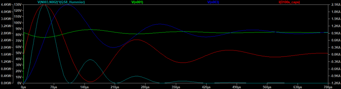

Below is a simple circuit to show a battery, the pre-charge resistor and the ESC’s electrolytic capacitors. It’s not a perfect representation as there are a lot of parasitics and ceramic caps not included in this calc, but since the resistor is the bottleneck, that shouldn’t change the results much.
Before looking into the simulated power using an anti-spark like the XT90s, here is a battery to ESC connection with no inrush limiting.
Current and power levels are very high. Like 2,000A for a few microseconds high.
Zooming in shows just how fast it charges the caps. This includes the ESR of the caps, the connection resistance, wire resistance, wire inductance and a 20s4p P42A pack’s internal resistance.
A resistor can be put in series to limit that current and slow down the filling of the capacitors. This is what the XT90s does. The problem with this method is that the resistor has to dissipate a lot of power and is going to get very hot. The problem only gets worse with higher battery voltage.
Legend:
Green line: Battery voltage
Blue line: Capacitor voltage
Red Line: Current across the resistor
Dark Green: Watts lost as heat across the resistor

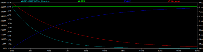

XT90s at 12s (this is OK)
About 500w peak is flowing through that probably 1w rated resistor for a short time.
XT90s at 14s
About 630w
XT90s at 20s (this will fail)
About 1250w
Hummie QS8 with 15ohm resistor at 14s
About 230w. The time it takes to fill is quite a bit longer though, so the resistor is running over it’s rating for longer.
Hummie QS8 with 15ohm resistor at 20s
About 450w, very similar to the 12s XT90s with a stock resistor in it.
Zooming out a bit - it takes about 50ms instead of 20ms to get down to 0.5A. Probably still fast enough that pushing it in at a normal speed would still allow the resistor to work.
Will the XT90s survive 14s? Probably. Do those mosfet based anti-spark switches address this inrush problem? No. Most are a very simple switch… and probably why they aren’t super reliable. The only one that did manage inrush, that I know of at least, was the Stormcore. Even that system occasionally failed for some reason or another.
