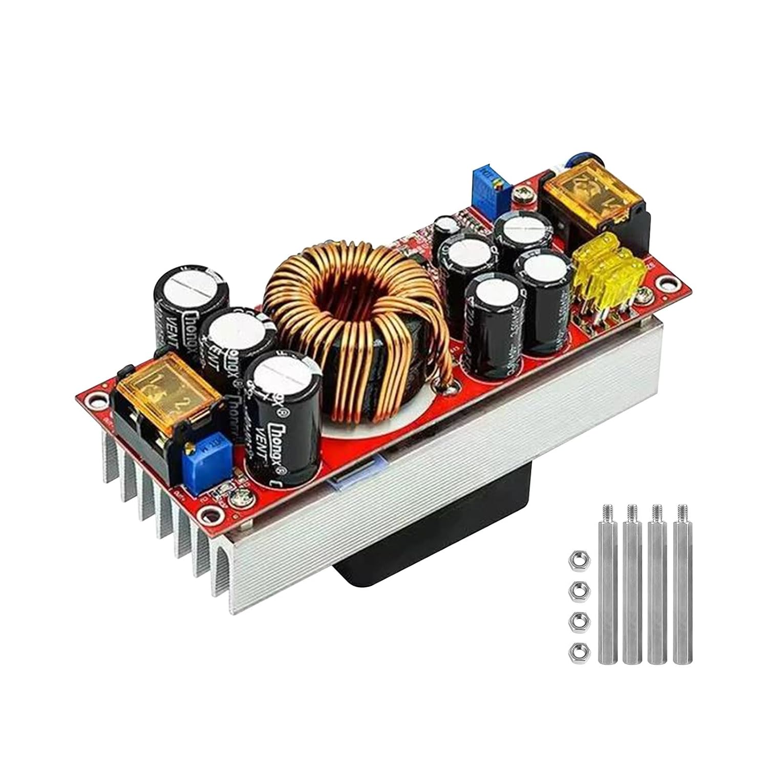

I have an CC/CV booster that claims it can handle 40 input amps, and I have used it at continuous 38amps with ~12.5v input. That was a little over 400 watts output with Booster output set to 41.75v, and some 60 watts turned to heat at this low input voltage.
Say the trailer battery is Just a battery to power a CCCV booster. The battery could be built around the trailer dimensions and use high energy cells, and keep the power cells in the Esk8 itself.
So a 16S14P trailer battery with Amprius SA1126500mah or more budget friendly FEB21700G(6.5ah).Either is rated at 13 amps each, so Halve this and 91 amps continuous Should keep them under 55C, but the 40 amp CCCV booster is limited.
16S nominal is 57.6 x 40 CCCV booster amps is 2304 watts x 0.9 for Booster inefficiency is 2073 Watts charging potential at 73.8v 18S ( at 4.1vpcell)
That would be about 28 amps charging current if you were to dial up 40 input amps.
When You stop to charge, have one charger for 18S, one for 16S, and then no worries about hooking up batteries in parallel at slightly different voltages.
This is my ‘1800 watt’ booster that I have pushed as high as 36 amps input continuously. It has a Fan on a pretty big finned heatsink which cycles on and off with heat.
Print up an enclosure for it and move the fan to the side for lower profile and so it can blow over inductor too. Pot it. Design Push pull fans on either end if you are feeling fancy. Cheap enough to print two and carry a backup.
I really like my 7s2p150wh portable charger holding my 10s2p 360wh Esk8 battery at 41.5v for a few miles. Spicier throttle, more range, and when portacharger is depleted I can leave it on the deck between my feet or put it into backpack, or Fiona’s Chariot.
So consider designing your trailer around a wide flat High energy density pack designed solely as a portable charger, with a super low center of gravity, and pleny of storage. It Need not have the high $ power cells, save those for the Esk8 enclosure.
THE 1800 CC/CV booster fed 16S voltages outputting 18S voltages can exceed your 1000 watt charge and ride desire, and likely run far cooler and more efficiently than mine being fed 12.5v and outputting 41.75v.
