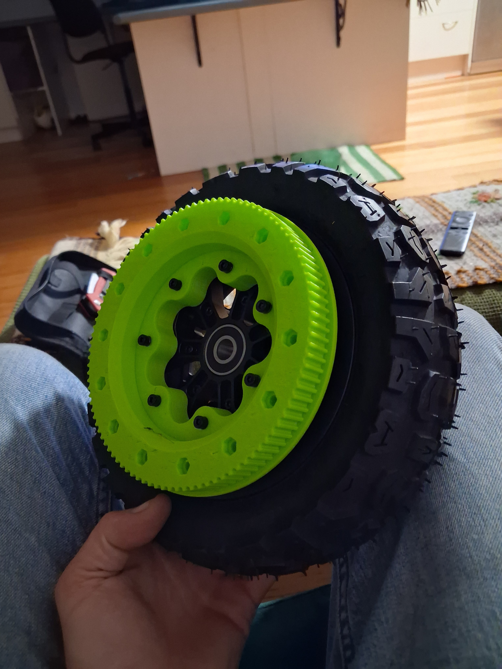

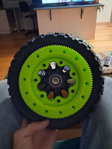

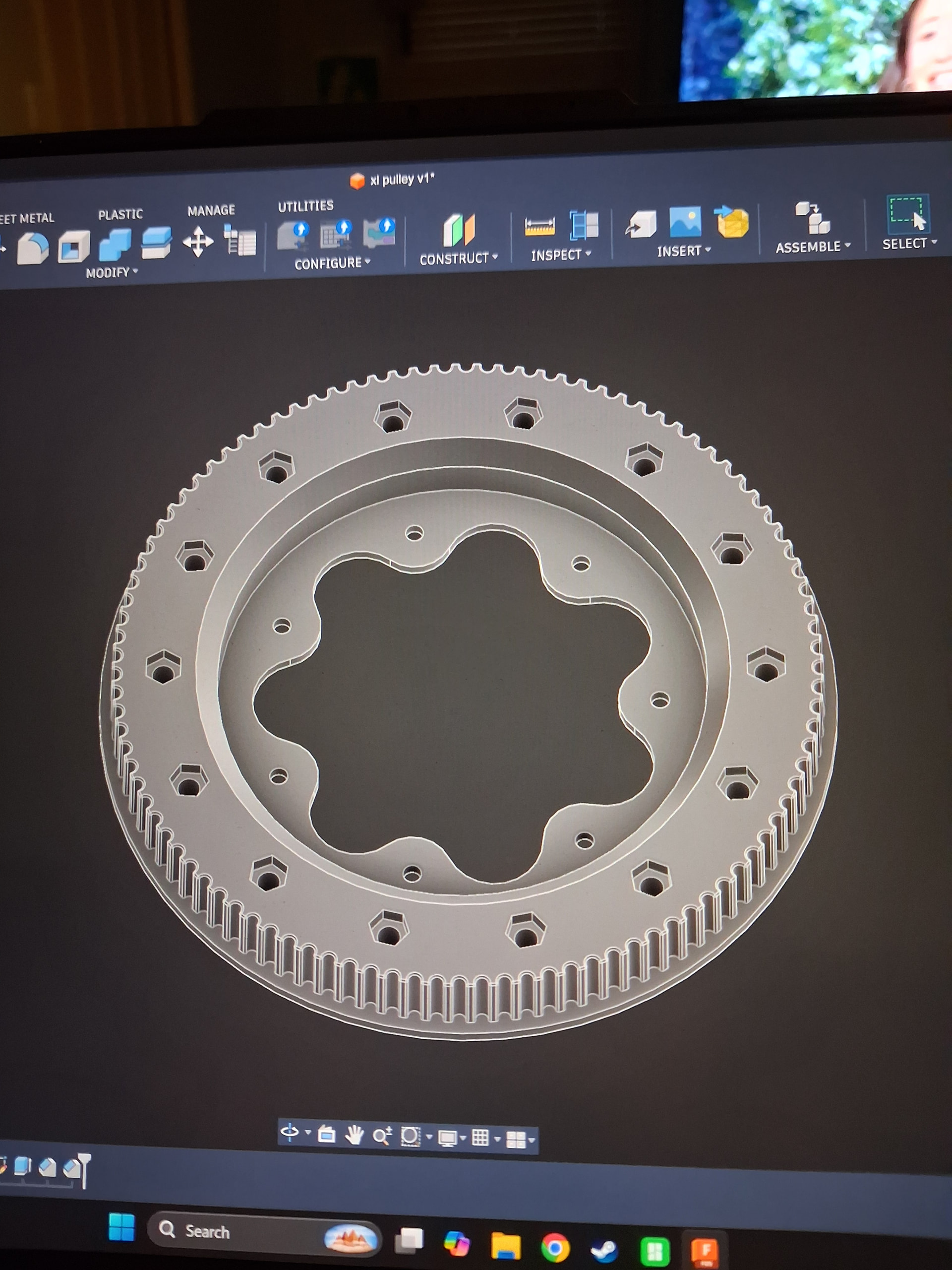

101 teef for the hunting tooth ratio :tooth:

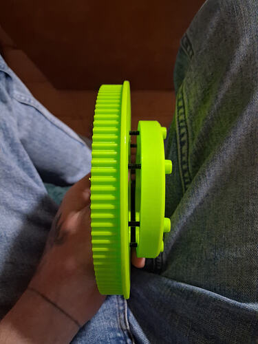

I think i wanna print the teeth section with gf nylon and the flange/adapter plate will be waterjet cut alu probably.
There is also a little adapter on the back of that plate to help it locate and space it correctly to the hub that i’ll also print with gf nylon, it’ll have the seven bolts through it so should be plenty strong enough.
Test print with petg happening now :partying_face:
I think I’d actually prefer regular nylon for the teeth. Gf/cf are quite abrasive so I’d be worried about wearing through the belts faster with that, not sure if it’s a valid concern or not. But also regular nylon is plenty strong already
I mainly just wanted the gf for the extra strength to use for other parts as well. I agree that regular nylon would probably be better for the teeth. Maybe i’ll just get both types!
Many say that carbon-fiber-reinforced nylon is the best material for functional, load-bearing parts. I would also coat it with epoxy resin.
Yeah i’d definitely be worried about the cf abrasive properties on the belt though, straight nylon should be plenty strong enough and should run smoother too.

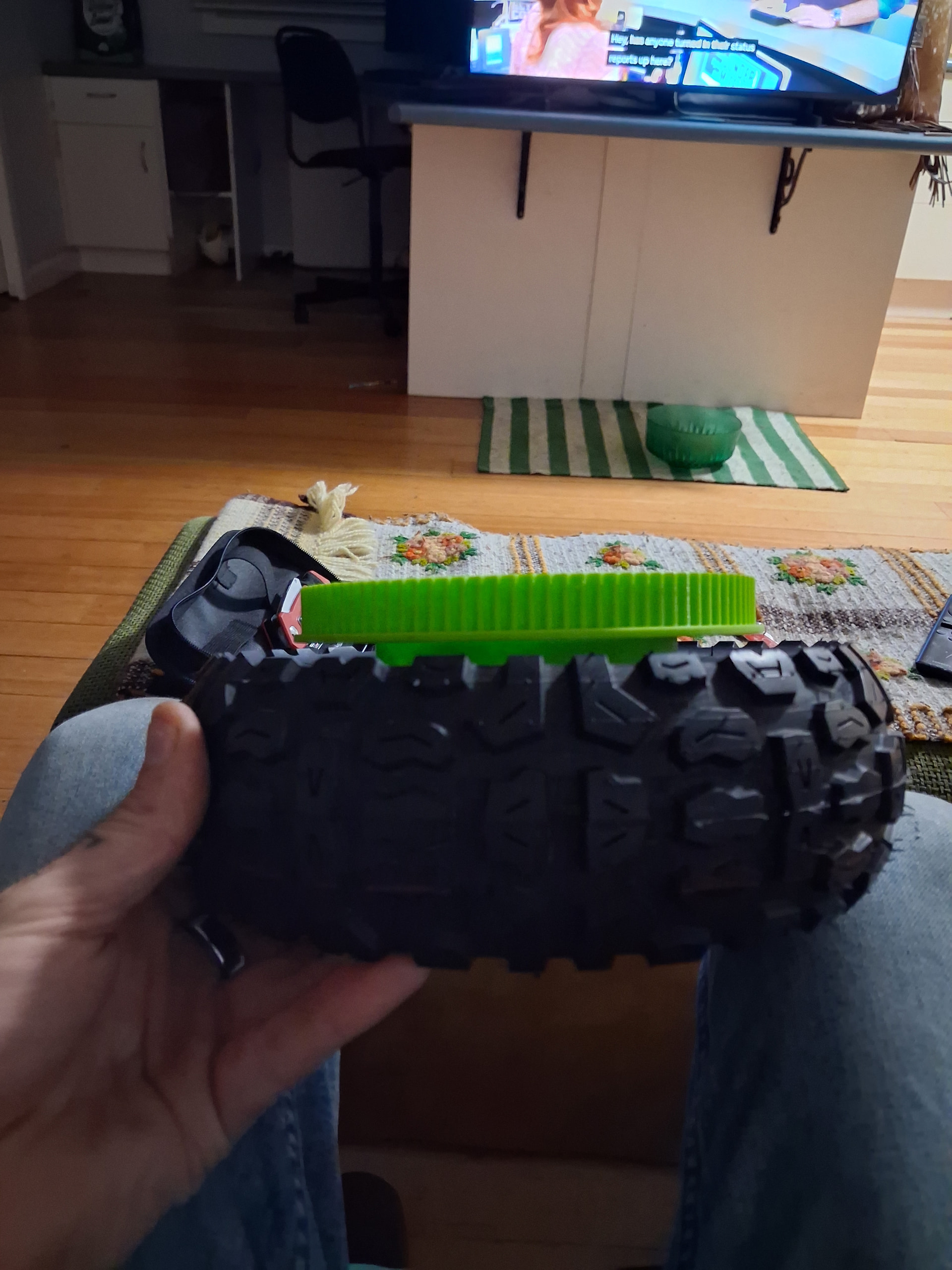

First pass at this went really well, tooth profile looks awesome against a belt even though i don’t have one big enough to go all the way around :rofl:
Need to tighten up the little nubs that insert into the hub and bring it in a little closer to the tire, but other than that i think it should be pretty good!

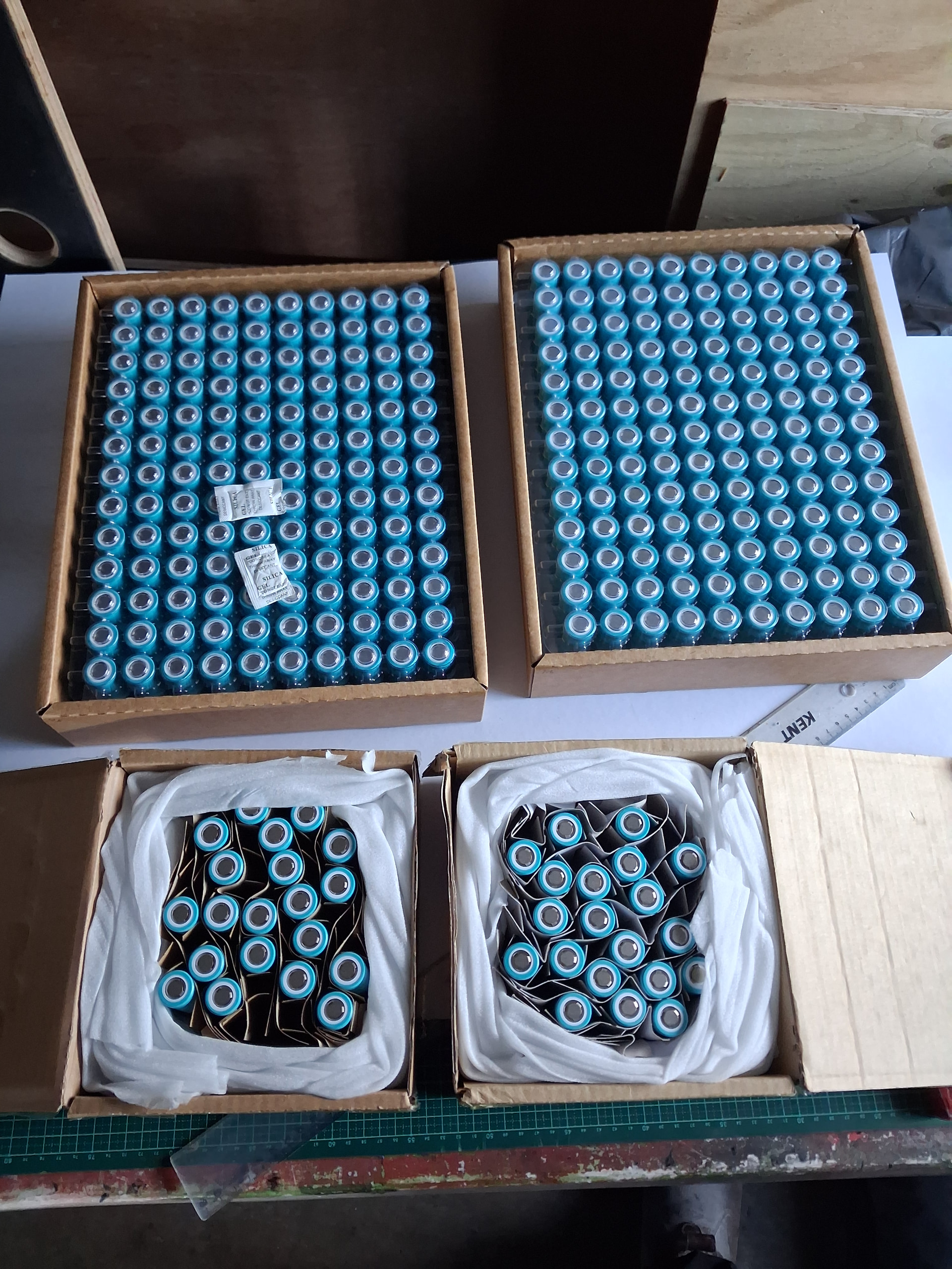

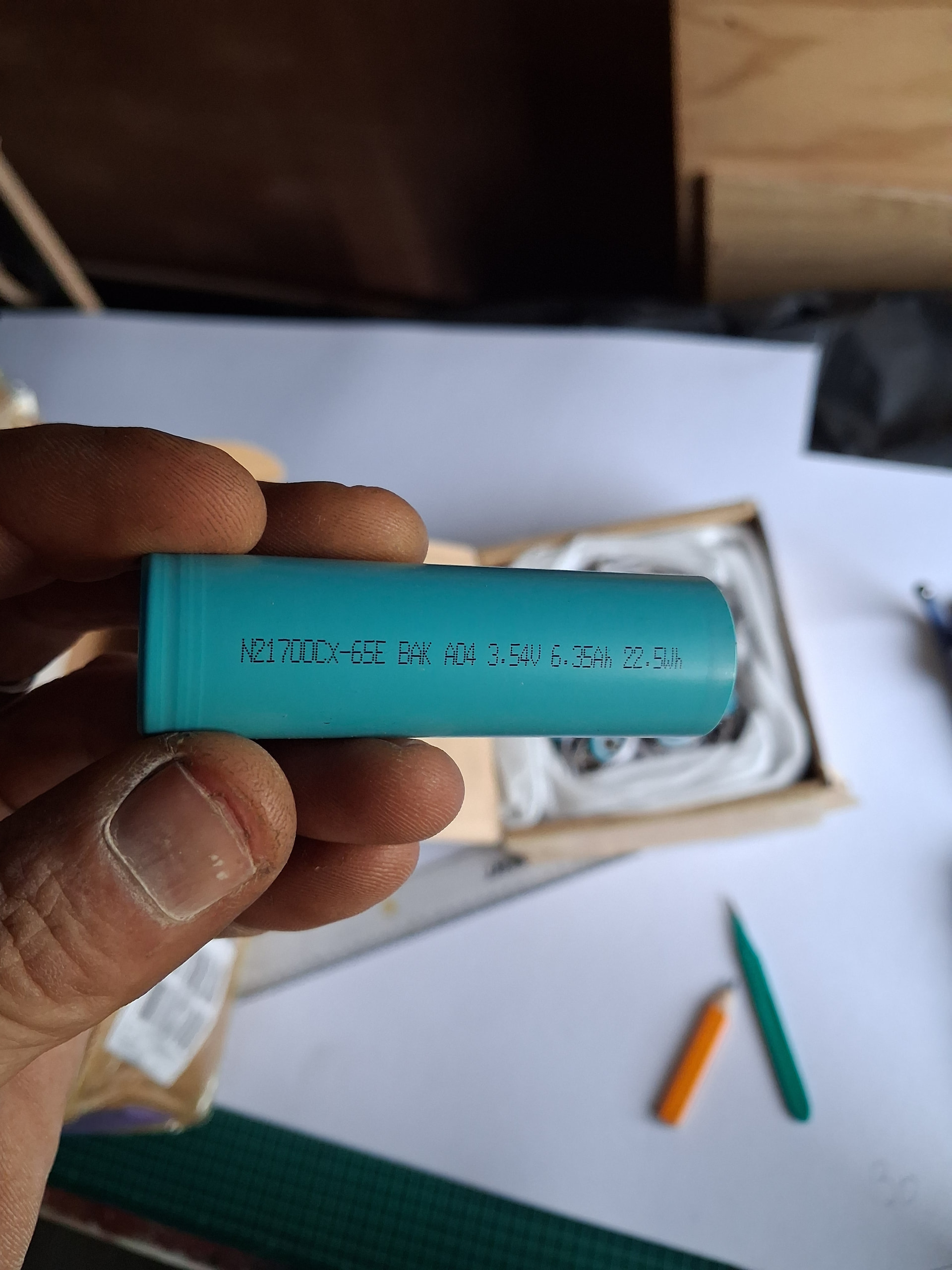

The BAK635E :sweat_smile: have arrived!
Bummer. Not quite enough for 2x 12s13p :cry:

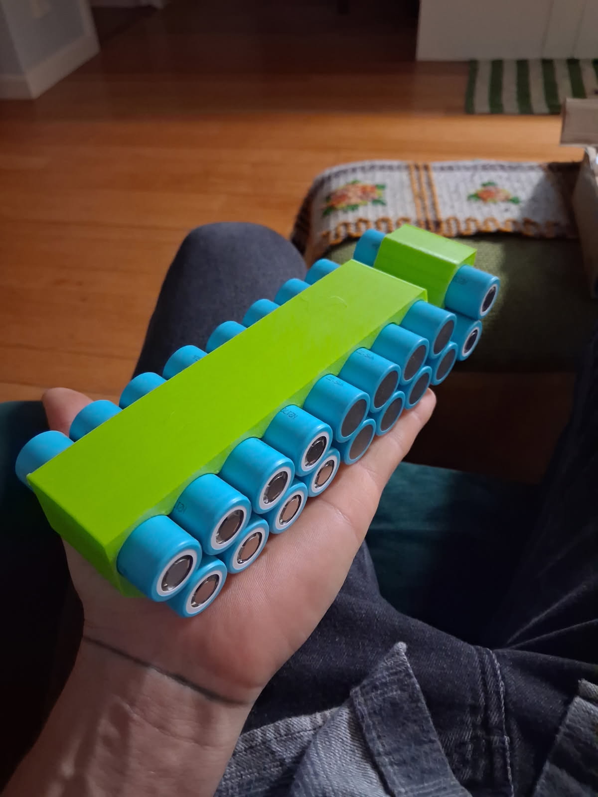

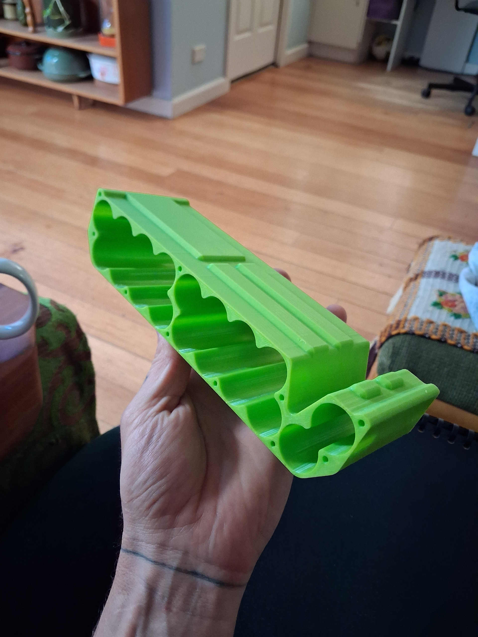

Excited to build this pack. For now i’m still fucking around with my cell holder design, trying to get the tolerances just right.

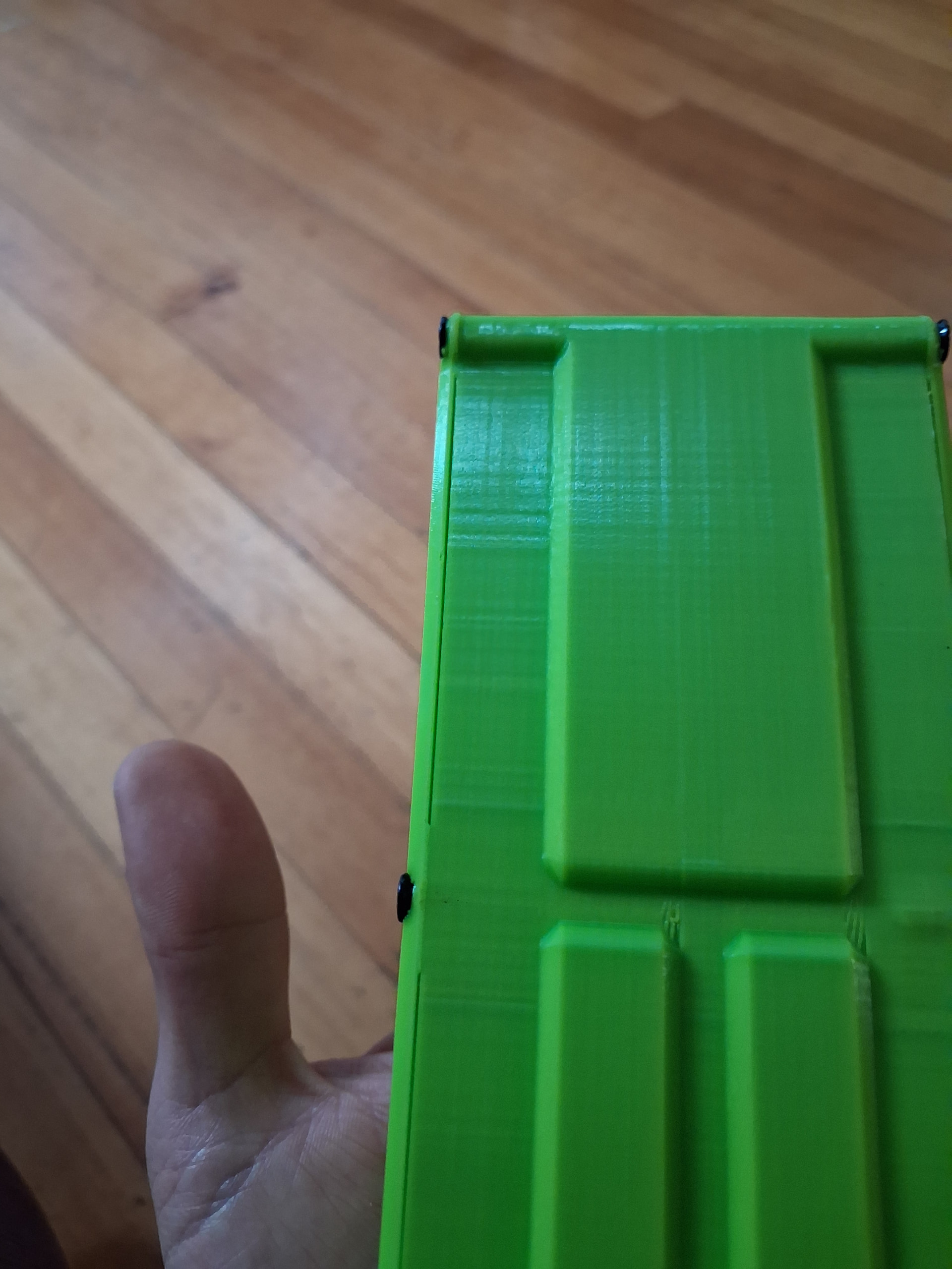

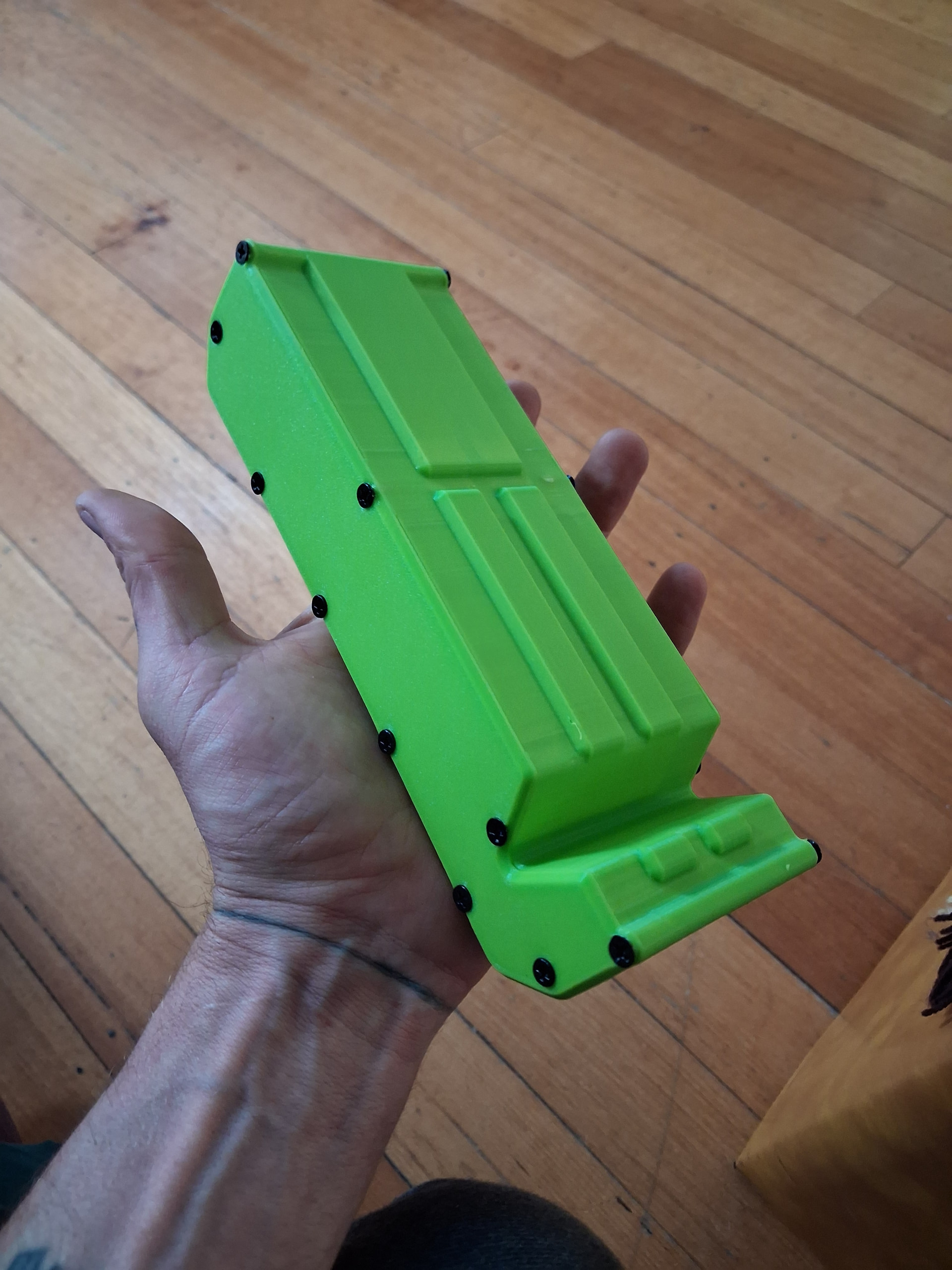

Ok it took a bit of doing but i’m pretty happy with this! Just gotta check if i have any more length in the segments to thicken the ‘lids’ up a little bit to house the screw heads a little better. If i don’t have enough space i’ll see if i can’t just get smaller screws.
There’s a tiny gap designed into it to let the copper come out and fold over, the intention of the lids is to try and hold the copper firmly before the fold to prevent any flex from reaching the welds.
Once everything is soldered up i’ll also tape the copper tab and wire connections down to try and secure that tab as best I can.
I’m thinking that I could silicone the lids before installing and somehow silicone around the copper gap as well and these packs could almost be waterproof, although i’m concerned that the permeability of the print itself could present an issue there.

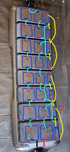

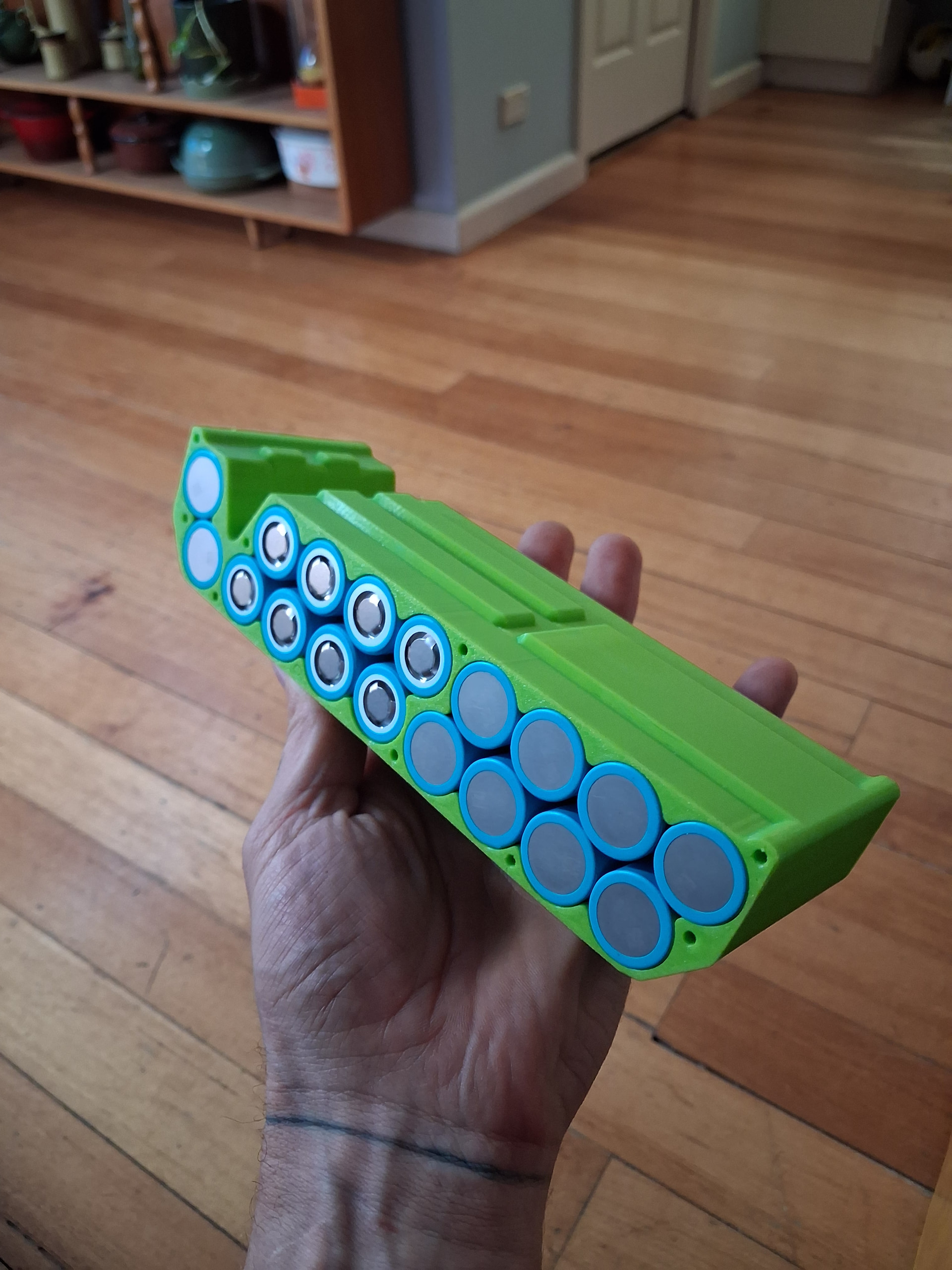

Wow, thanks for sharing this with us. I hope you’ll share your STL files with us later on. May I ask—it looks like an 8P configuration to me; why are there two extra cells at the end? Personally, I’d think it would be cool to have cases like that which you can bolt directly onto the board from below, module by module.
I can share the files for sure but they’re really only going to be relevant to this exact enclosure and battery configuration… and you’ll have to deal with my horrific fusion workflow if you want to modify :sweat_smile:
The battery will be 18s8p split over 8 enclosure segments.. 16s8p fits nicely in full groups, but the remaining 2 groups are split over 4 segments each. It was the easiest way to fit 18s8p into this enclosure.
The yellow connections are parallel connections… hope that makes sense :sweat_smile:
