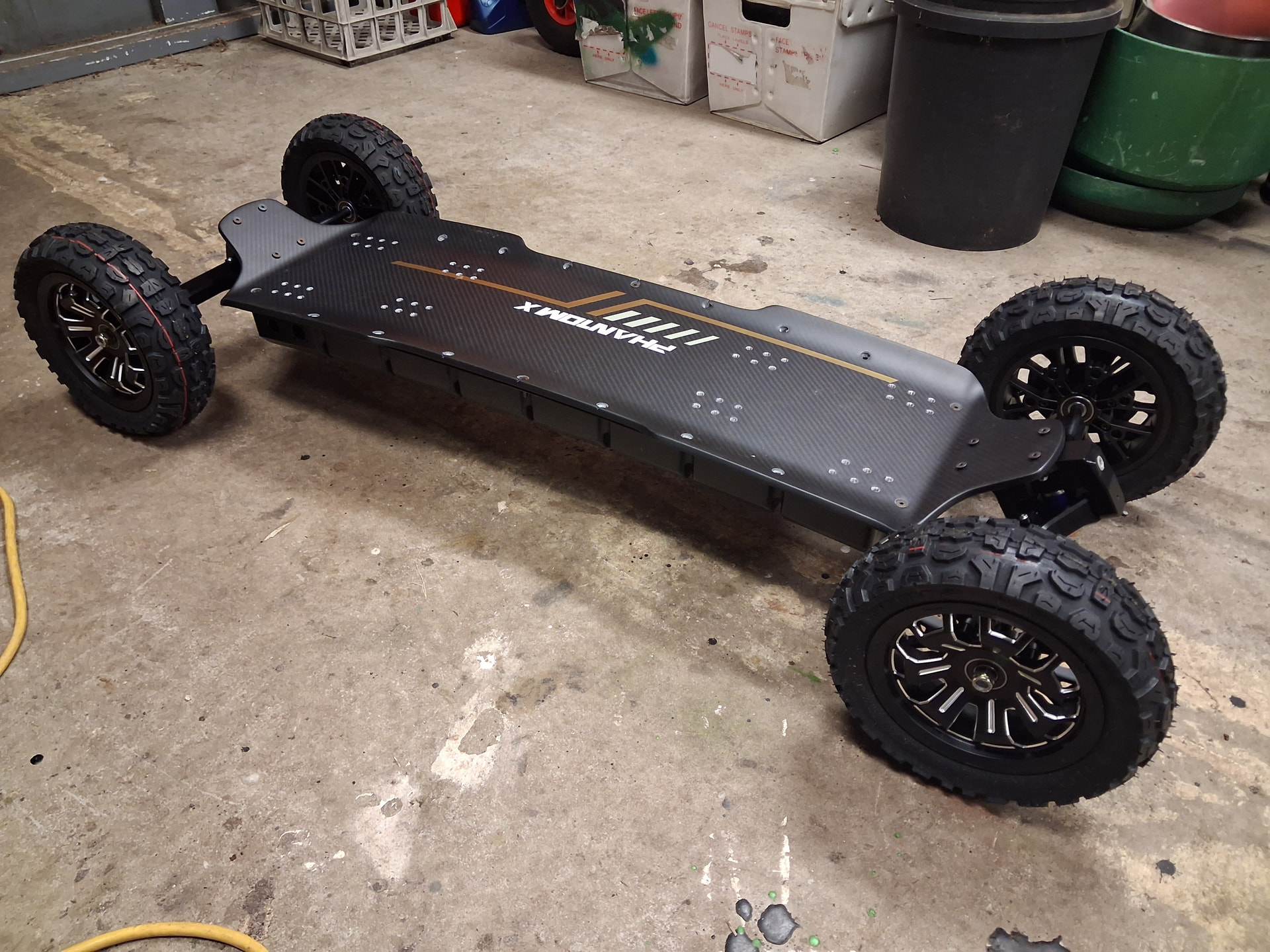

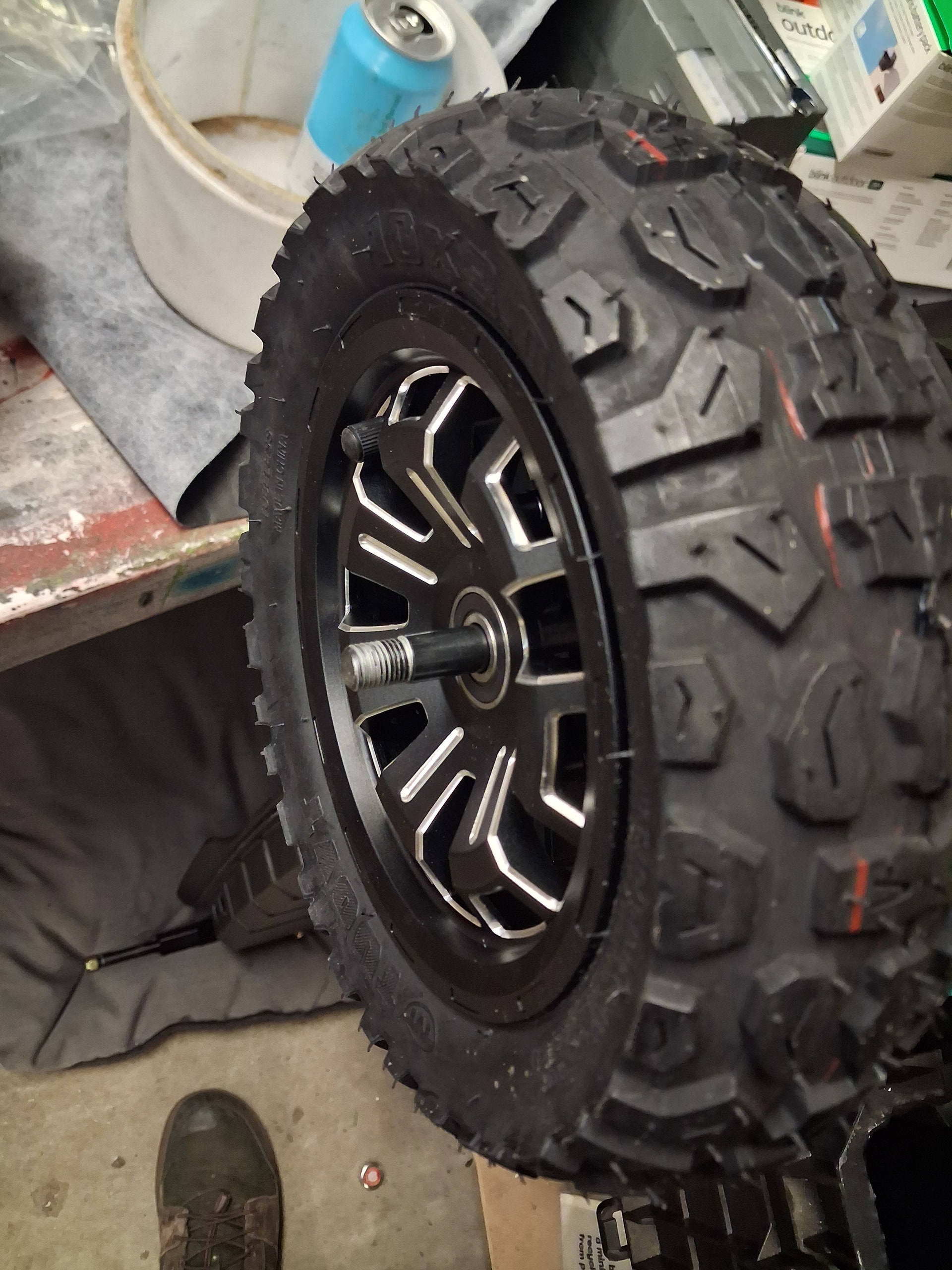

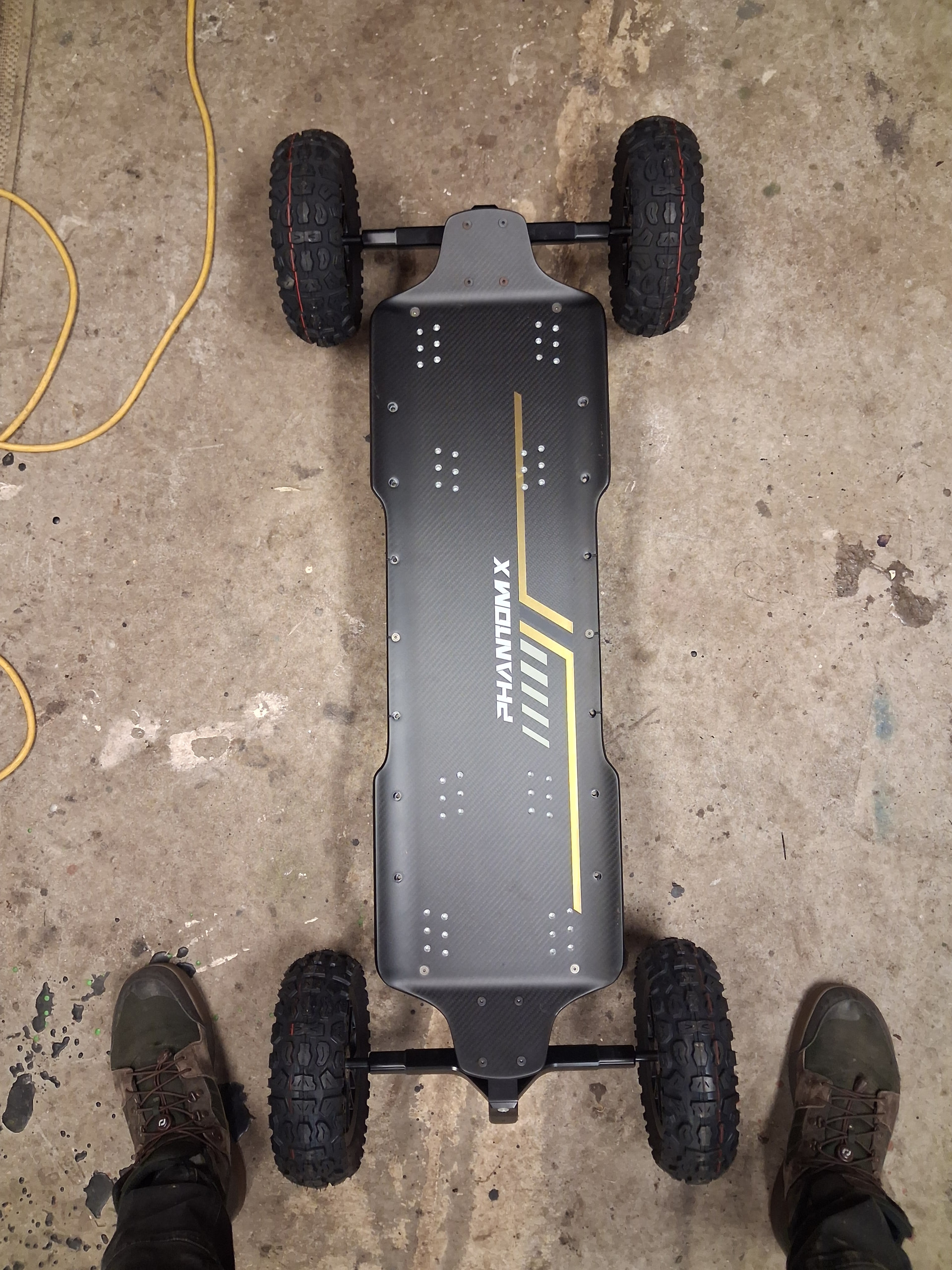

They finally arrived! Axle space for days!
There’s just enough axle space for me to run a pulley (or a gear!) with a bearing, which I was very much hoping for.
Now that i know i have that much room, I’m totally gonna ponder gears some more…. :rofl:
I’ll definitely need to extend the wheelbase, wheelbite will be real as it is, but now i have everything i need to start making moves on this build… except time :rofl:

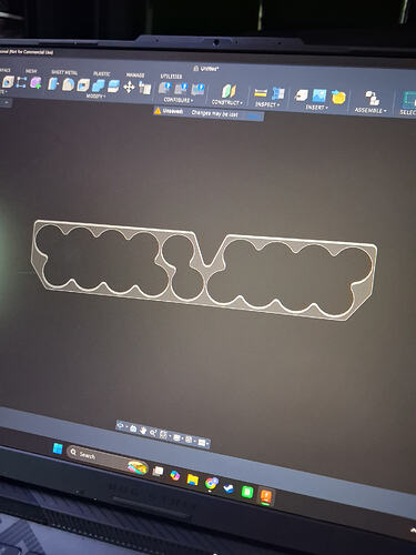

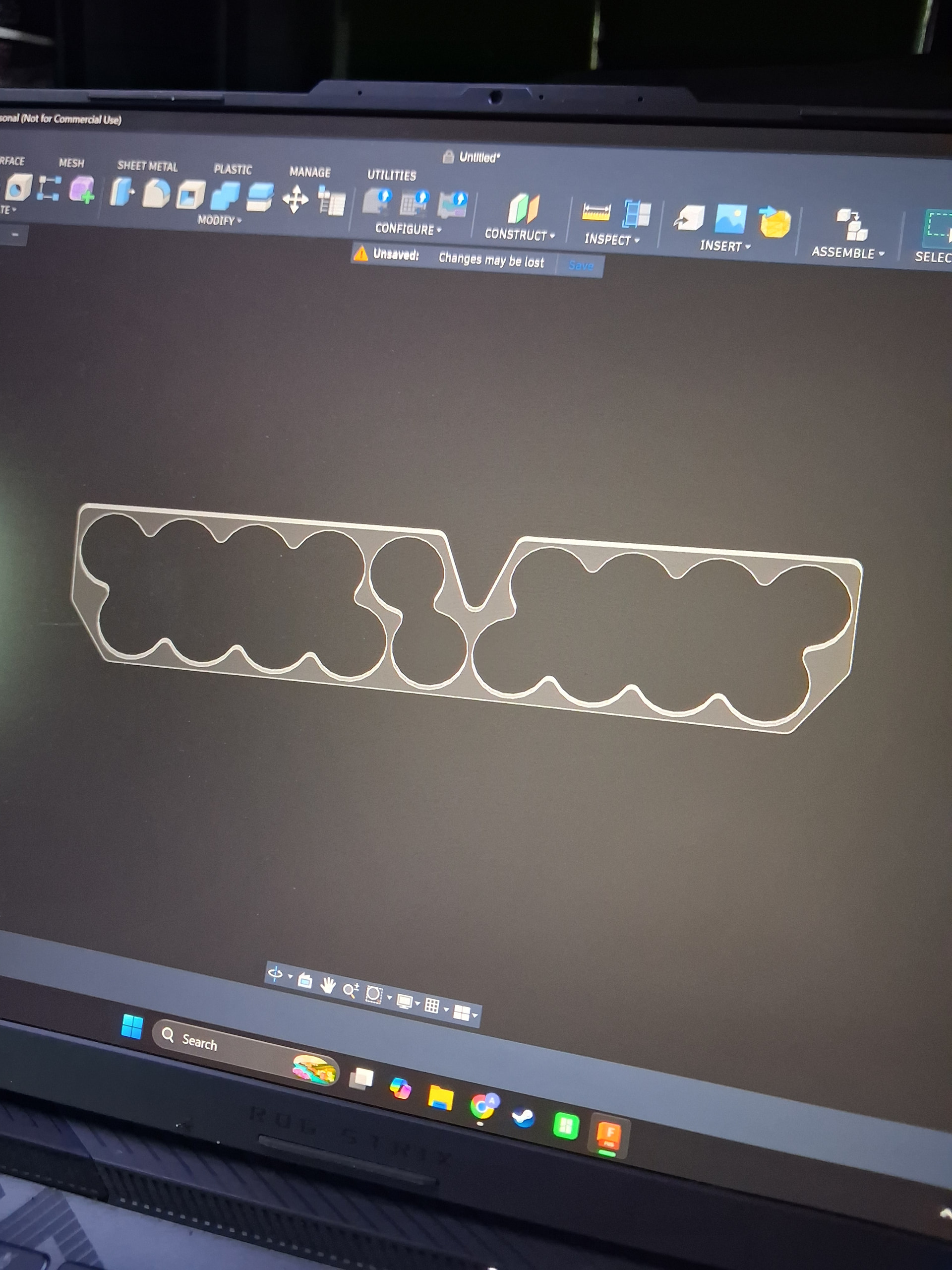

Ok so i needed to blow the cobwebs off my laptop and do a bunch of updates and stupid shit, but i’m back on the CAD train.

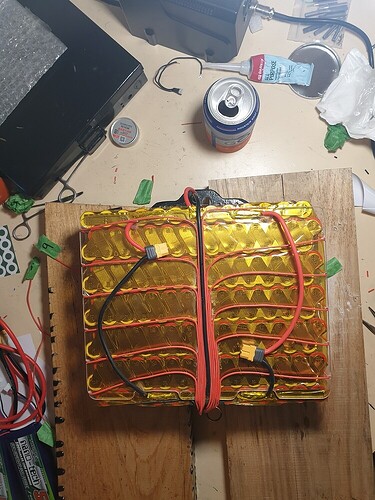

I wanna make fully encased cell holders for this build, for no good reason really, even though there’s probably several good reasons not to :rofl:
The pack will consist of full 8p groups up and down each side for 16s8p and then the final 2 groups are gonna have to be split across all 8 segments for the full 18s8p, 144 cells.
If you were properly insane, you could fit 156 cells in there, 12s13p anyone?
Everyone knows that all the best batteries are 12s13p :grin:

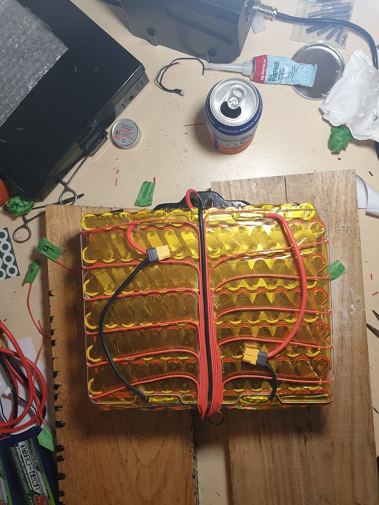

It was one of my very first battery builds, Madness housed a 12s13p sanyo pack… i’ll find a photo cos i loved that pack..
Back in the days of stacked nickel strips!
Madness was such a cool build.. i learned a lot from that one
I’ve got a 12s13p P42A pack in mistfall at the moment, and it’s a beast! I can’t kill it in less than 50mi no matter how hard I’m riding or what terrain. Been seriously eyeing some of these new 6Ah+ cells for a rebuild though…
That sanyo pack used to get me close to 100km and i never really found all that weight on top to be a problem. If anything, it made the board easier to turn cos the weight of it helped the board tip over… i imagine a big underslung battery might do the opposite :grimacing:
Balancing the forces, 18s16p - split between underslung and top box
