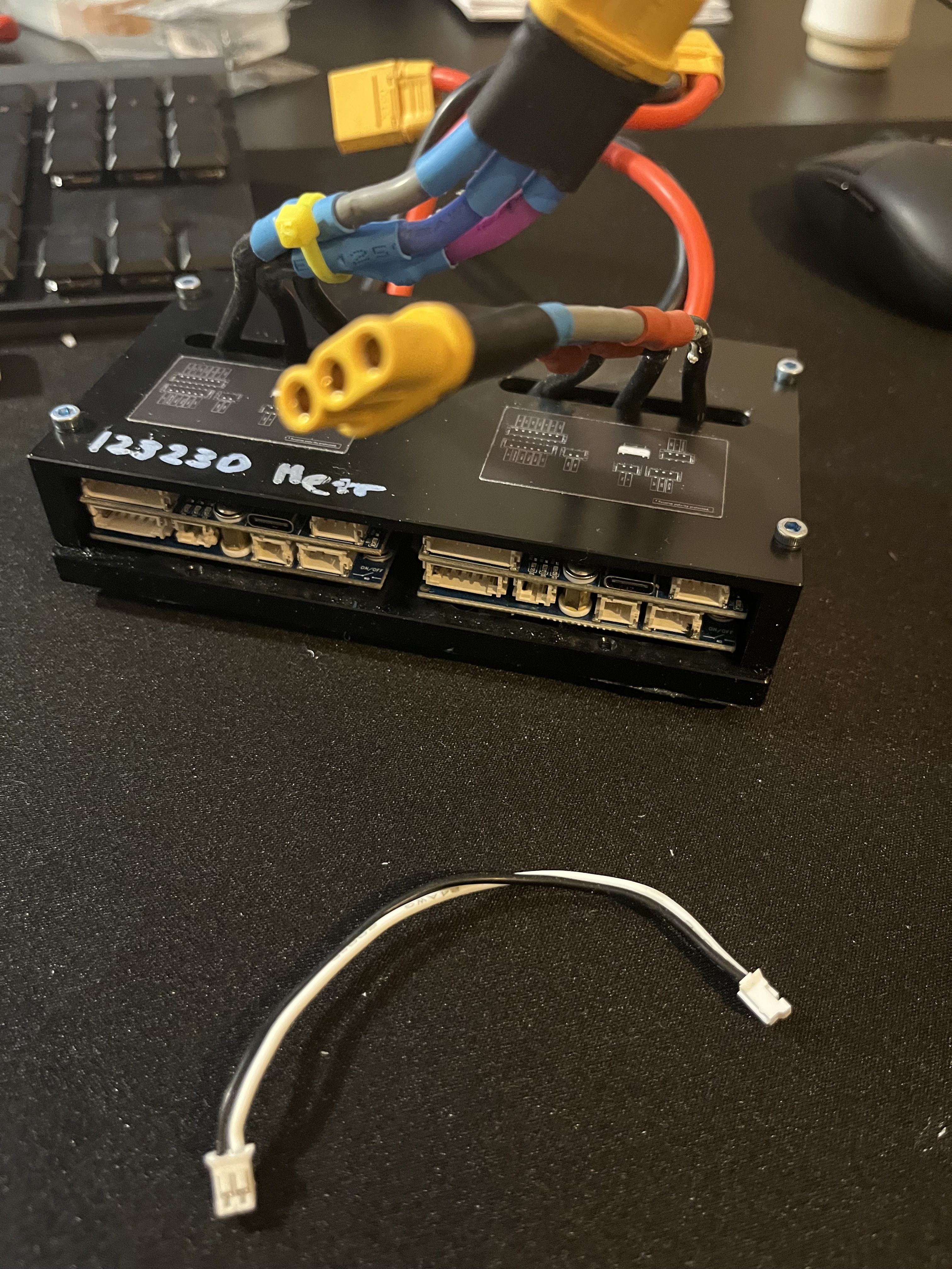

I‘ve bougt 2 skp solo duals. Shooted one side of the first one ordered the second one and immediately shooted one side of the second one. As artem refund me one pair there’s one functional pair with metr module left. I tried to plug it connect it to battery but just one side was on. I don‘t want to put more time into it. I didn‘t search for the error either, good chances both are working.
I shooted both escs during a ride. Now artem claims i shooted one of the working ones (the one that don‘t turn on) because I‘ve now antispark. Ok good to me, but why did it blew up during riding?
Anyways, i‘ve 1skp solo duo where one side with metr is perfectly working and one side maybe working

Definitely gonna want to figure out that root cause before you throw more money at the problem. Was it the same side on both ESCs? Inspect your motors and the wiring to them. There can be a number of reasons why the ESCs “shorted” but you can do a hand test on the motors to see quickly if they are the cause. Even using screws that are too long and protrude into the motor housing can easily cause a short while riding. You can also remove the circlip and visually check the windings.
Also if you have two duals with one side working on each the functional sides can be combined as they are individual units.

Same thought came to mind.. He basically has a functioning Solo.. Should be easy to swap it out and connect via cable

The unit you see there is where i put in two of the working solos, just want to get rid of it!
