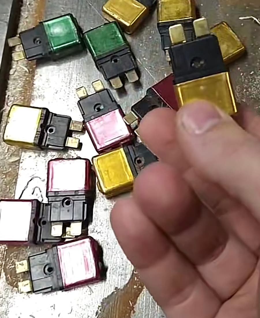

[WTS] [USA] Charge port fuses
fuck i just bought a 32v fuse from oreilly yesterday :pensive:
https://vm.tiktok.com/TTPdU3hhrU/?k=1
Just saw this. Breaker fuse?!?! Looks intriguing
This sale is on pause until I locate these again.
These are located and for sale.

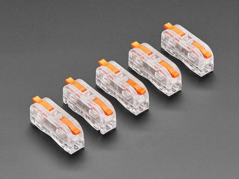

what do you think about using two of these, quickly swap fuses at the flick of a lever.
sadly they are massive. There must be a smaller version of them.
Actually there is prob a problem with when you release the wires you have live battery wires with no fuse…
wait no I was thinking both pos and ned would go through this but it would only be pos lead. So not so unsafe actually.

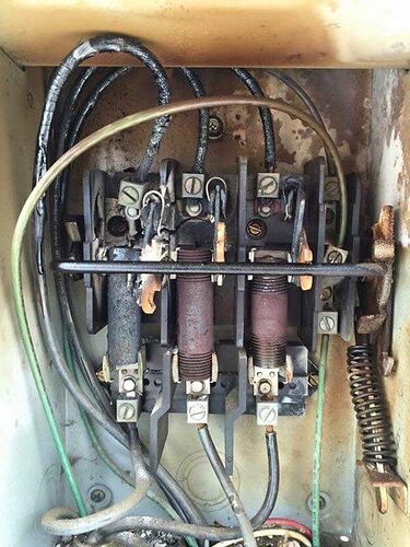

here is an unrelated but hilarious picture i found on the interwebs. actually seen some weird shit like this but usually not this bad lol. HVAC guys, am i right?
Ill have you know that schedule 40 black iron is rated for 40A and I refuse to accept any other answer.
