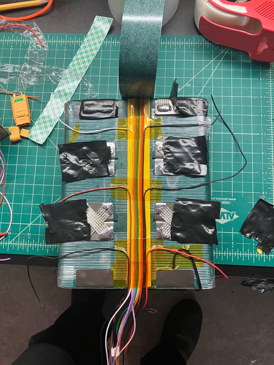

Also I can vouch for @Pecos as a reliable battery builder, I have a 12s5p P42A pack built by him, a 12s2p pack that he did a BMS swap on and will soon have an 18s1p p42a pack from him, all of which are built to the highest standards that I can comprehend. @Pecos might even have more build pictures to share if people have any concerns buying a battery from an unknown builder.
@Pecos doesn’t really offer to build batteries for other people, but enough locals have asked him to build them a pack. I have the utmost confidence in Chris as a builder.
Photo bomb!
The build looks meticulously done. I am shopping around for a single stack 12S battery though… @Pecos Is the battery is easily convertible to a single stack pack and @haven near someone who can do that? I have some knowledge about eskate batteries but have never worked on one.
The pack is a single stack, that has been folded back over on itself once. I was thinking that if haven ever wanted to re configure it it would make it easier that way. To do it you would have to take the braid off of the p3 to p4 group and the p9 to p10 group, lay it flat, then reconnect them. I wouldn’t say it’s a beginner project but it’s not as hard as building a new pack.
Id be willing to do it for some beer money if you work out something with haven, hate to see a good battery sit idle
Hey I mean if that could be reconfigured to fit in a peli 1150, I would consider it

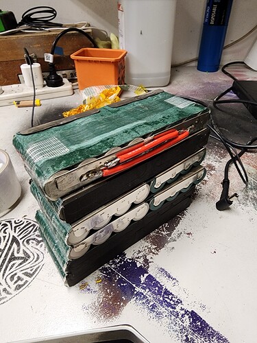

Changing from a double flat pack to a single flat pack is a simple exercise in topology. Making a flat pack into a brick/chocolate bar pack is mo involved and less rewarding.
Converting to a single will look much like this photo:
A brick pack is more dense and connected via welds not solder joints, more like this:
As soon as you have to remove welds and nickel you start to see significant increases in the effort. I wrote up a little walkthrough on recycling cells and though if using all matched cells it simplifies the process a lot - the physical labor needed to clean and prep cells without damaging them is a pain. Cells are cheap enough that it’s hard to justify the effort when i have more money than time.

Converting a flat pack to a brick pack doesn’t necessitate removing nickel, you can still solder all the connections of a brick pack as well.
I converted my Frankendick flat pack to a brick pack relatively easily.
