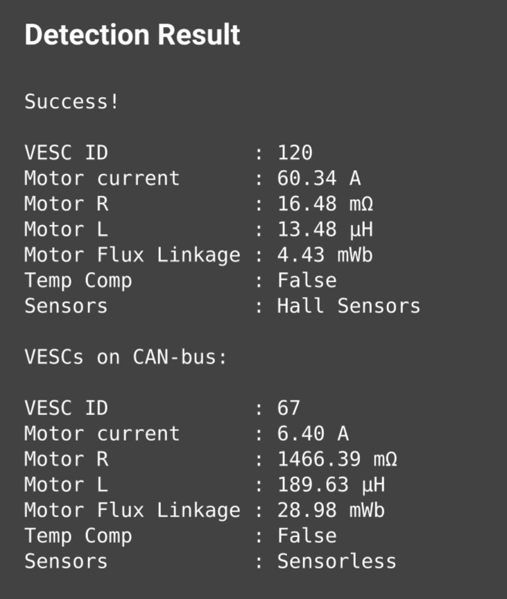

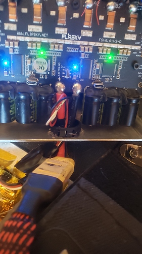

So I was out for a ride and about 15 minutes in the left motor goes full power for about a quarter of a second, full brake for a quarter of a second, then just off. I then limped the board home on one motor. I am running a flipshit 6.6 and torqueboards 6355 motors on 10s. All 4 lights light up when powered on. I ran motor detection and got this (see pic). Does anyone know what this is caused by?
Motor max: 80
Motor min: -60
Battery max: 60
Battery min: -17
Are your motor cable connections solid?
Yes, and no visible damage to any of the wires.
1466mΩ is way too high.
Take the motor off and try the hand test
What is the result? Does it fail step 7?
Weird! Take apart the motor phase leads and short two of them together and give the motor a hand spin to see if there is any resistance.
Also noticed that that motor didnt pass sensor detection, maybe sensor wires shorted somehow?
