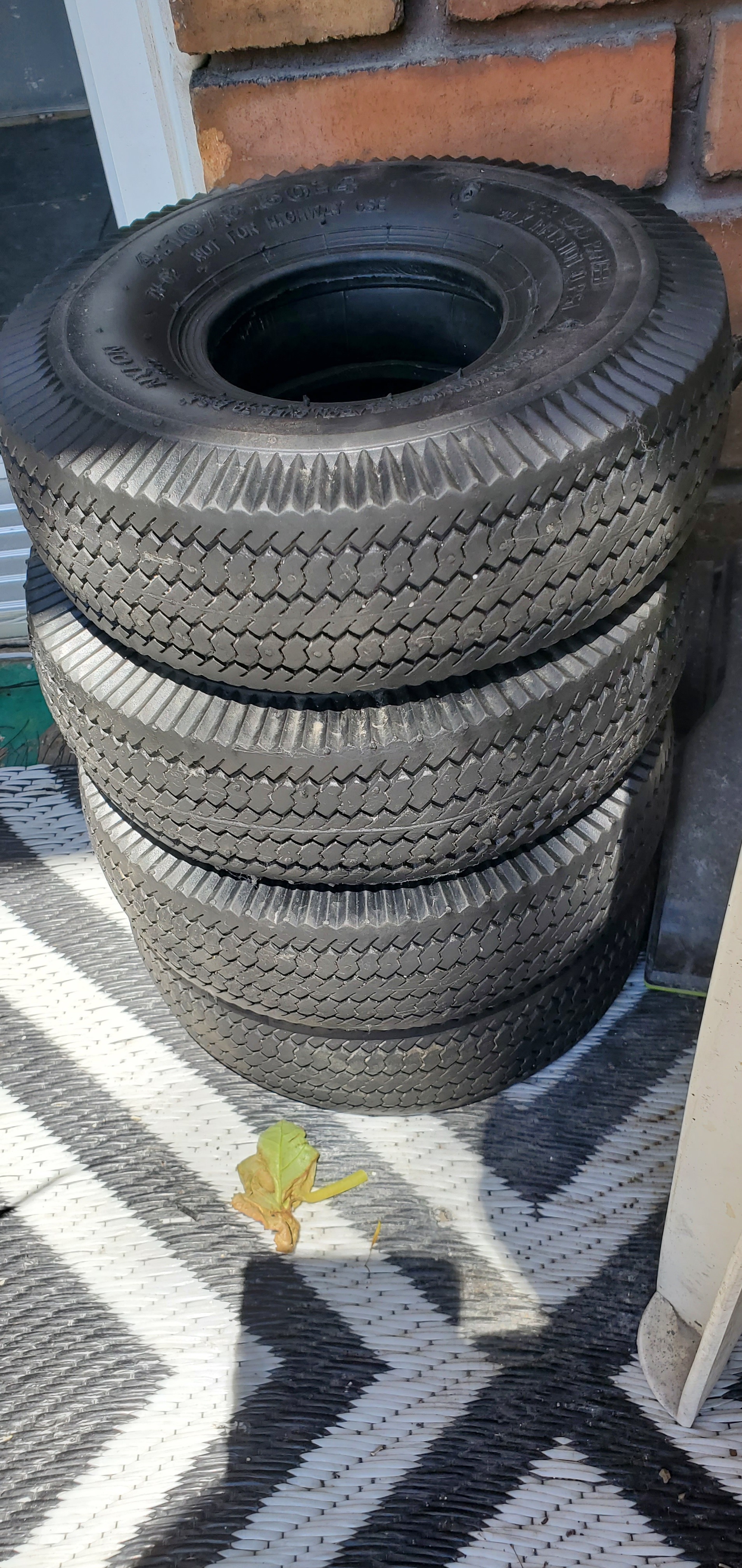

I need/want 9inch tires on my LsSS.

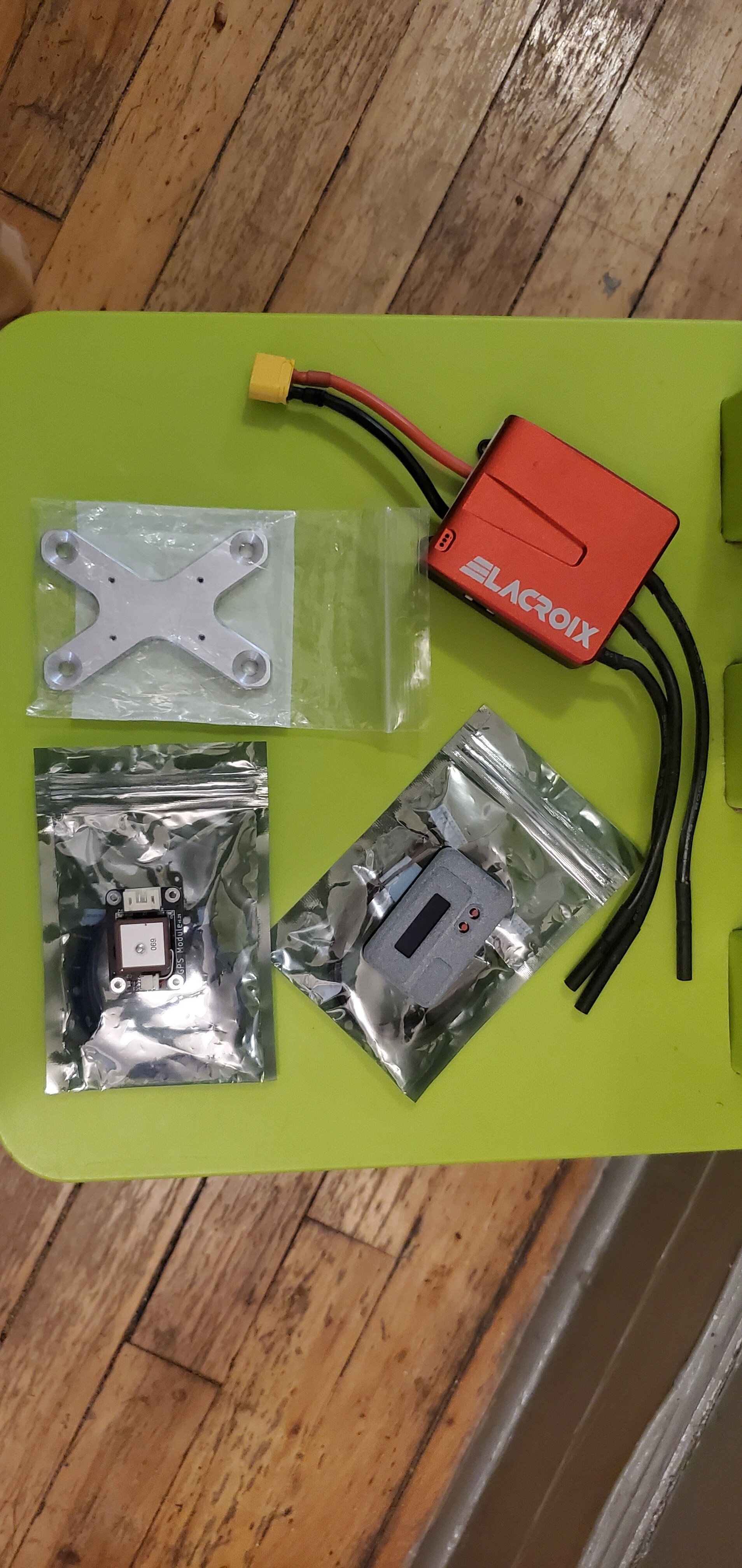

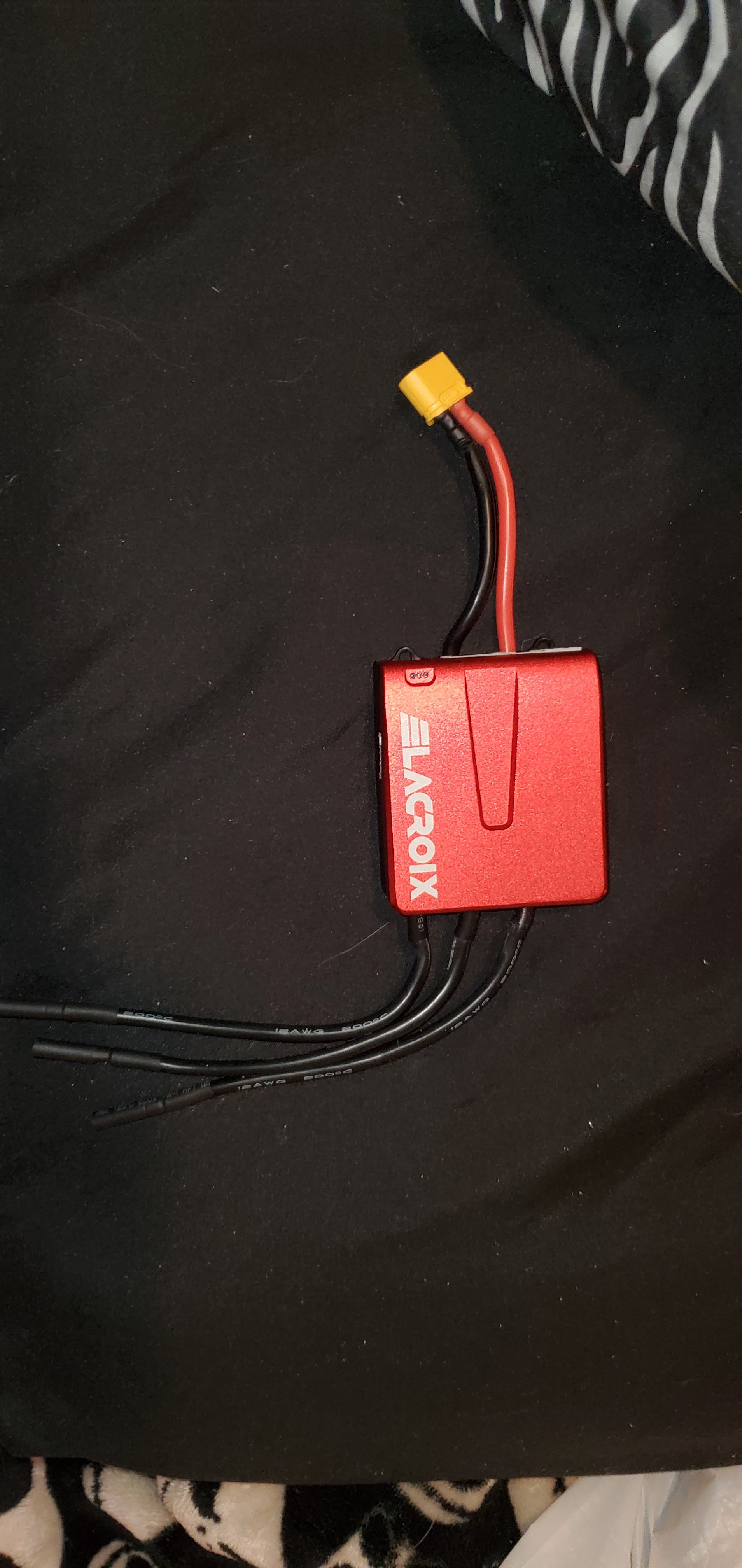

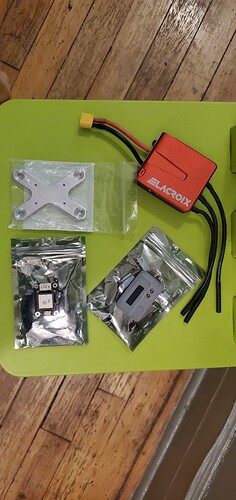

Show and Tell me what you got
Edit: things I can offer

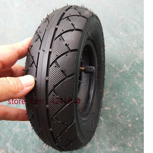

These work?
And I would still rather someone has something to trade for my stormcore. I can sweeten the deal with a robogotchi/GPS/xthingy :hot_face:
Yep. Those look good.

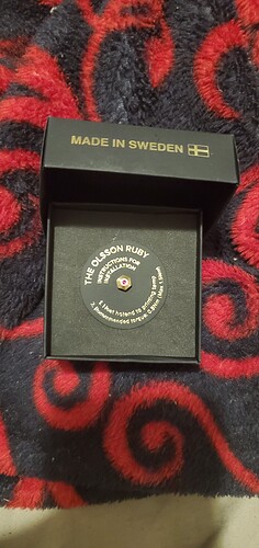

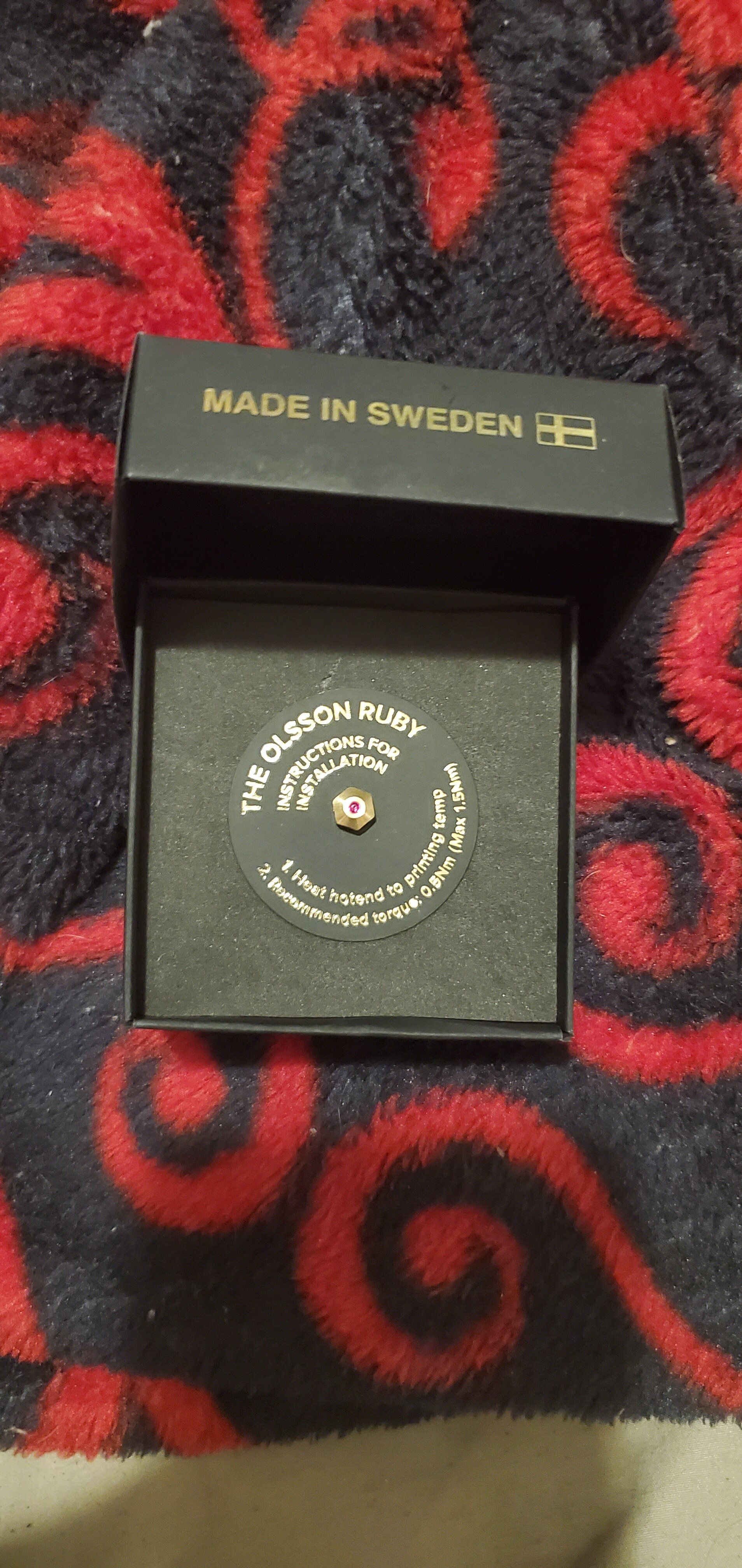

Also I edited my op. I have a feeling you might like the last pic :thinking:

I have some 10” tires :eyes::eyes:
I do too. They bulge out too much to be viable on my Lonestar
Heh…I might have those same ones :laughing: bought just to test out. They are quite massive. I have some hubs coming this week to fit them, will see how I like it…I fully expect to hate them lol
