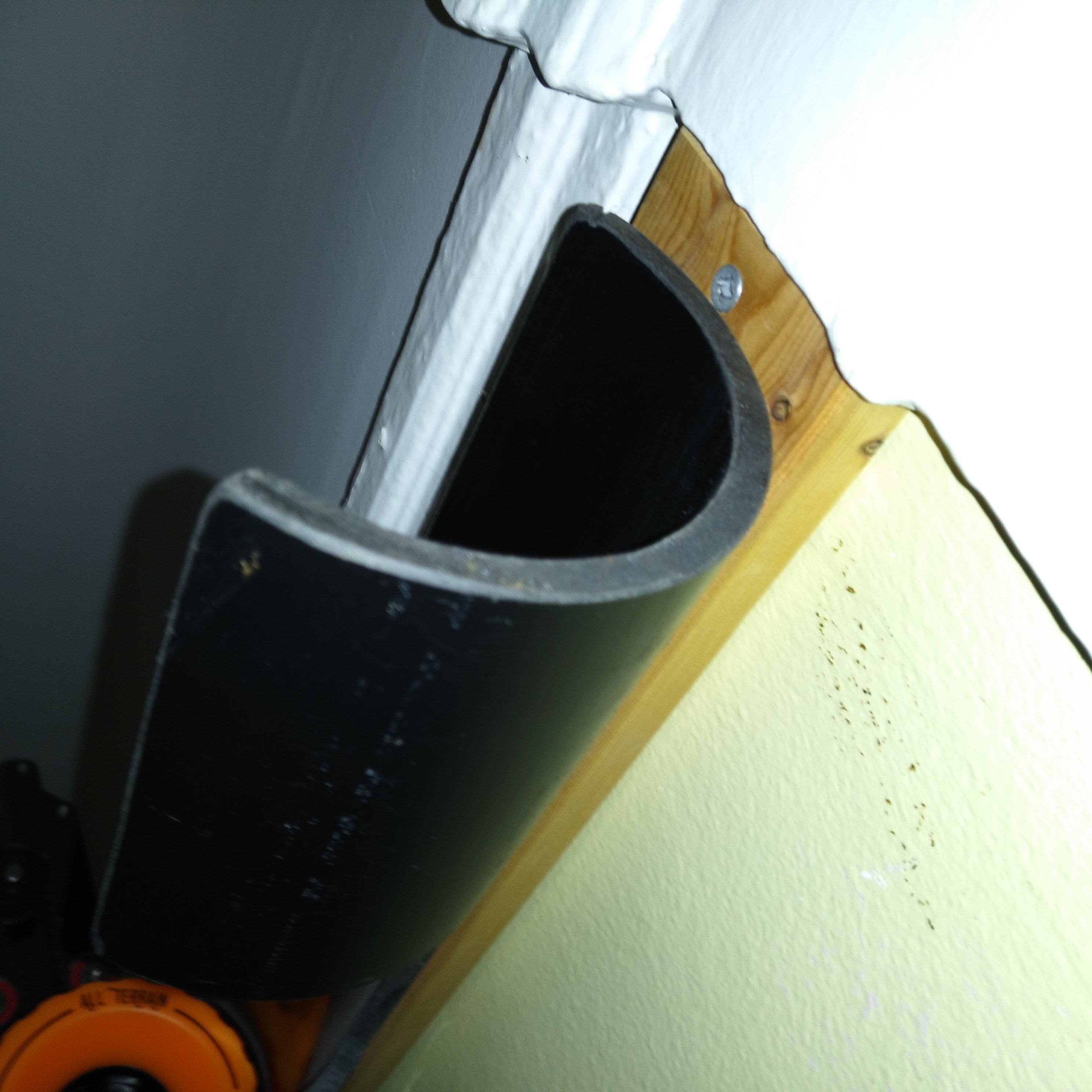

I made mine a while ago with 4" inch (10 cms) PVC tubing. So obviously these only work for up to a maximum of 100mm wheels.
Just take a 4" inch tube, cut to length (little wider than the maximum width of your trucking system + wheels) same distance from outside wheel to outside wheel; then cut that section vertically in half along the tube; take one halve and cut a square mid section to half the distance of the halve so the the truck, kingpin, and bushings fit hanging on the wall, only the wheels will sit over the external sections of the halve; finally drill holes so you can bolt the halve against a supporting 2" x 1" thick wooden beam which will be drilled and bolted against the wall.
For larger 110mm, 120mm or the future 130mm TB wheels go find 6" inch (152mm) PVC tubing instead and you’ll do exactly the same thing. It will work just fine for the larger diameter wheels up to 150mm.
These will be qualified to receive not only the future TB 130mm but 125mm Gummies, 120mm iWonder wheels or any 150mm (6" inch) pneumatic tires.
