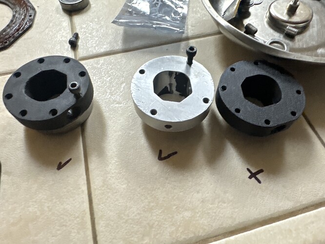

Omg, mine were stuck.
Videoshop_2024-10-02_19-54-05-820
So the ABS test was real thin. The nylon carbon fiber was pretty thick, but not 100%.
The fit on the nylon was terrible. I got one to fit after taking forever to get the drive disassembled. Bearing sit concentric…. Now.
Videoshop_2024-10-02_19-59-15-835
No room for threaded insert. Let me tinker. I’ll mail something that isn’t guaranteed emergency visit tomorrow or next day. Saw the msg.
I’m guessing your dealing with the shrinkage of nylon
30% glass filled nylon: Shrinks by 0.3% in the flow direction and 1.0% in the cross flow direction
