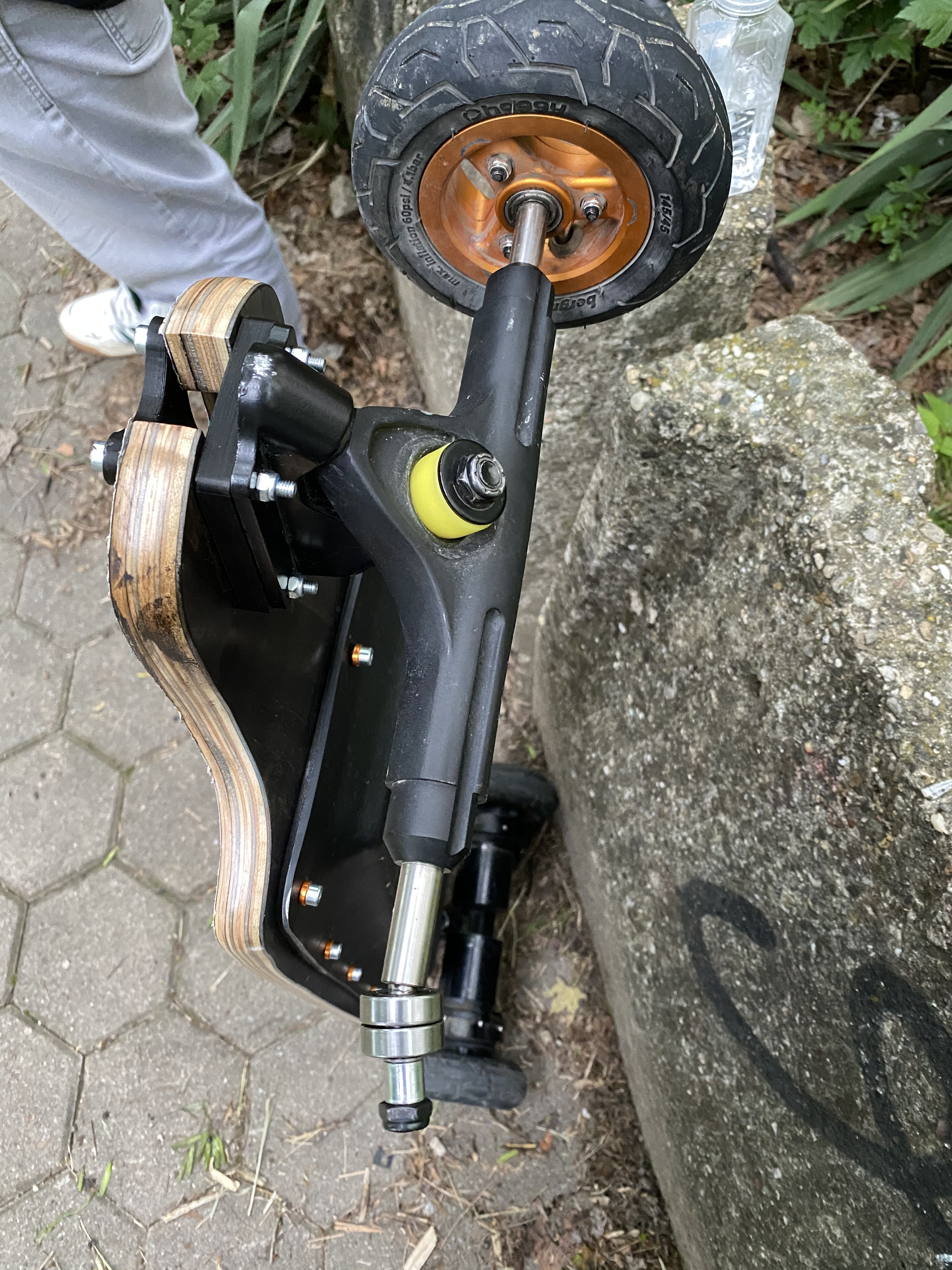

[WTB] Axles for Haggy Kahua 270mm hangers. Lathe work possible.

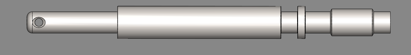

I got this
hagxle .STEP (1.9 MB)

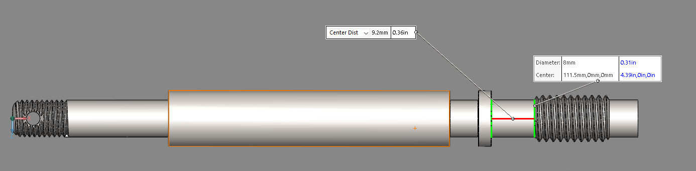

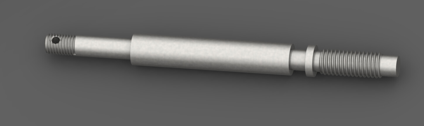

I can simplify the design without threads then cut the threads myself. I got a die.
oh I probably could not cut that large thread with the die completely…
Would need more clearance then I could.

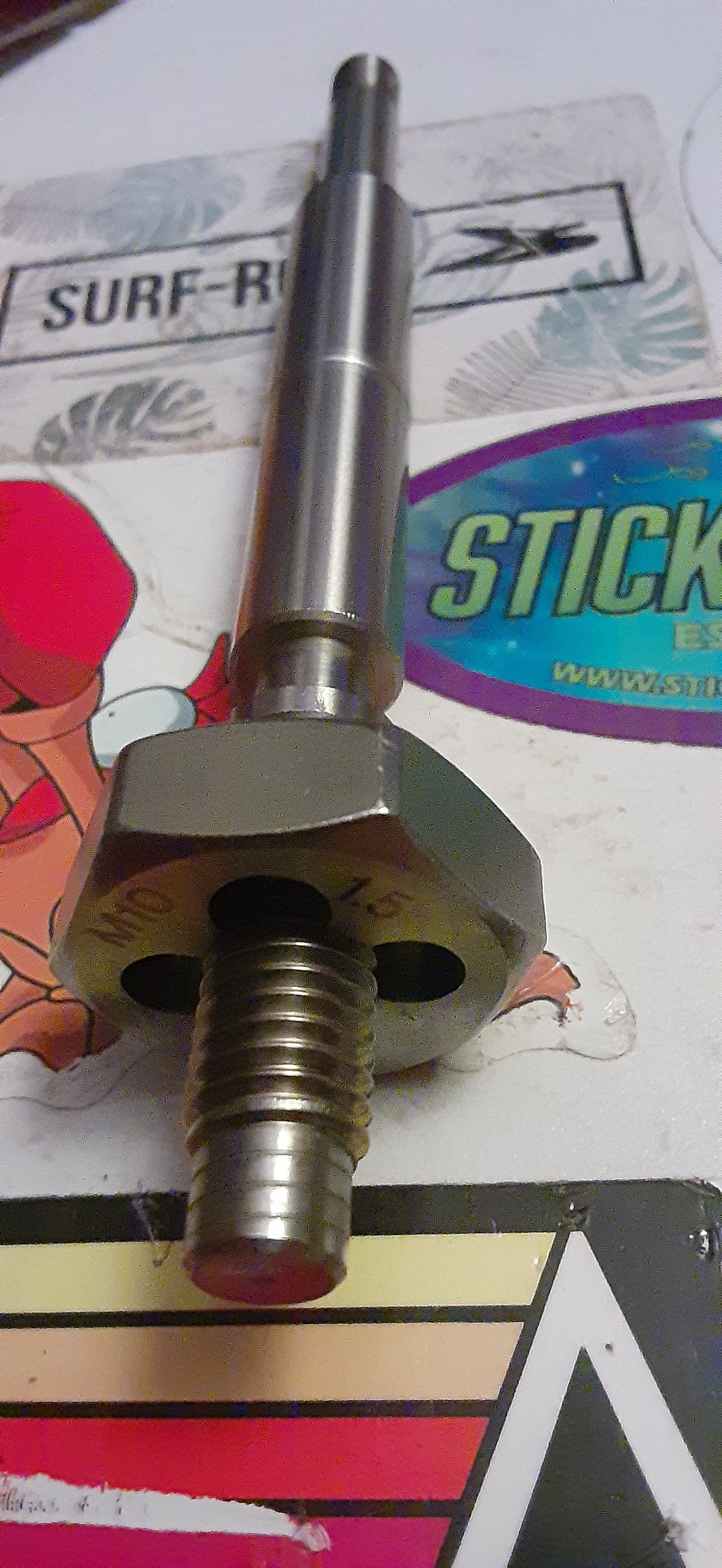

17-4 PH SS, new threads, die, :-1:
Savages work is spot on perfect man. Do it.
The M10 die is 9mm long so this should be enough clearance maybe
@Fosterqc, I could make those for you maybe next week, as I am running a similar job on the lathe then. (Same tools) The job I’m gonna be running is not Esk8 related but using 4140 steel, and I have extra, so material cost wouldn’t need to be factored. I prefer 17-4 SS for axels, but 4140 would work as well.

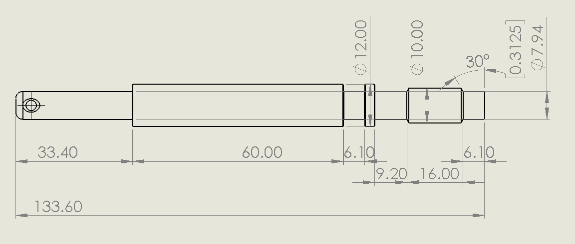

oops forgot to make the drawing, will do today
ok this drawing looks OK ish
I don’t think I need that hole in the end although it would help me hold the axle well while threading it.
Few things I don’t know is exactly the prep cuts needed for the 5/16-24… same 30deg chamfer as the m10 I bet.
Hagxle.SLDDRW (44.9 KB)
