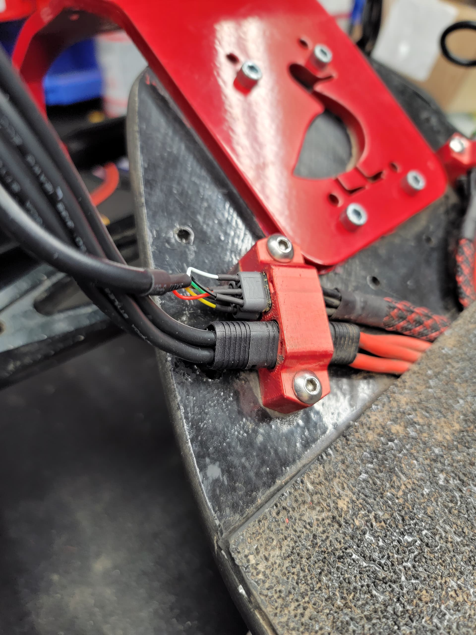

This panel mount phase/sensor wire implementation worked out really well, surprisingly. Never had an issue, and the ziptie slots kept everything held together tightly over several hundred miles.

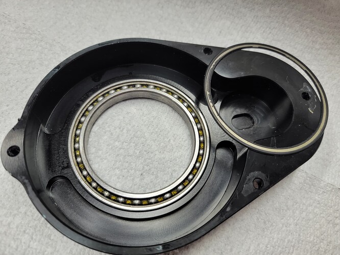

Got the case all cleaned out, and I noticed that the metal shavings must have got inside the case bearing and now it’s completely fucked. I pressed it out and tryed to clean it up to repack it with grease, but the races are pitted to shit, the balls are crunchy, and the shields are shredded (I can see daylight through them). So I’m getting new bearings, which means this is now a two day job :confused:
Out with the old…
… in with the new!

What in the world are those super small MR60 looking connectors? You used to be using GX12-6 connectors before. These look way easier to solder to! :open_mouth:
Also the zip-tie solution is pretty smart, albeit non-renewable. I wonder how I could integrate something like that for a water-proof enclosure solution… :thinking:
MR30 :grin:
GX connectors are trash, I’ll never use them again
Why? Mine have been fine for a year of riding. It’s really dry here thou xD
They are a super low quality connector in pretty much every single way. I’ve broken them and melted them and overheated them and plugged them in wrong and and and

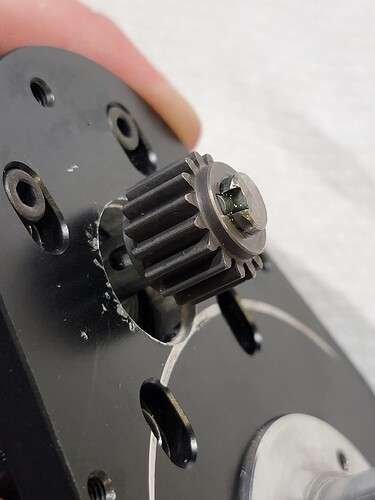

Those straight gears are looking hot. I’ve been running the helical BN on Hypertruck for a few months now, been loving the feels. Though a few days ago I got hit with this.
What probably happened was my shaft key fell out and drilled a hole right through my cover while riding. Definitely would recommend using some shaft collars, @haven can let you know more.
Would be nice if the gears has an integrated shaft collar to keep the pinion from flying out. Then again, the pinion being able to move at all will cause impact stress on it and deform it eventually :grimacing:
Maybe grub screws or circlip can be good. Though BN recommended some shaft collars to keep it moving outward. I don’t know about inward though.
Inward is not necessary at least if you get his fs motors, cuz the gears sit against the step in the shaft now, he updated the gear design

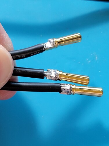

Third, while the 4mm bullets used are the high quality Amass ones (vs the low quality spring-cage style) the solder joints could be better. Especially since the wire is such coarse strands, I would have expected the technician who soldered these to have wetted out the solder better.
